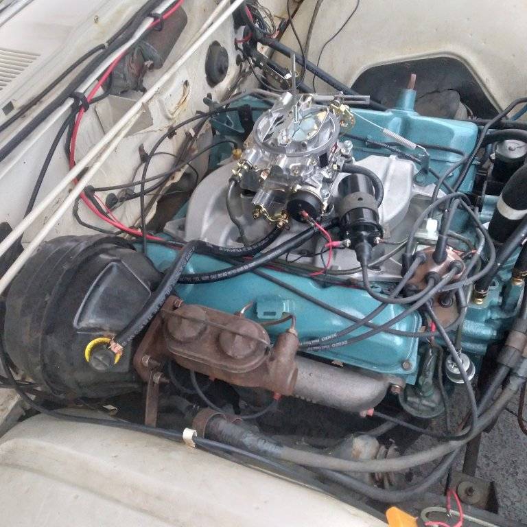

Thx big BIG Br'er Edbods! I'm looking for another intake. Not this year, but a little later. If/when this 1405 I'm running develops need for some work, I'm apt to upgrade to the 1905. I can attest to the fact that a decent 4 bbl carb certainly get's no worse mileage than a 2 barrel, even in town. Special gratitude for the intake tip. That Y& 8008 has runner dimensions like the Perf RPM? I see that the original Performer sure resembles the late 70s T-quad intakes, and 'Brock claims its pretty much just a stock intake replacement. Whatever I buy needs to be optimized for traffic light hopping....
That's a PRETTY engine compartment you got!
Hehe thanks. I need to take a more recent pic of it though, with the freshly replaced brake lines, master cylinder and everything engine-wise buttoned back up, I have to admit it looks pretty nice now, definitely nicer than that pic.
