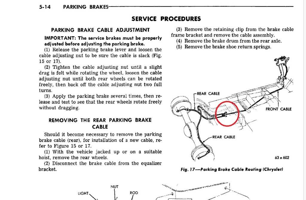

Is there not an adjuster under the back seat floor on the drivers side where the two cables join the one cable that goes forward to the parking brake pedal?

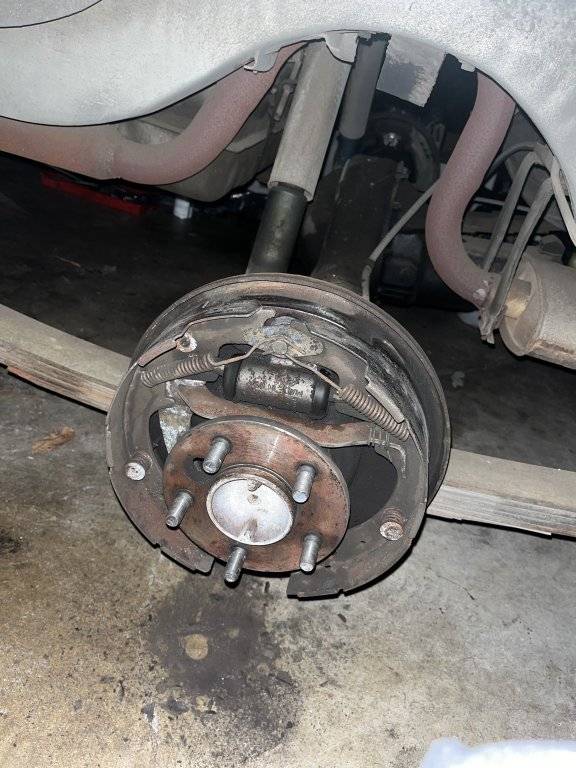

Had some trouble with the passenger side e-brake cable, it does not have enough slack. It causes the shoes to push out a little so I cant get the drum on.
Adjuster thing is all the way in, e-brake disengaged and the e-brake cable slack is fine on the driver side.
Anyone else have this issue? Is there a way to adjust the slack on the e-brake cable?
The adjuster is circled in red in this pic from a FSM
There's a nut on the end of the front cable.
That said, looking at the passenger side shoes, I wonder if the cable is stuck. Not uncommon at all and usually the best way to fix is just replace it.

What do you mean by stuck? I installed it properly, its not twisted up or at a weird angle.
Nice!!
The inner cable is stuck in the jacket and won't move. It happens when they get a bit rusty, often from non-use.
Looking at the picture, with the shoes falling off on the passenger side, and the e-brake lever in that position, it occurs to me that the cable isn't releasing and it's been driven a lot with the cable not releasing.
I see, well I hope that's not the case but well have to see.
For now, we have the shoes and drum installed without e-brake cable on the passenger side just so the car can be moved around the garage.
Big john, but you are probably right when I think about it. When I had the cable installed, the parking brake arm (not sure exactly what its called) seemed as if it was in the same position it would be if the e-brake pedal was pressed.

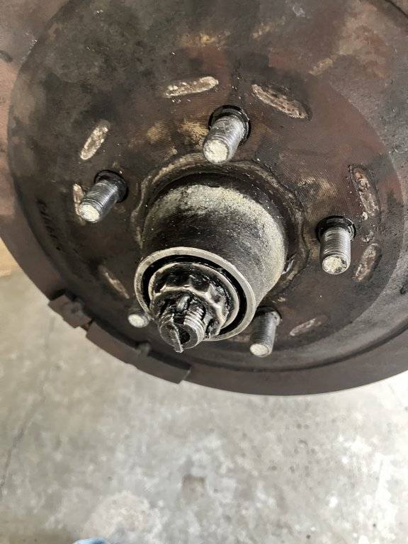

@413 @commando1
you're both referring to this nut? just this guy and the whole hub and drum comes off?
btw won't be working on this till Sunday prob just want to have a plan before i get to it

@413 @commando1
That's the one! Pull the cotter pin, then the little sheet metal castle lock thingy, then unscrew the nut. Remove the washer and outer bearing and the drum is now loose. If it hangs up, you may have to back off the adjuster a little.
I suggest a new inner seal and cleaning and repacking both bearings. To assemble takes a little finesse to adjust, but it's just a matter of snugging it and then backing off the lock just a touch. Read the service manual for a much better description of the procedure.
