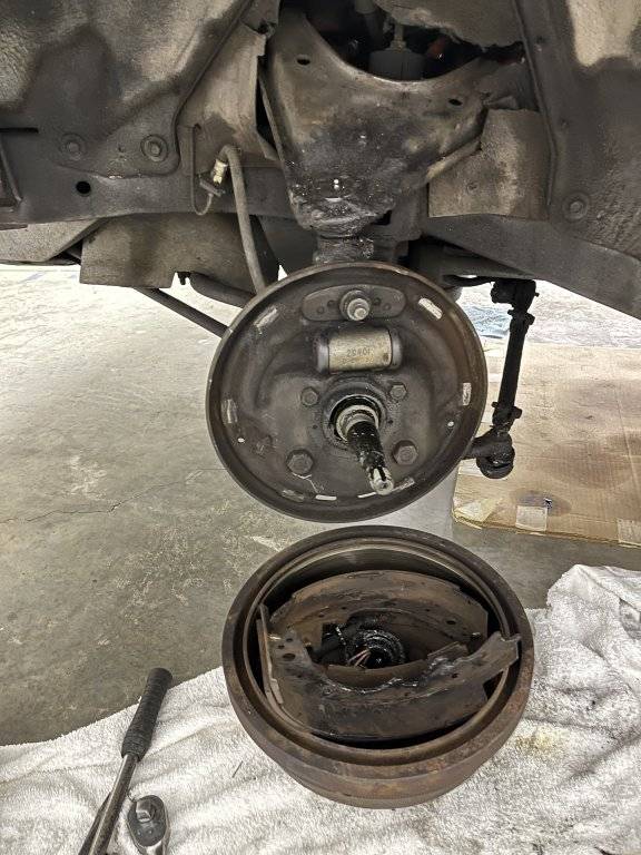

Ok boys here it is thanks for the help.
I'll be taking the back part off tomorrow, its late don't want to piss off the neighbors and seems to me those 4 bolts need to be hammered out.

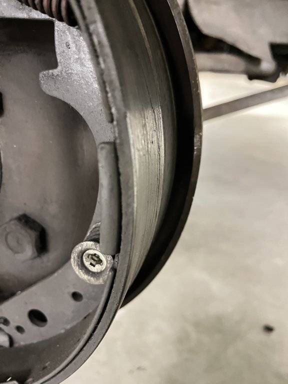

Shoes and drums were cracked, wavy and had deep grooves which explains the braking performance.

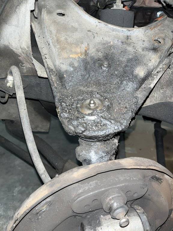

Don't even know what I'm looking at here but it's disgusting so thought I'd post it for you all to look at.
My guess, crystalized oils and dirt maybe.
Nothing that a little over greasing or blown out ball joint seals over the years. Plus with the wheels on its a little difficult to get straight on the grease zero. Half of what you pump sits there collecting dirt and road grime.

STOP and THINK before you do that!
The two lower bolts that hold the backing plates to the spindle ALSO hold the lower ball joint to the spindle. The lower ball joint is attached to the lower control arm which is sprung by the torsion bar.
The ONLY ways that you can take this apart are to either release the torsion bar tension OR the simple way is to place a jack stand under the lower control arm so it supports the weight of the car.
What I'm trying to do here is not get you KILLED or hurt when you knock the lower bolts out and the lower control arm releases VIOLENTLY from the torsion bar tension.
Better yet... Why do you need to remove the backing plate?? It doesn't look like you are doing some 100 point resto... Just replacing front brakes. That backing plate doesn't need to come off.

I discovered the backing plate being in the circuit for keeping the spindle and lower arm when I replaced the wheel cylinder. I just loosened the 2 lower bolts enough to tilt the backing plate and remove and install the wheel cylinder.
Agreed with @Big_John - don’t remove it, without preparing accordingly!!!
If the wheel cylinder bolts are hard to get to then grind down a wrench so it fits in there. You must remove the hose from the cylinder first To remove the wheel cylinder.
Taking off the backing plate is not something to do for the fun of it, leave it alone.

So it seems like I want to support the control arm while knocking out those bolts? I don't know if it matters but I have the whole front lifted, the front of the car is on jack stands.
1. Put a jack under the control arm
2. Hold on to the backing plate while lightly hammering the bolts out

Yes, a jack under the control arm will work. What you want is not having that lower control arm spring down from the spring action of the torsion bar. I can't stress enough that done wrong, you can get hurt.
The bolt will pretty much slide out once the tension is off.

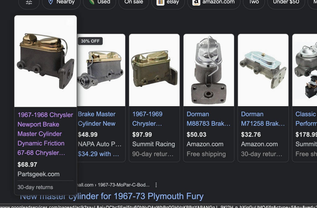

If you have a single circuit master cylinder, I recommend swapping that out to a '67 or newer master as soon as you can.
Nope too late to return it. But i'll consider just buying new drum brake parts then swaping the master in the future instead.
