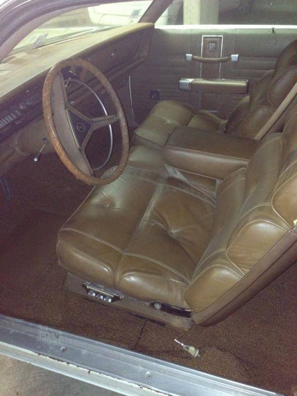

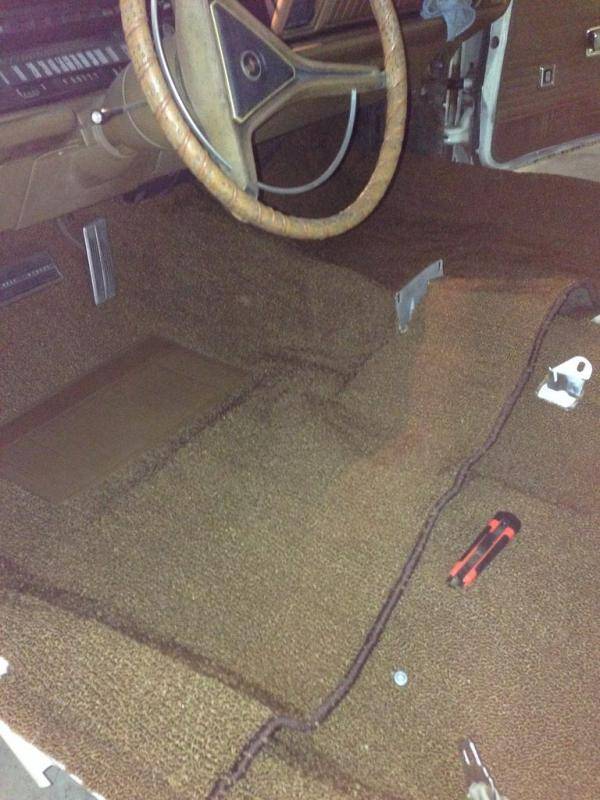

some work I did on the Hurst :
carpet replacment.

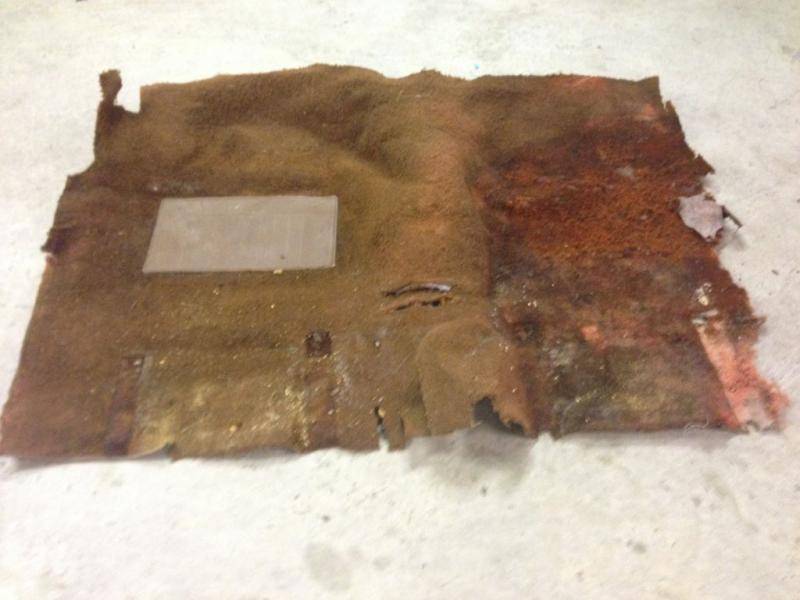

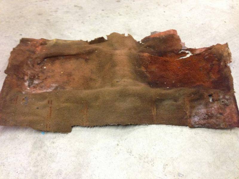

the old carpet :
As you can see, enough is enough.
It took me a lot of time to choose the right color. But Dante from dante's parts helped me.
I choose 521 med saddle and it is a perfect match.

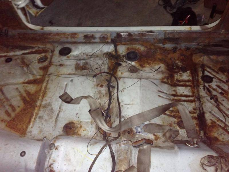

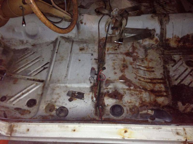

some light rust on the floor but nothing really bad i am lucky this time.
I removed the rust as I could but I didn't paint the whole floors, just rusted areas. Just because I did not had the perfect paint color ( just a common white anti rust paint ) so it will have to be redone later.

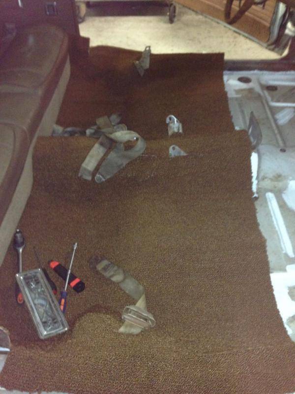

the new one :
it fits perfectly
the hardest thing to do are the seatbelts.

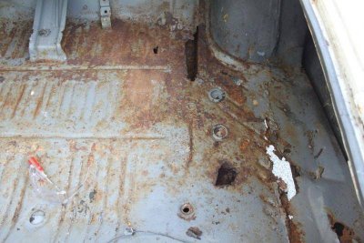

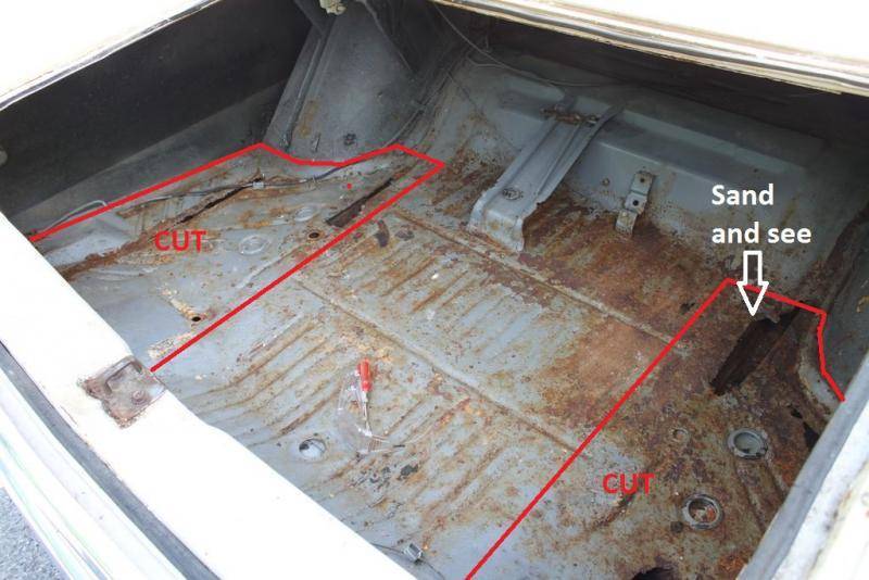

Next work will be the the trunk floor.
i will keep the center section : I removed the gas tank and I discovered that it is perfect under it, with original paint. so I will only cut left and right section that are rotten. i will sand the rusted frame to see if I can repair it. A friend will help me, he is a metal worker ( but not in cars !! ) and has a folding machine, everything to cut and weld.
basically the plan is that :
I think I will buy the extentions from this site :
http://www.c2cfabrication.com/store/1965-71-chrysler-300-trunk-extension-pair/
but the whole trunk floor does not appear to be a perfect match...
i will just have to find the part between the extension and the center section.
what do you think ?
