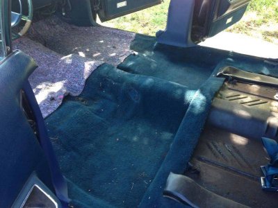

I started last week to change my old carpet...
1st thing to do : take the car out and open the doors to remove the seats and bench.
The seats are so heavy... I hurt my back, for few days :/

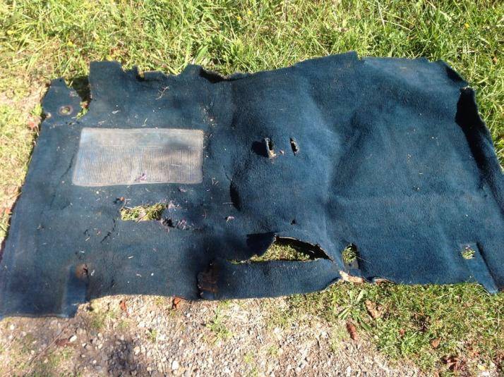

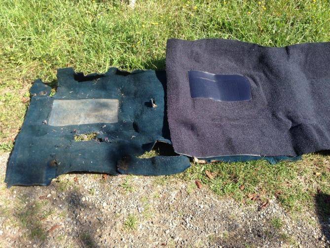

take the old carpet out. it was time.
when I checked the color on stockinteriors I ordered the wrong color but it is not a big deal.
it will be perfect too. I took midnight blue instead of some other blue.
I have redone the front 2 years ago. I thought I done the rear.
obviously not. :D

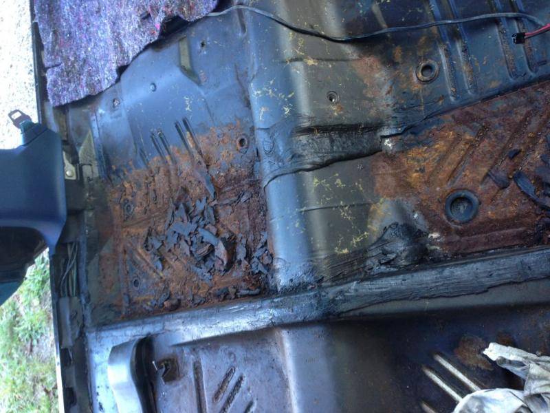

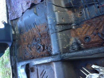

this little joke make me lost a week, I do not have the tools on site and I do not want to put a new carpet on something like this. It is WAY better than it looks on this picture. only surface rust and old steel cover.

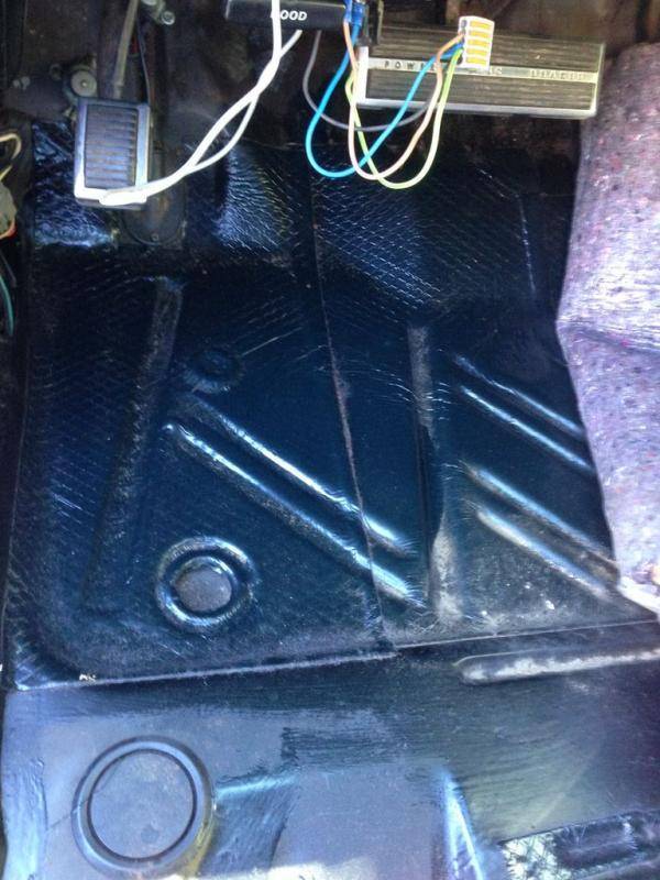

yesterday I took out the rust, put treatment ( rustol ) and I will apply tar sheets like it was.
I did it on the front and it still looks like new
( yes yo ucan see on this pic my personnel wired ignition switch. I replaced it yesterday too( the car would not start and it was it that ) .

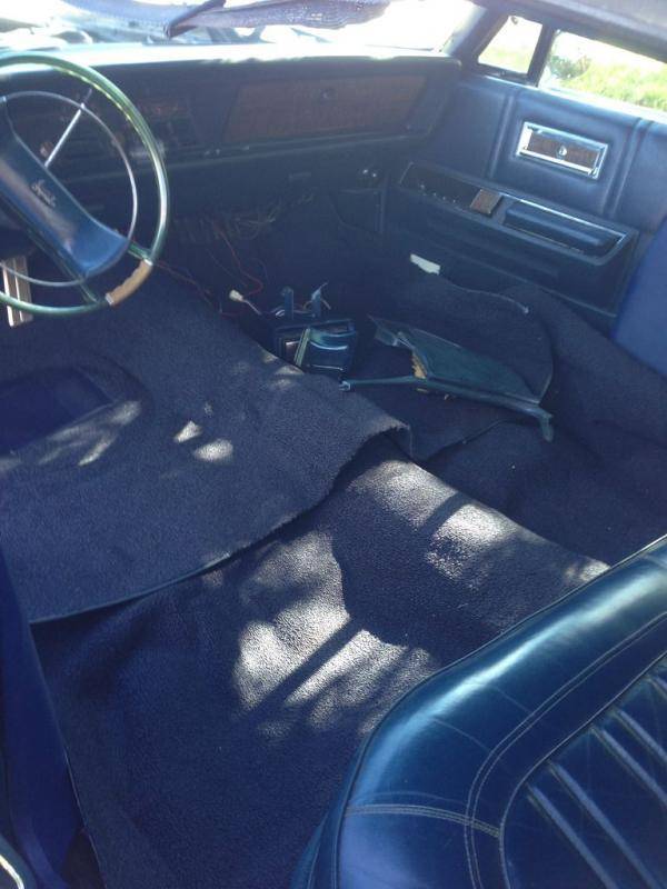

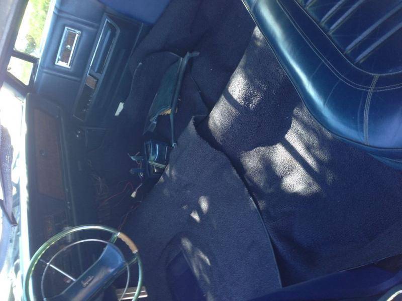

rapid preview of final work. I just put the carpet in the car to see what it will render. I will probably finish it today.
