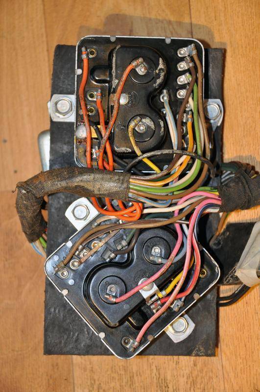

I bought this on day : the 2 relays attached to the original PCB card. that was, up to me, the original assembly. Chrysler wanted to show off a bit with a little of electronic.
You can see all the wires, the relays, and the famous PCB card in the red hard wax.
on the backside, another relay :

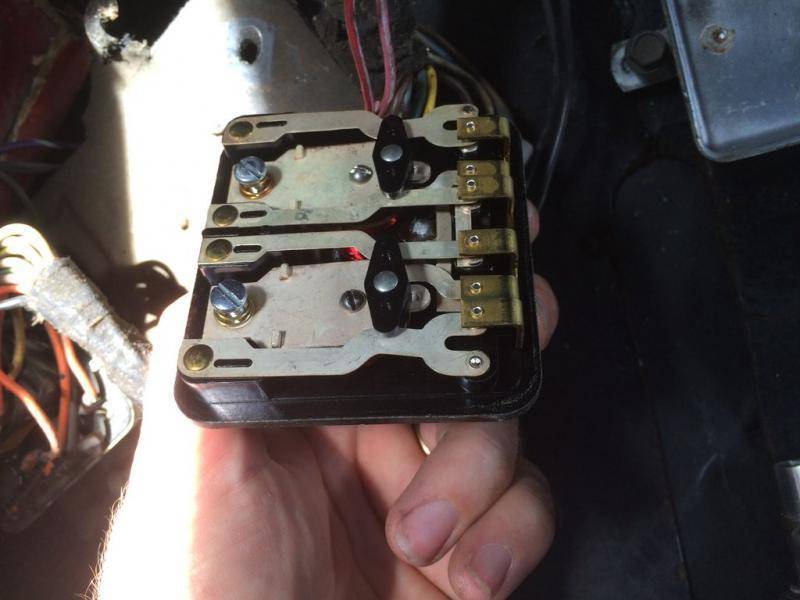

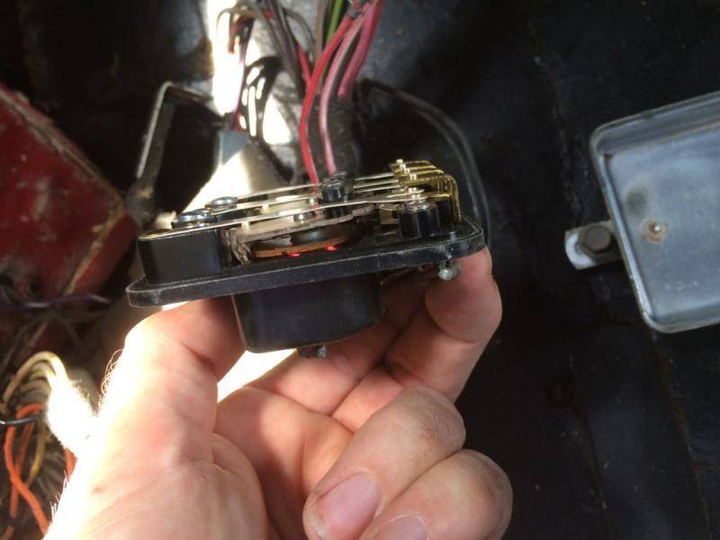

i decided to remove one of them ( they are in bad shape ) to see what is inside :
it is a classic relay, seems in good shape inside.

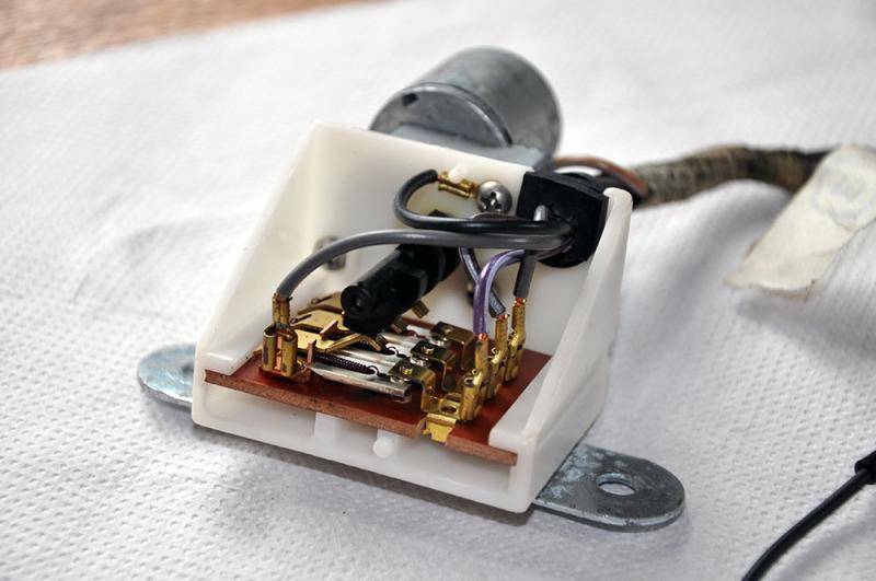

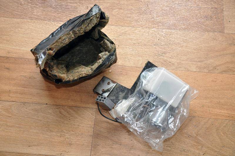

So, now, I think that this first assembly was defective and they changed the PCB card by another system.

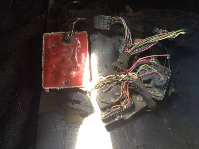

The one I had on my car :
It looks like a Mercury cougar system.
It was originaly wrapped in a thermal envelope that prevent condensation I guess ( for the contacts ).
Whatr makes me thinbk that it is another version ot the system is that it is not a aftermarket thing. It was sold by chrysler.
and inside, the thing :
when the light do not flash this is a bad contact on the points.

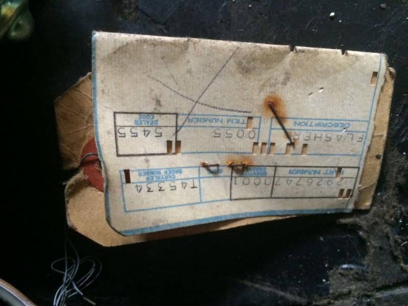

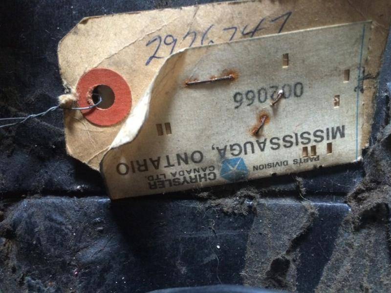

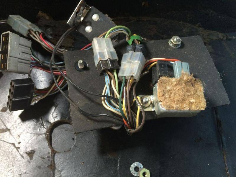

Thanks for the missing part number,it`s not in the parts manual btw but it is now! These must be a warranty replacement,I have three of the ones in the red wax and not a one works. Julian,you might want to find one of these,or make your own.They look so simple compared to that box that you opened up in your thread.:sSig_thanks:
I have the first box on my car. The "original" box. I don't know if it is broken or not. I'll check that when I rework the system!
If it is not working anymore, I will exchange it with a modern electrical system!

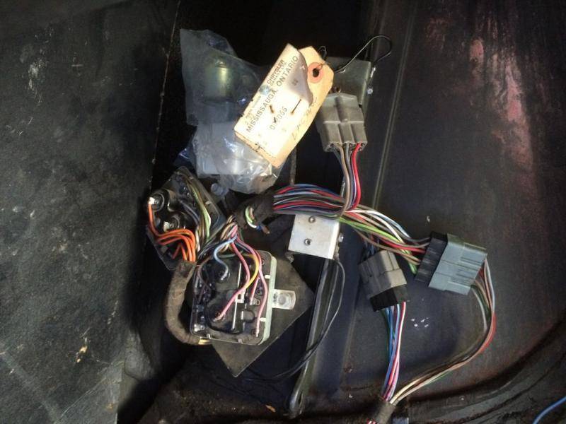

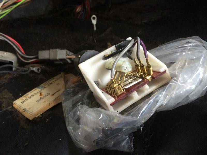

I checked my Sequential turn signal motor and relais today and I already have the "better" unit.
And it's working as it should!

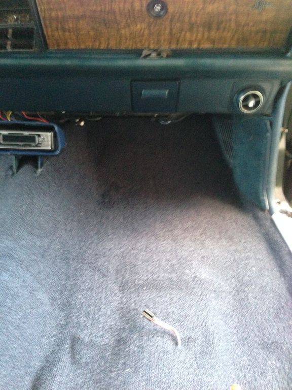

i did some quick check up today and I have some questions about my imperial.
1) the clock was rebuild 1 or 2 year ago. it works when I do something with the front button. but nothing when the battery is on.
i suppose I only have to check if I have 12v at the wire at the back of the clock ?
2) it is quite odd, but I've never noticed that ( or I totally forgot about it ! :p )
- what is the wheel next to the map light ? what does it does ?
- What is missing next to the vent command ?
3) I do not know if I am the only one on earth to have that, I may have asked before but :
WHY IS MY DASHBOARD ALWAYS STICKY AND GOOEY ? I don't know what to do to clean it.. it always come back.
( yes i removed the radio, it was non working )
