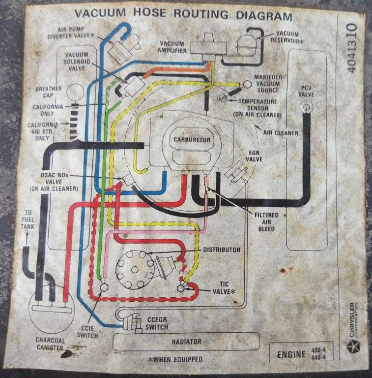

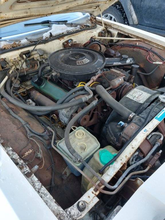

So the idle is the same with the gas cap off. Need to get a piece of hose to check the vent line. The carbon canister should be by the windshield washer and overflow tank right? My vacuum line diagram shows 3 ports like the second carbon canister pictured.

If pulling the cap did not help, the problem is not vacuum in the tank. You are correct, the carbon canister should go next to the overflow tank. I am noticing a police alternator and oil fill tube for the power steering, this a PK series vehicle (police). Filling the tank should not affect the performance of the vehicle if the vent was plugged, the car should run correctly with the fuel cap removed. Check your fuel tank mounting straps and the frame rails next to them to be sure the tank is not sagging because of a loose mount and pinching the fuel line where it comes out of the fuel tank.
The various emission controls on this vehicle are pretty much all missing of unhooked, that makes a performance related diagnosis difficult. Unhooking all that stuff usually messes with the mixture settings for the carb and can also affect timing. Check to see if the EGR valve is still on the intake manifold, it is unhooked, but it could be stuck open which will make the engine run like crap. Next check the basics, plug gap and timing to eliminate tune up issues. Check your fuel filter for rust accumulation, as the filling of the tank could be stirring up rust and plugging the pick up sock on the fuel sending unit. Check these items and report back.
