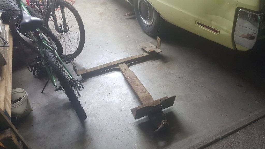

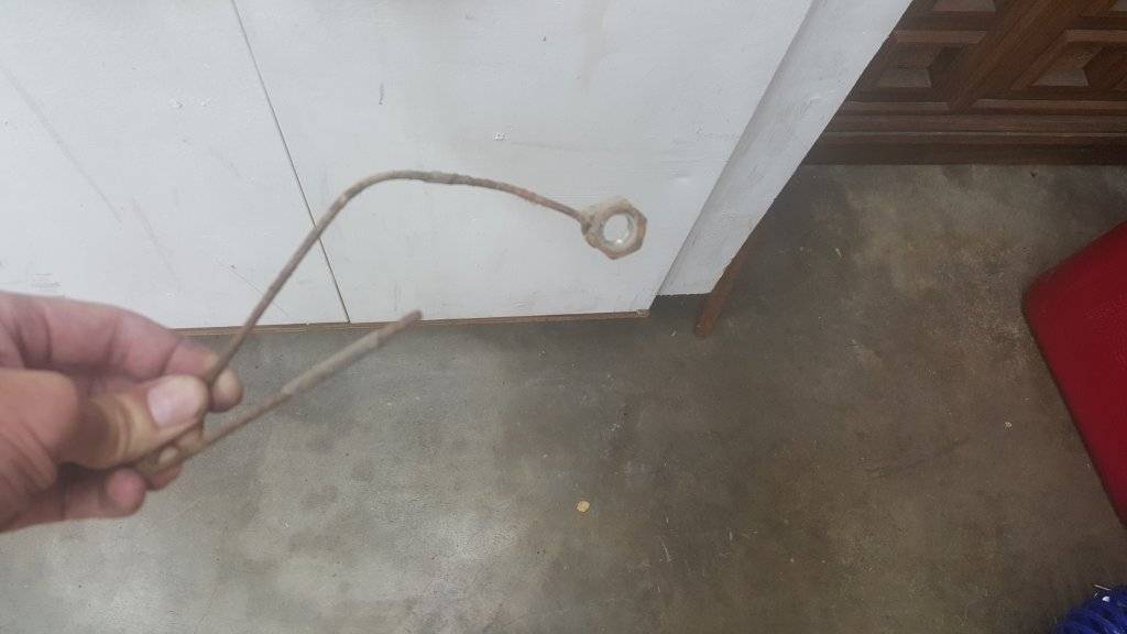

I was finally able to remove the homemade tow bar. The thing is huge. I wondered how they managed to attach bolts to nuts that were inside the frame rails until I pulled a wire out that had a nut welded to it. This car spent some time on a farm and it shows.
View attachment 90708 View attachment 90709
I've seen similar things done by pros to mount trailer hitches. Usually they break the wire off.
I'm glad they left it on because it allowed me to remove it. On the other side, I have a nut loose in the frame rail that I need to figure out how to retrieve.
I didn't know about those. I guess there is a tool for every job.

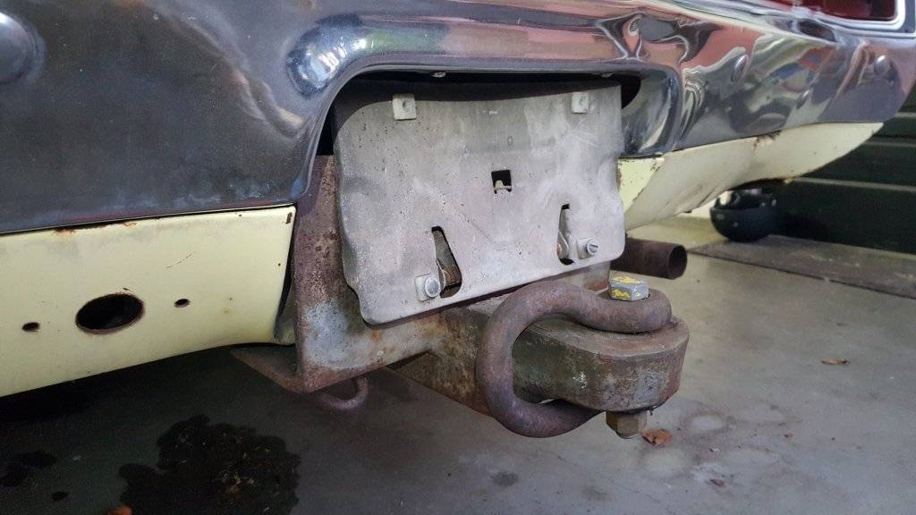

Is this the correct license plate holder for a 1970 Fury (not including the hitch)? Does anyone have a photo of what it should look like behind the plate holder?

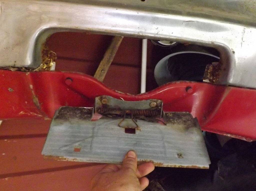

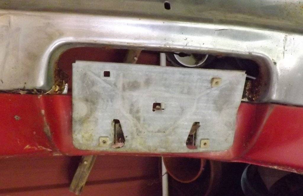

Hey Jeff, I will take a pic today for you that shows what you want to see regarding the number plate holder. Also the steering wheel comes off with a wheel puller, you can buy them at Harbor Freight for like 14 bucks. there are two holes the bolts go in. Once you have the horn button and assy off you will see them.
Thanks Wollfen. What about the horn button itself? I don't see any fasteners. Does it just pry off?
Hey Jeff, I have attached some pics for you, also, the horn pad on your steering wheel has mount screws behind the triangular part in the center, it clicks in place and can be pried out carefully. It should be easy to see what to do after that.

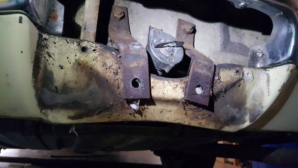

Thank you. Mine has two brackets going from behind that sheet metal to the rear wall of the trunk. The license plate hanger bolts go through both the sheet metal and the brackets. I was trying to figure out if the brackets are original or part of the jury-rigged hitch.
Here is a picture of mine. Are the brackets add-ons?
