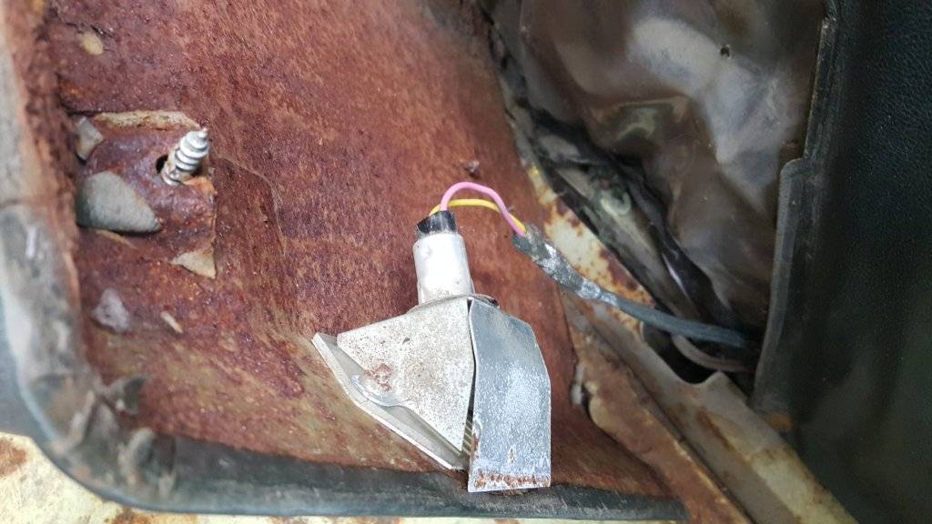

It's amazing how much rust there is on the back of the armrest, compared to behind and below it. It must have been an unpainted surface. I didn't realize there was a light back there. I thought the visible face plate was just a decorate element. Is it supposed to light up when the doors are open?

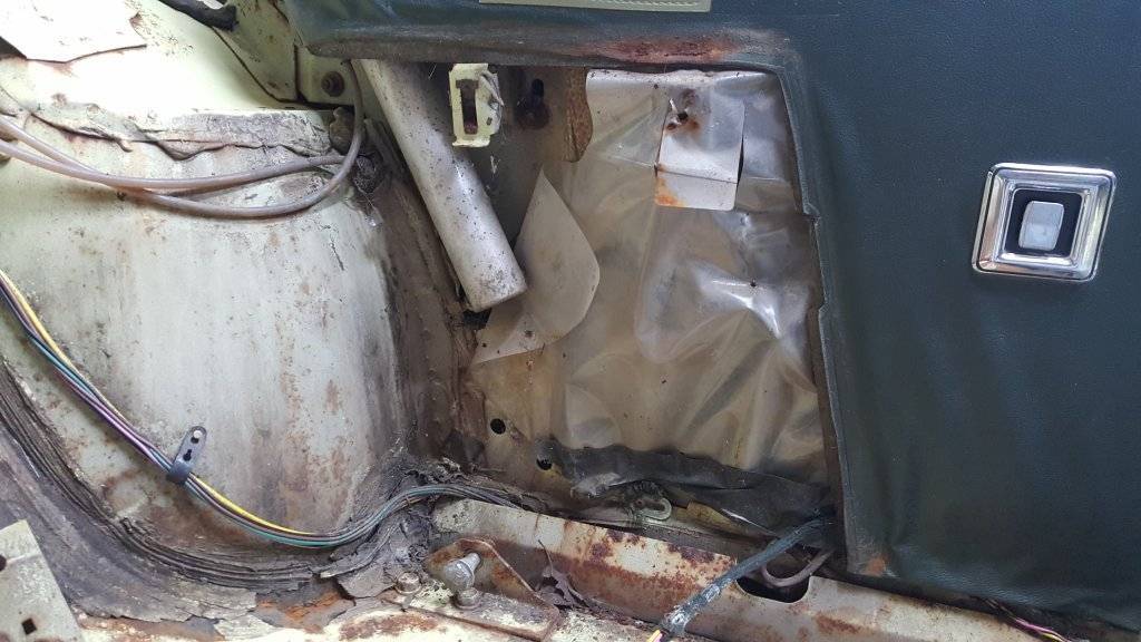

There is a series of metal plates along the sides of the floor, behind which are wire bundles. Are those just affixed to the car with body sealer?
View attachment 94023 View attachment 94024
They are welded at the base but they can be folded out to expose the wires, just be careful not to fold them too far because they are not strong and can break off after a few times of being folded back and forth.
And yes the light goes on when you open the door.
Yep, no paint on the back of the armrest.
BTW, I forgot that there's a screw that doubles as a boot clip on the back of the kick panel that needs to come off. You may have already encountered it...
That light is cool, but what a pain in the butt to replace the bulb.

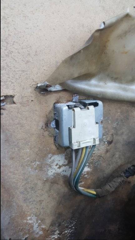

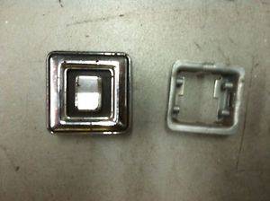

This is the back of the power window switch on the rear kick panel. The white plastic looks like a clamp that is locked shut. Can I unlock it without ruining it? I want to disconnect so I can remove the panel completely.
Also, should the power windows operate fine using just battery power or does the engine need to be running? This one moves up slowly about halfway and then stops using the battery. Thx.

The switch comes out from the front. It clips in. Once you free the switch, the wire harness is just plugged to the back.
I think he is saying you can't pull the white clip off the back until you separate the front of the switch from the housing, which you do from the front. Once separated, the white clip will come off the back. But I'm at work and can't look at it right now.
That is correct.

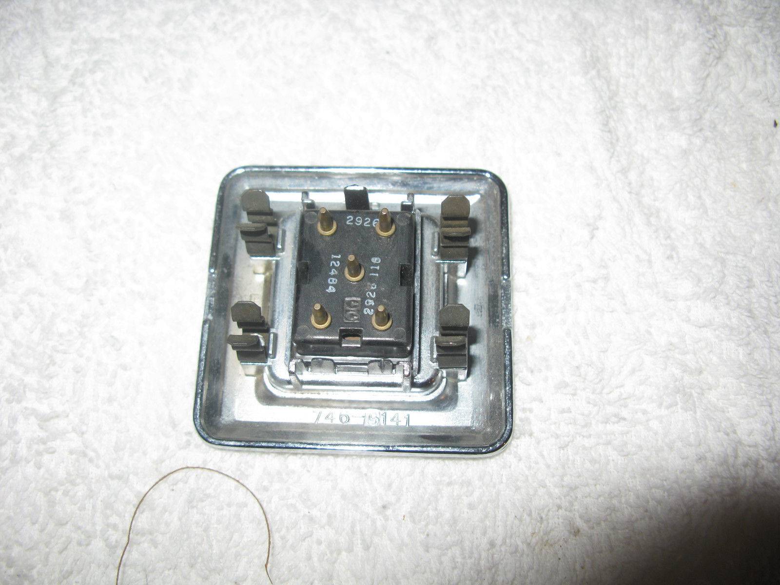

That worked. There was an amazing amount of debris and dirt in the wells on both sides. The "up" side of one of the switches doesn't seem to work. I'm pretty sure it is the switch and not wiring because I swapped the switches from side to side to test. If you separate the black plastic portion of the switch from the metal housing, is there anything back there that can be rehabbed?

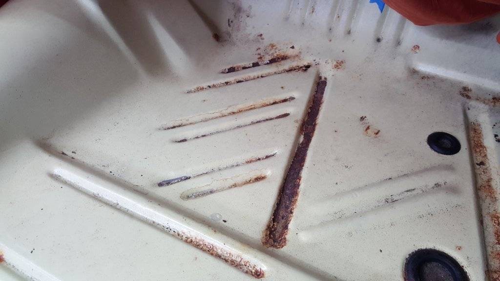

I finally started actual work on the floor. I started with a small section just to test the process: grind out rust, treat with phosphoric acid, primer, paint. The phosphoric acid is on it today. I'll rinse it tonight and decide whether to prime or do more work on it first.

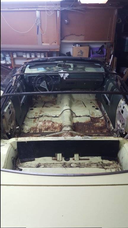

Despite having most of the interior out, there is still a nasty mouse smell under the dash. It seems to emanating from the passenger side. I really hate to tear the dash apart because I am already worried about getting this car back together. Is there a common place up there that mice like to nest in that is easily accessed?
