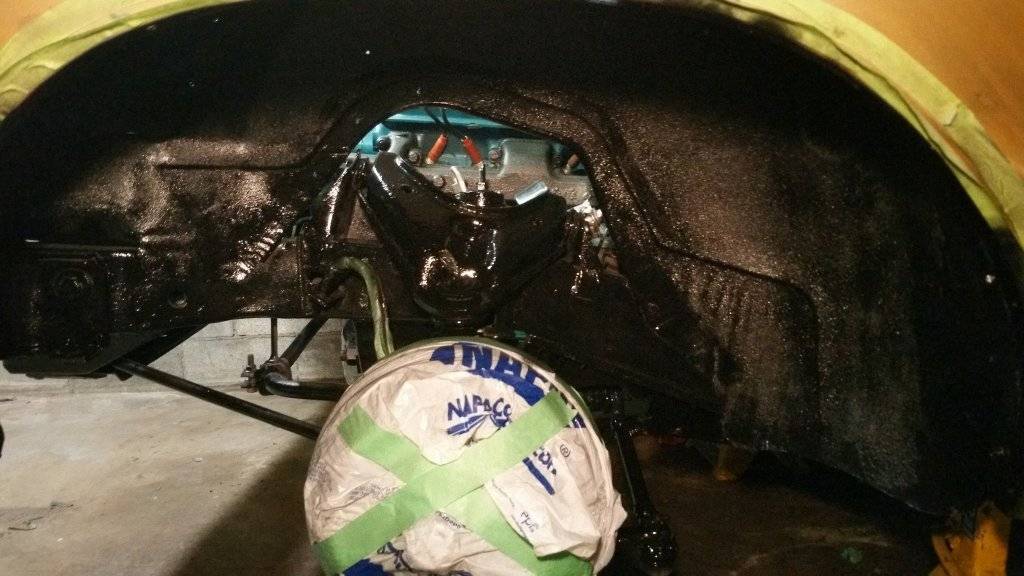

moveing it along.....hit up any serious rust with Metal Blast first..
Rust Bullet Metal Blast - Gallon | Rust Bullet
then l hit it up with Rust Bullet...
Rust Inhibitor and Concrete Coating. Garage Paint Rust Paint for Rust Repair. Stop Rust for Good! | Rust Bullet
and finish it off with the top coat...
Rust Bullet BlackShell protective coating and top coat black finish for the ultimate rust protection. | Rust Bullet
used this stuff on my 91 gmc 8-9 years ago...still like new and still chip free...this stuff rocks and is the best stuff lve come across...anything l put this crap on is gona outlive me...

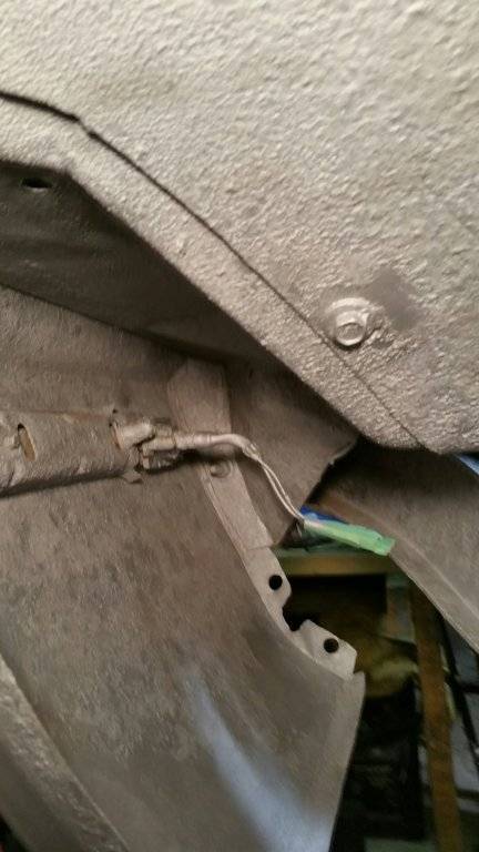

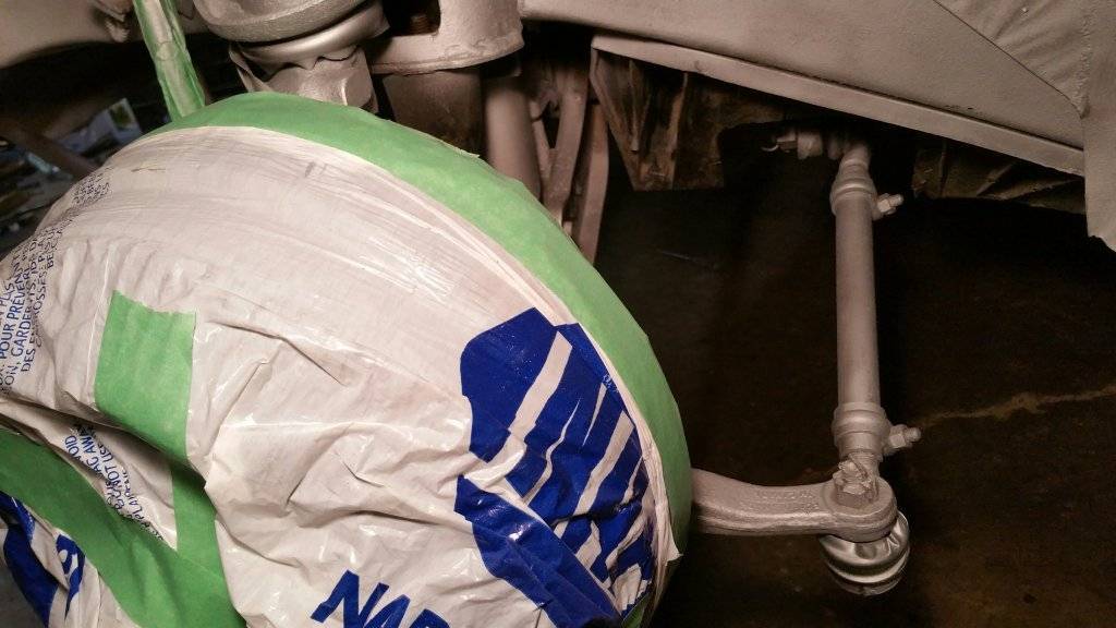

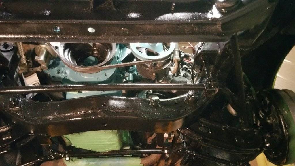

first coats....

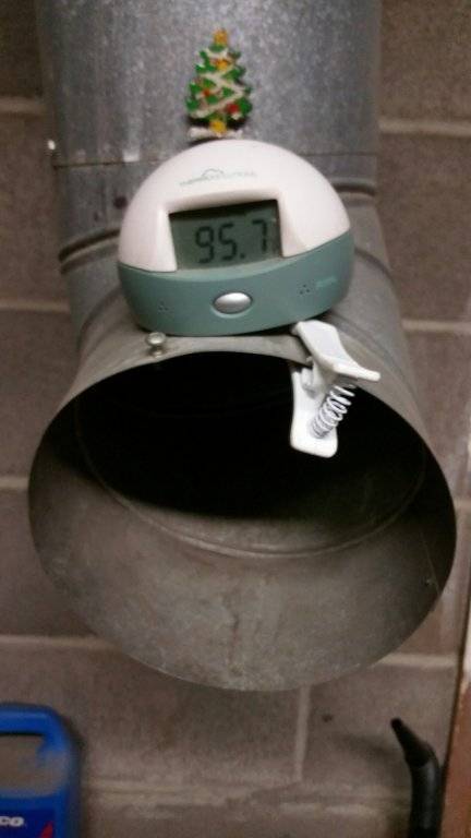

temp shows 95 comein outa the pipe...time it all settles down am showin about 57-58 degrees in the pit...survivable
leaveing the signal lights be till l can round up some replacements..first acorn bolt l touched on them just fell off
PS...most of my vehicles are in good shape..rusted bolts are generaly not a issue for me...on the 70 have run into a few bolts that were basically seized...cpl l fought with but after that put the propane torch to them and am impressed in just how much difference a little heat will make in regards to the rusted and seized lower bolts.
Get yourself a few feet of flexible duct and end it near the front bumper to blow the warm air under the car
its blowing outa there pretty good actually plus l have a mr heater electric fan and heater going down there as well and generally have that directed where lm working,,hopefully it'll warm up by sun to -18 or so...another couple days and the worst of the detailin will be over...then again lm lookin at those inner fenders thinkin they'll drop down fairly easy I'm thinkin

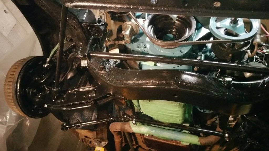

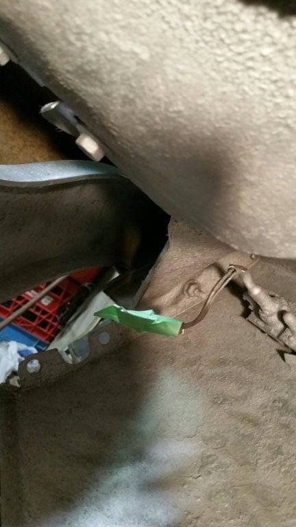

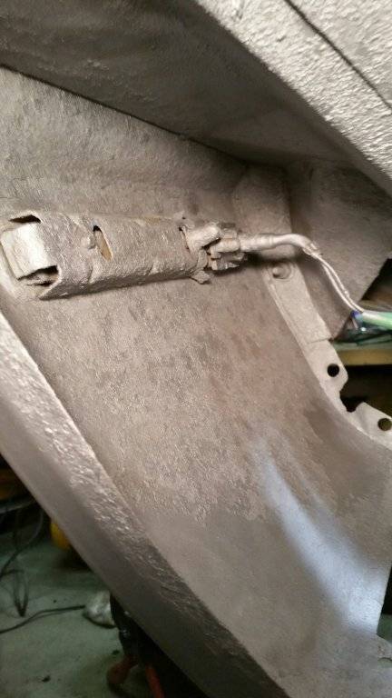

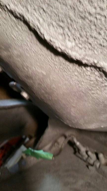

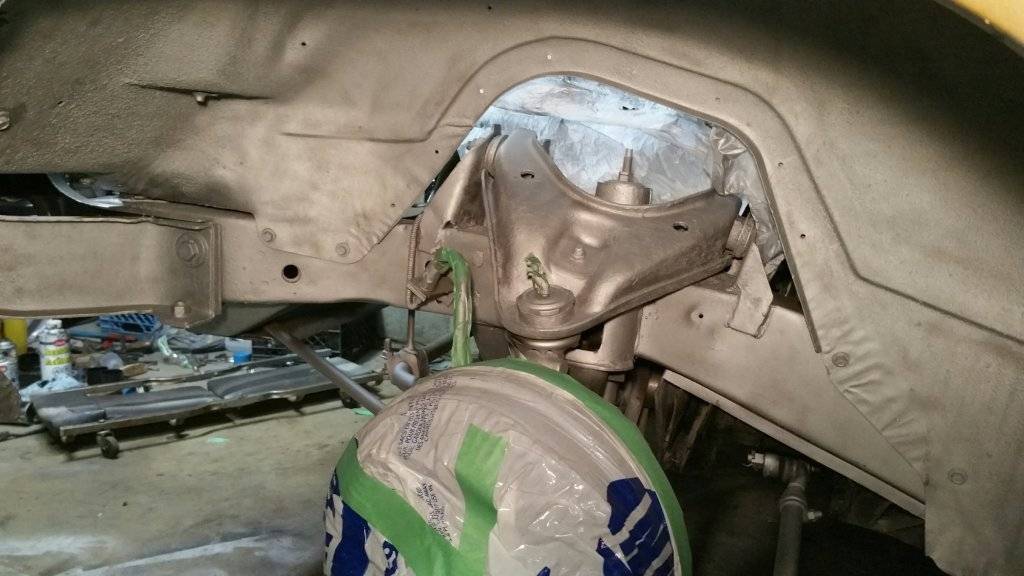

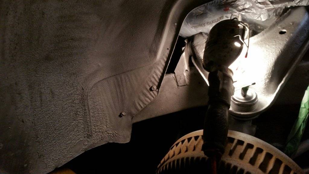

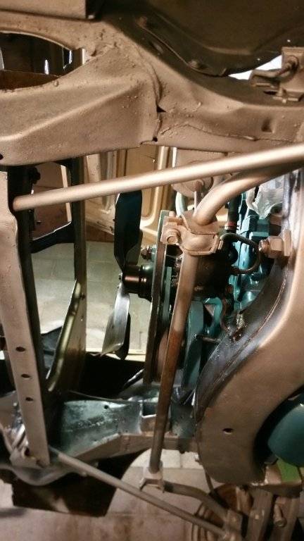

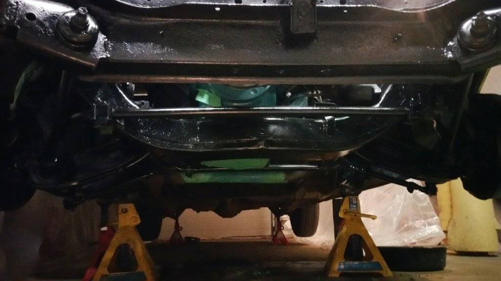

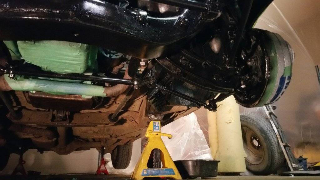

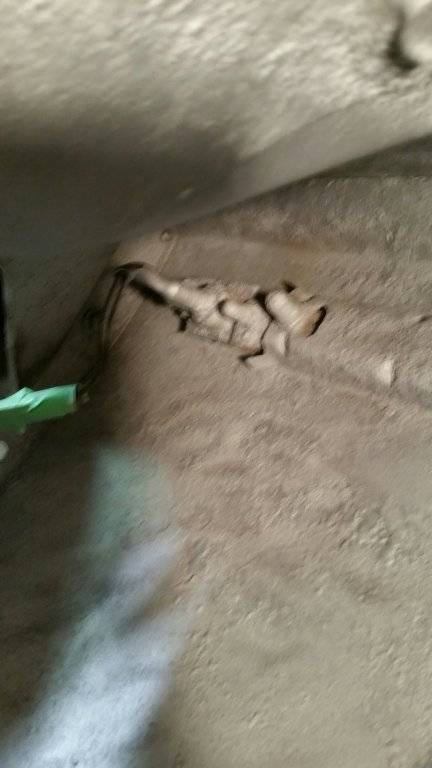

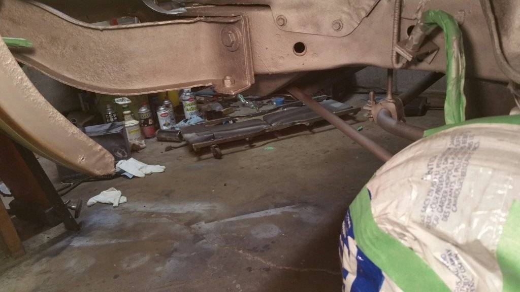

Anyway bottom of engine bay is complete for most part...still have some touch ups to do ect and couple personal touchs as well...my engine bays paint is ready so l can grab that Monday and with a little luck wrap up the front end and move on back...will end up at the tail end where l have to drop tank to sort out fuel sender..will also give me the opp to clean up under there while its out...few pics...

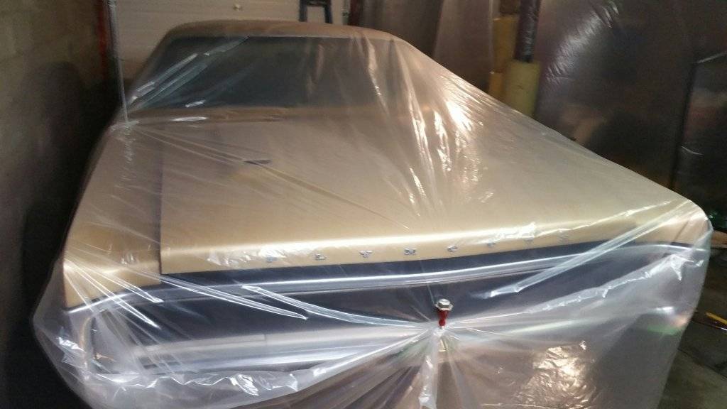

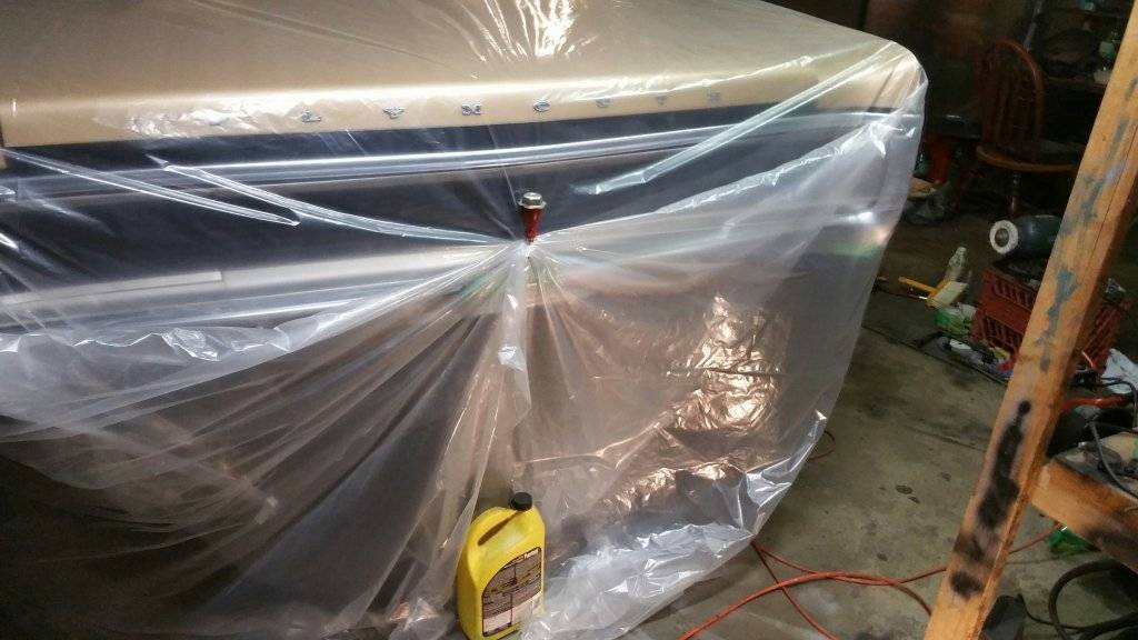

it only took me a hr to clean up all the overspray and dust....argh...anyway along with the heat comes the dust and lots of it...now that the worst is done the ole 70 gits a dust blanky to protect it from dust and paint...
Have my bud watchin over it while lm gone so watch it...he'll shank ya for shure if you give him a reason

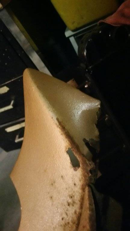

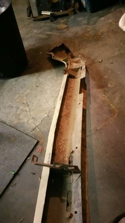

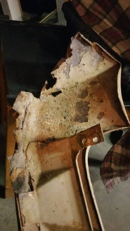

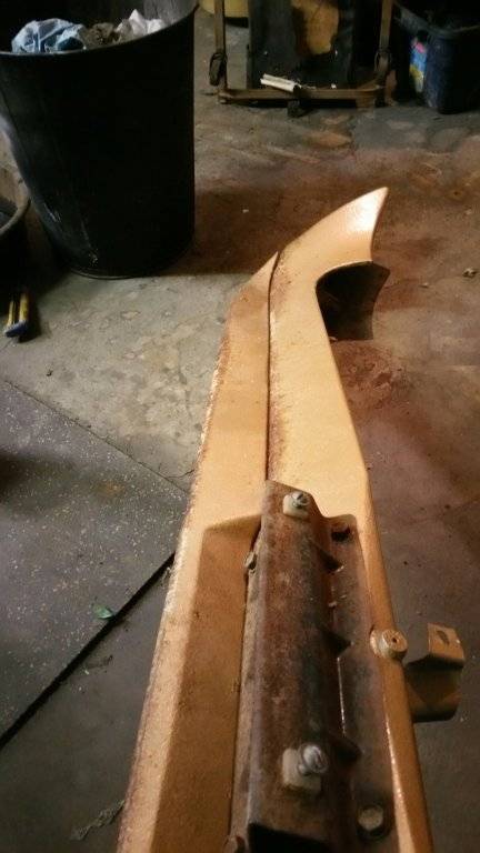

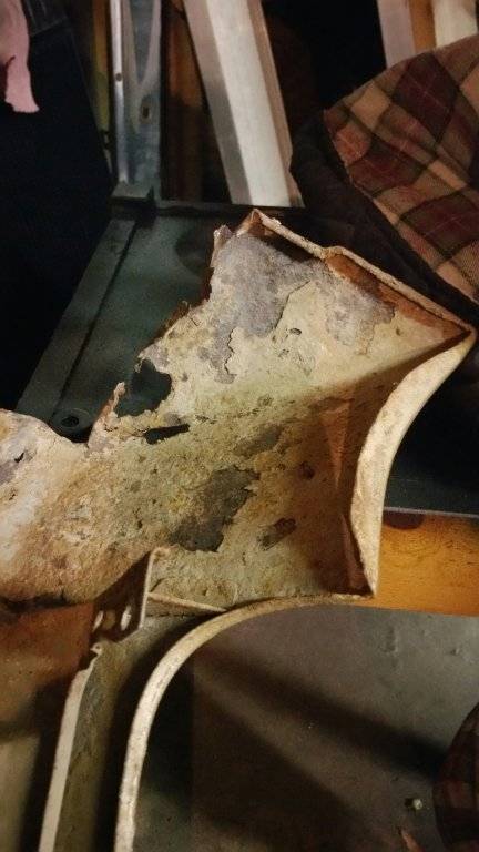

was also pondering my front valance quandary....have a 71 that l can make work and involves nada....or l can try to fix my 70 lower front valance with a little welding ect....
am leaning heavily to fixing the 70...think with a little paitience and a cardboard template l can sort it out...never say never...hell if you don't try youll never know or learn to broaden ones abilities....
