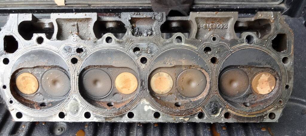

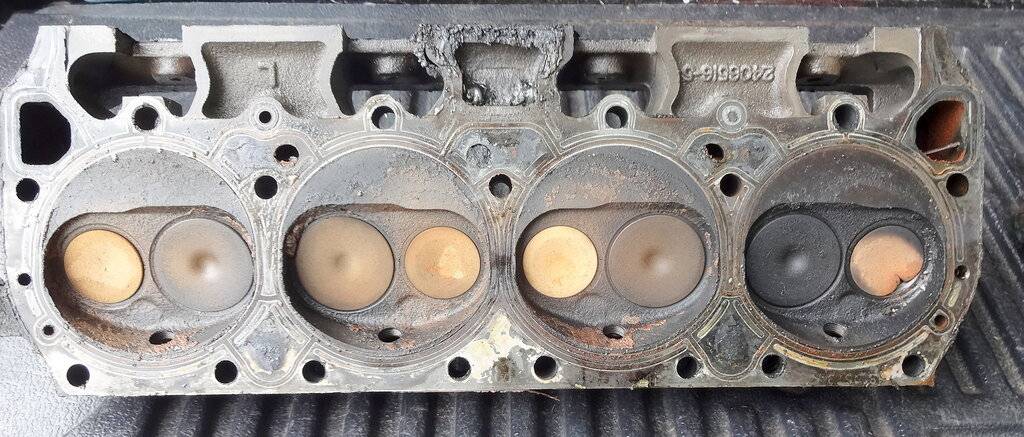

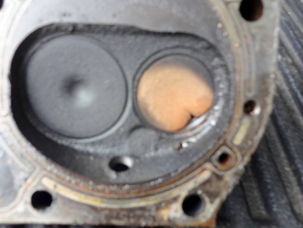

Well, I got the heads off today and my first hunch was the correct hunch. A burnt exhaust valve in # 1 hole.

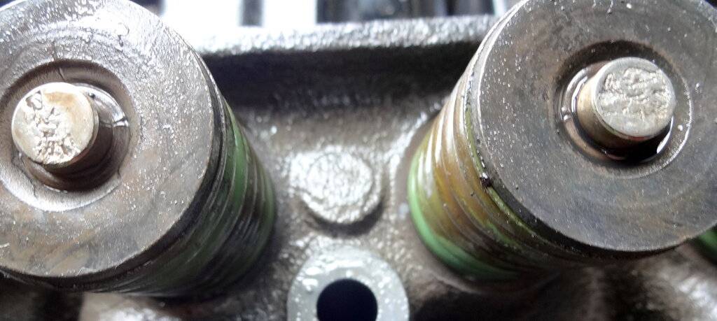

Some galling evident at the stem tips. Looks like new valves throughout.
Get some good one piece valves without the back face lips, free low lift airflow.

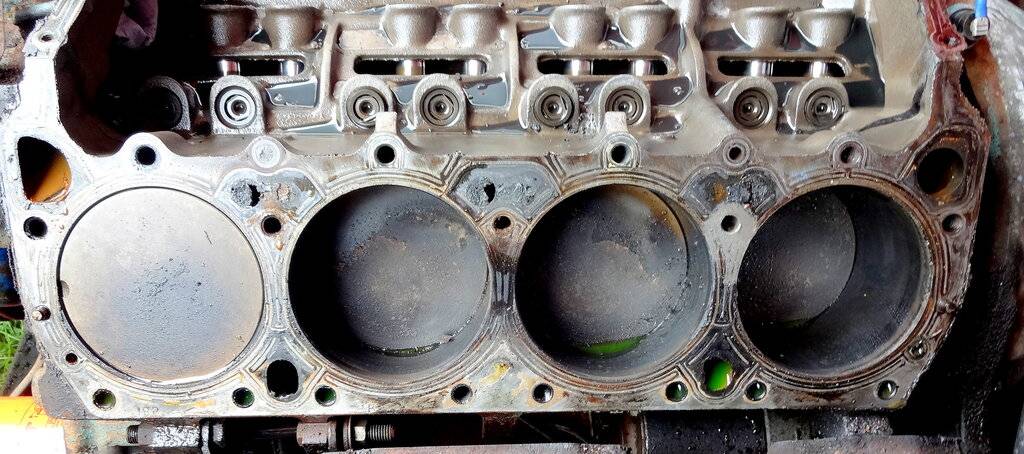

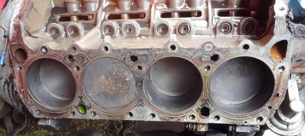

Look at how nice and high the pistons are in the bore. That combined with steel shim gaskets and the nice flat deck across from the plug is the best a BB mopar combustion chamber is going to get with a stock iron head. A fresh non nylon coated timing set and this car is ready for any road trip.
