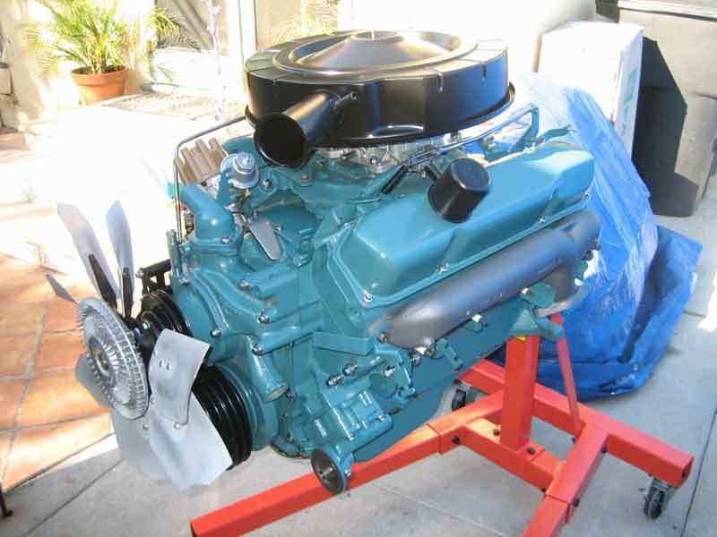

Yup it is "Blueish" but it did match the original paint on the engine pretty well. That said I have seen mid 60's engines in original turquoise that are definitely greener. As it was not a "Concours" rattle can job I was satisfied with colour match.
Looks like the AB at the end of the part number might be the designator that identifies it as being a different shade of Turquoise from the original can bigmoparjeff posted. If the AB number was a match to your original paint then yours must have been painted with the new shade of Turquoise which has more blue vs the original. I ordered the Hirsch paint to match my original engine color.

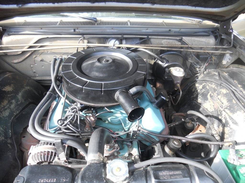

Hi Guys, I am new to this forum so not sure whether I should start a new thread. My recently purchase a 1964 Dodge 880s engine is painted in a "green" colour. Not turquoise or blue. Did Dodge use a different colour scheme or were all mopars of the mid 60s done in the turquoise.

Welcome Paul! I know that Turquoise was the engine color used on big blocks since at least 1962.

Welcome to the forum. I’d say since everyone’s interpretation of color may be different, post a pic of your engine.

Paul,
The green color your 880 is painted that you’re referring to May in fact be the original “Chrysler Turquoise” color.
Go back to page 3 of this thread and look at the pic of the rattle can ”bigmoparjeff” posted. That’s the color my AC bracket was painted shown on the work bench. Is that the green your 880 is painted? If so, it’s painted the ORIGINAL “Chrysler Turquoise”, NOT the newer “Mopar Turquoise” with the AB at the end of the part number.

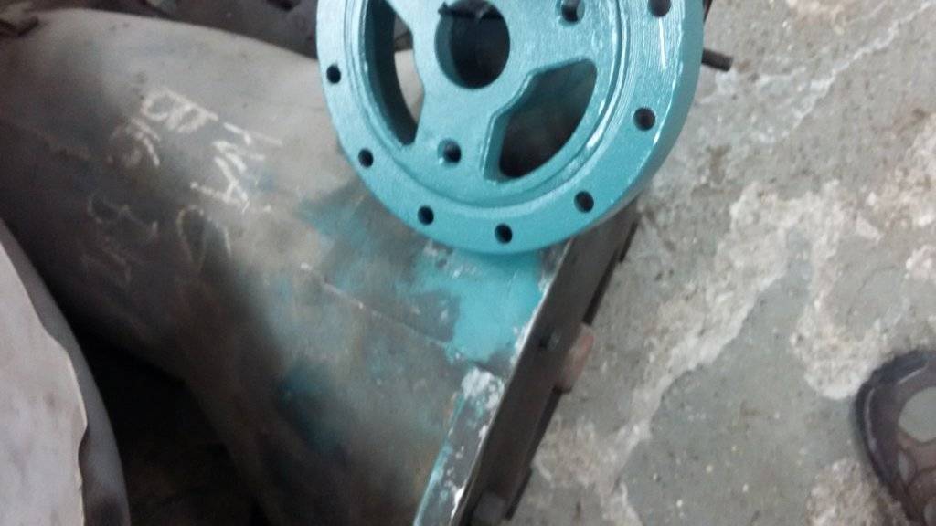

Can't explain why, but the transmission was painted, the Turquoise. Compared a pulley sprayed the Bill Hirsch Turquoise, to an original sample on the 575, dead ringer. Also a small spot was also left on the water pump, again a good match. Going with the Hirsch.

Neither these guys or Bill Hirsch show a green engine color for your '64 Dodge. Are you sure a rebuilder did not repaint the engine in a non-standard color? (Lomac shipped light green colored rebuilds all over the country. A lot of builders did that for a quick ID of the engines they worked on). If you happen to have a Canadian produced auto, some of the plants in Canada were known to use non-standard colors but those were usually red or orange instead of blue or turquoise
