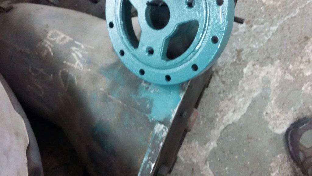

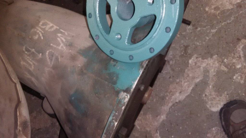

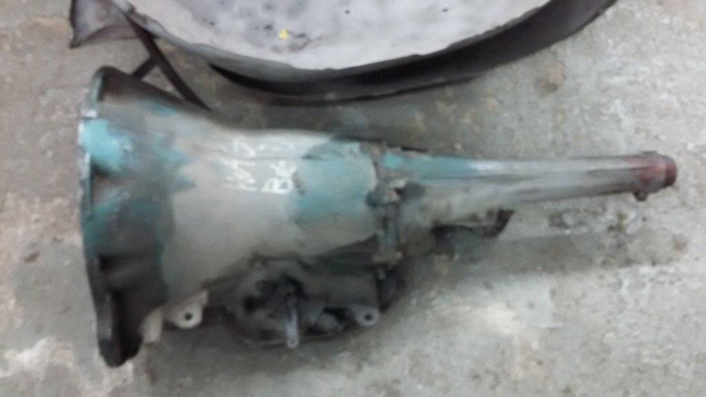

Can't explain why, but the transmission was painted, the Turquoise. Compared a pulley sprayed the Bill Hirsch Turquoise, to an original sample on the 575, dead ringer. Also a small spot was also left on the water pump, again a good match. Going with the Hirsch.
The paint splotches on the transmission are over spray from painting the engine. At some plants, the engine and transmission were assembled as a unit and then the engine was painted in the appropriate engine color. Coverage of the engine in the proper color was deemed to be important for sales purposes so it looked nice, transmission was hidden so it did not matter. For the same reason there will also be spray on the flex plate or convertor (Starters and lower cover were installed later).
Dave
I initially believed it to be over spray as well, but there was paint from the bell housing all the way to the tail shaft. I know it's hard to see in the picture, but that's the appearance. Guess the painter sniffed to many fumes that day

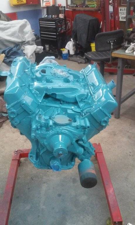

just finished painting it last night looking good

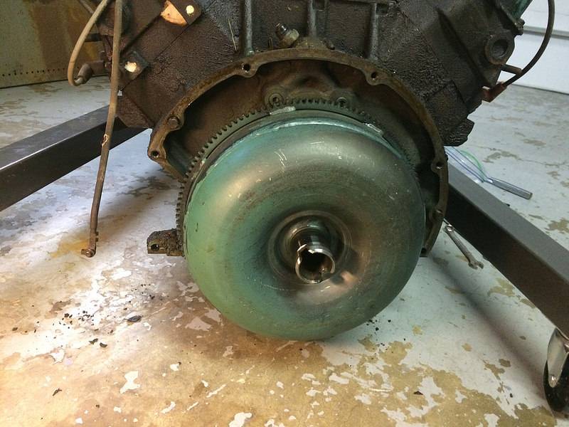

Just for another data point, here's the torque converter behind my '68 Sport Fury's HP440:
Engine_and_Transmission_Details by clair_davis, on Flickr
I don't have a lot of other examples of original engine paint, but I'm not sure that the trans was ever separated from the engine.
View attachment 256014Engine_and_Transmission_Details by clair_davis, on Flickr
