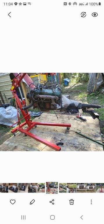

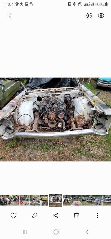

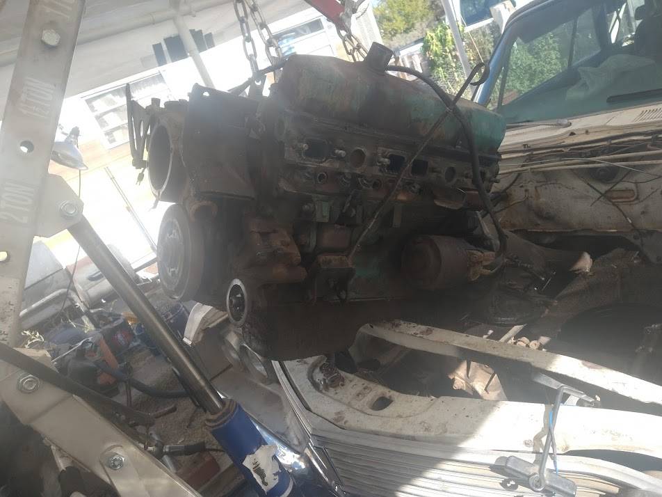

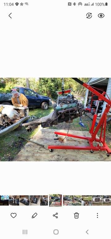

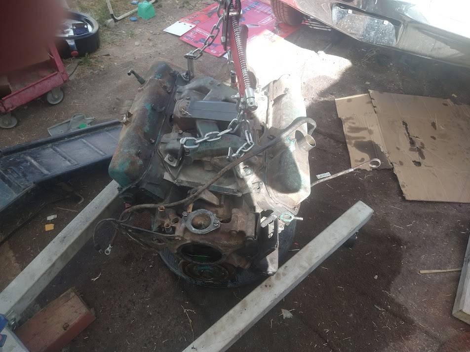

Aaaanyway, I got the engine nicely Down and Out of Mathilda's compartment, without removing the core support, or butchering the grill with a sawzall, as my Daddy-in-law recommended. (RUSSIANS!)
I'll scoot it over a bit more, then extract Gertrude's seemingly accursed motor, and drop Mathilda's seemingly blessed one IN.

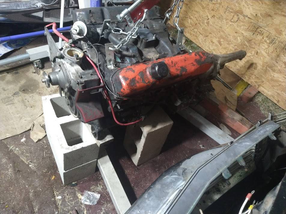

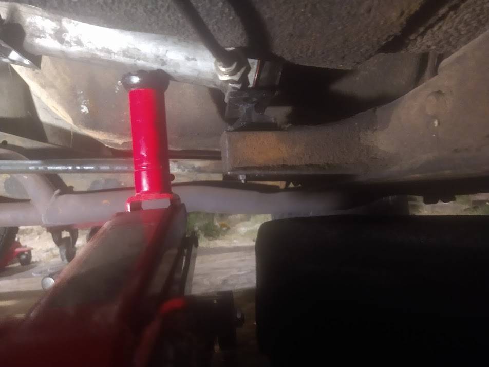

The blocks seem to hold the motor up nice and steady when supporting the bottom of the skirt, along the oil pan bolts. I don't plan to dance on it.
I can remove the hoist legs now, and then pull the motor forward, and out of the way of either body, then pull Trudy's boat-anchor, for disassembly, LATER.
Fans! Stay Tuned! Dr. Frankenmorris measured the tailpiece, mounts et al for his 1966 A727 and it WILL FIT PERFECTLY on his odd 1968 EXPORT Newport convertible! One of our Most Eminent Sages advised me that this might not be the case, but I carefully checked, measured and clicked a pic, and I CAN use the nice, rebuilt, well sealed tranny from Mathilda in this 68 body! This pleases us here to no end, given that the transmission we got with this car, while still functional, does leak more, and shifts rough. Nothing TOO bad, but hey, why take more chances?

Be careful with the concrete blocks, they can break and dump the whole thing on the ground. I know you stated you won't be dancing on it, but be careful and keep the young ones away from it.
Hey Gerald the brain gears were a whirring the other day and came to the conclusion that all that crude you removed from the block was probably all of the 5 gallons of stop leak that someone poured into over the eon's it to cure the problem. You could do as the Nitro Drag Boys do, fill the block with some kind of See'ment, I hear that strengthens the block and should cure you leak, but then you'd only be able to do your errands a 1/4 mile at the time, so not the best idea for a DD.
:rofl:
Oh yea WASH THAT MOTOR!
also>>>> wood blocks.

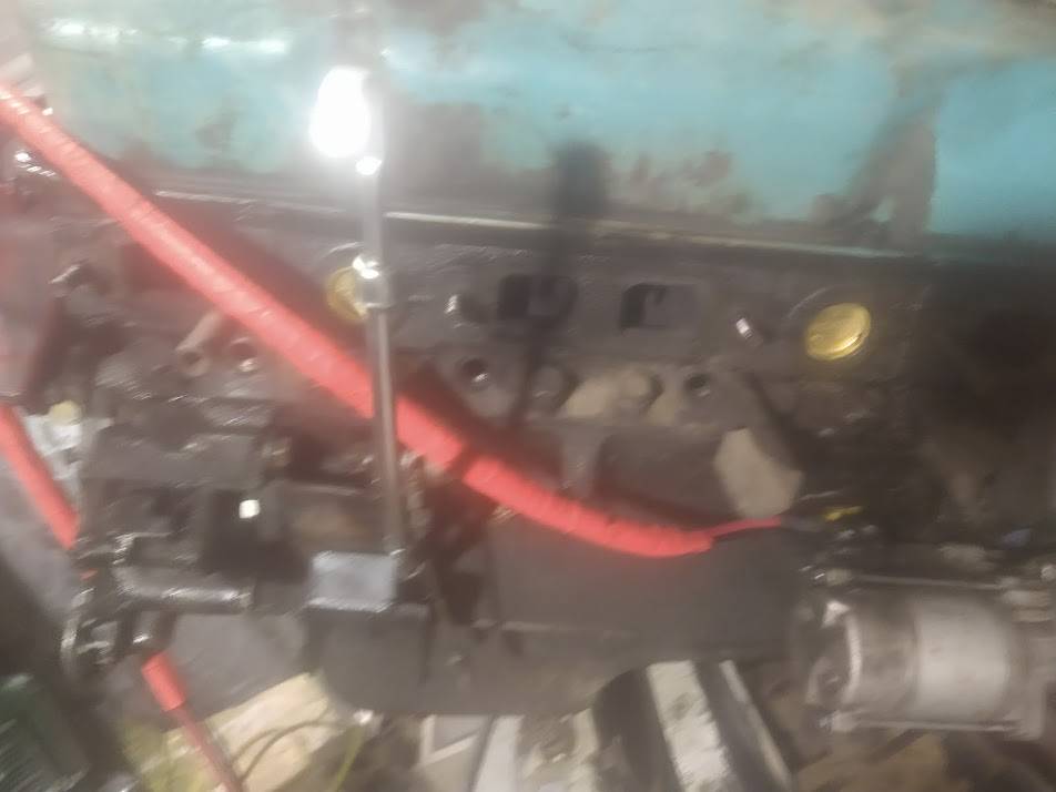

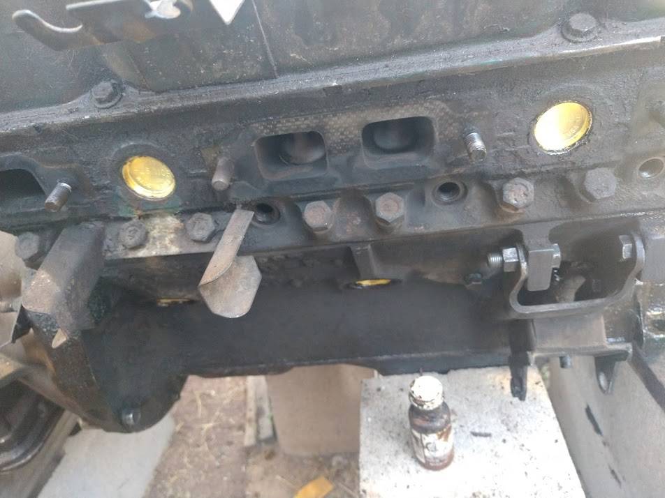

Let's renew the thread with where I left off: with Gertrude freshly relieved of her dead weight motor. Having extracted Mathilda's engine earlier, I made good on the promise to myself to replace all the expansion plugs with brass ones if I ever got that engine out of its compartment:
See the bottle of Indianhead shellac on the cinderblock? This ONE BOTTLE has provided enough shellac to seal over 5 years worth of "freeze plugs" and coolant pump gaskets. thermostat housing gaskets and a few odd jobs. The ONE copper plug I left in this block behind the rubber biscuit bracket showed NO corrosion, so I just coated the whole plug with another layer of shellac, making sure it bonded onto the iron block surfaces around it. I expect it will outlast the iron in the block, if left in a state of Nature,so that several billion years from now, some archeologist might find the plug with some ferric oxide clinging to it, and ponder its use.
All the brass is U.S.A. made too, from Melling and 440source.com. One can savor the view of the very same brass from the next pic, taken as I began the descent of the engine and transmission into the compartment. Here let me repent of my earlier disparaging comments about the

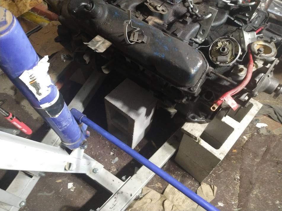

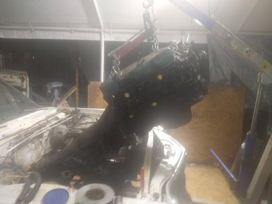

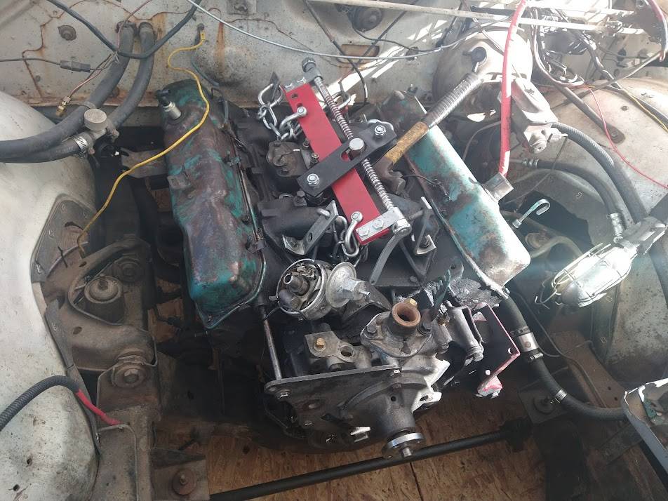

Torin leveler I purchased a few years ago against days such as I've suffered through the past few weeks. This device proved IMMENSELY USEFUL and saved me HOURS of toil! Be this as 'twas, I still plan to make new L brackets for it from good 3 inch angle iron....
Here I cleared the core support with room to spare! My secret? 1.) I cinched up the leveler chains be 3 links, eliminating the play in those, and increasing the motor altitude and 2.) I had the car ON THE GROUND, permitting it to roll when needful, and 3.) I used a couple sheets of 3/4" OSB I had got from a now departed neighbor. I refrained from using this at first from fear of the hoist wheels destroying the stuff, as indeed happened when handling a 400 with TF 727 attached 4 yrs ago. BUT, the caliche beneath the OSB was DRY for this exercise, assuring a firm bed which supported the glued woodchip board well enough to allow it to roll with little damage.
I even cleared the transmission mount in the crossmember with as much room as the tunnel would allow! Unfortunately, I jacked the tailpiece enthusiastically, lifting the main crankshaft bolt into the core support I cleared so nicely! GRRRR! So I'll have to use some oak boards
and C clamps to straighten up the top a bit. Oh WELL!
Despite that little accident, I got it dropped right onto the mounting pads on the K frame AND the crossmember mount too! Absurdly EASY, All Things Considered....

View attachment 501175 View attachment 501176 View attachment 501177 View attachment 501175 View attachment 501176 I had no problem with mine greased the leveling bolt, smooth as silk.I also removed the grill and radiator support, WAY easier.
Yes, I greased the leveling screw also. They won't budge without it. Both extraction and insertion went pretty easy on Gertrude. I'll try dropping the core support next time I do one of these jobs, and see if the extra effort up front is worth it. Witgh the OSB under the hoist and car, it REALLY went quite easy. I don't envy your environment up back east. Uh UH!
