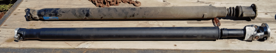

I sent down the drive shaft today. Should be there tomorrow. Only $17 to ship via Spee dee delivery ( Midwest local delivery company that covers about 5 states). If I would have had a corporate account it would have only been $10. Anyway they will call tomorrow and discuss what they can do. The problem for re build is they cannot get the necked down tube. I think it is 2-1/2” at the ends and 3-1/4” in the middle. They didn’t seem too concerned about the integrity with the dent and may try to balance it. They want to look at it first. If it is not salvageable I may have to get a straight replacement shaft. If that is the case I will have to keep a good look out for the correct used one for the future. ( Sorry I do have a small list of things that I want either NOS or gently used to replace a couple of items.)
Mike, I forgot to ask them about your Detroit style shaft. I will try to ask when he calls tomorrow.
I called and talked to them and the answers sounded good - "We can balance that type shaft and if there's any issues with repairing your old joint we have a new adapter to convert the front of your shaft to a u joint.". So I sent it in and got a call Friday, "It's all ready to go, that'll be $351.00." When I asked about the repairs on the old joint "Oh, we can't even get the rubber boots anymore, much less the internals to rebuild the joint." Got it back today and it does look nice, but it would be nice if they were all on the same page, i.e. being told up front it can't be fixed - Hell, I have the boot and cover here, I was mostly concerned about balancing it afterward, so I could have sent parts with it.
Original on top, new mod below. (The top shaft is the better of the two I had and the torn boot isn't obvious in this pic.)

So is the bottom shaft half Of one of your original shafts with a new front?

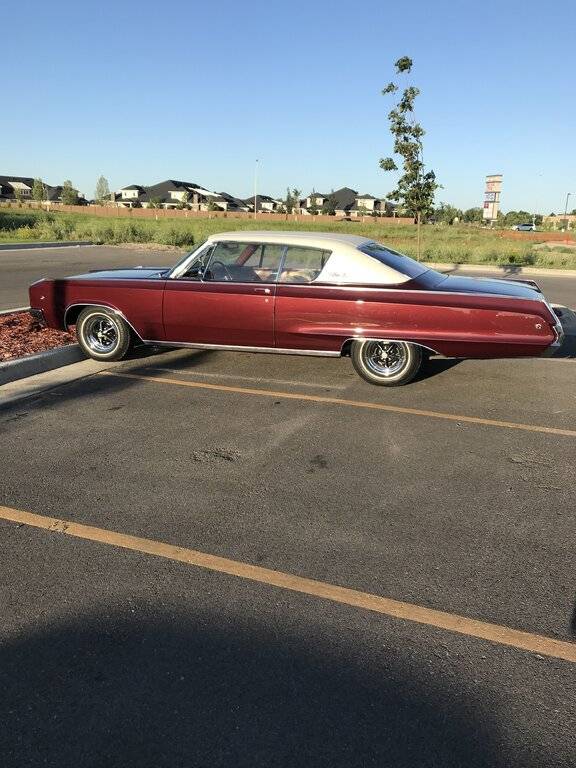

Sweet ride. I like it. Kim
