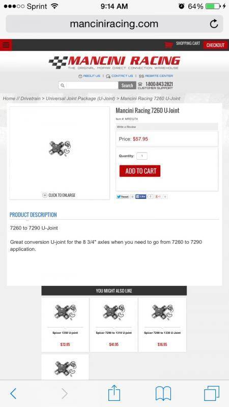

a 727 is 3" longer than a 904 so you don't have to do all that trick math. just have 3" cut out of your old shaft or just measure your shaft and subtract 3" and you know how long of a shaft to look for. they make offset joints so that won't be a problem
I've got the factory measurements do a 440/727,I'm just going to use those.
You talking about these?
