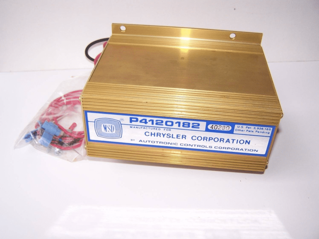

They sold the MSD-7C through Direct Connection. That was their race box.
I brushed against a plug wire with one hand while my other wrist was against a hood pin while timing the engine with an old style light. It lit me up like you would not believe... Every muscle in my chest and arms hurt. That was 45 years ago... I would bet if I did that today, it would kill me.
When I put the MP kit on my '67 Newport, I also bought a base-level MSD control box, the old MSD 5C. The "5" was their entry level multi-spark control box. The "C" meant it had the Chrysler-specific plug on it. I found an electrically-good mounting location behind the lh frt fender extension. Spliced-in wiring that ran with the OEM harness to the rear of the fender, past the voltage regulator, across the cowl, then down toward the distributor.

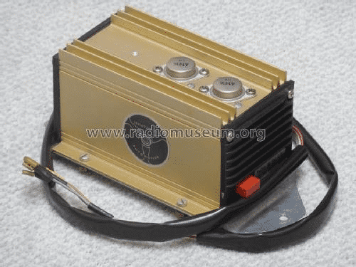

I used to have a Heathkit CP-1060 capacitive discharge ignition I built back in the day. you could turn it on or off with the red button as I remember. I frankly didn't notice any difference when on or off.
CD isn't too much different than a good dual point but multispark makes a difference.

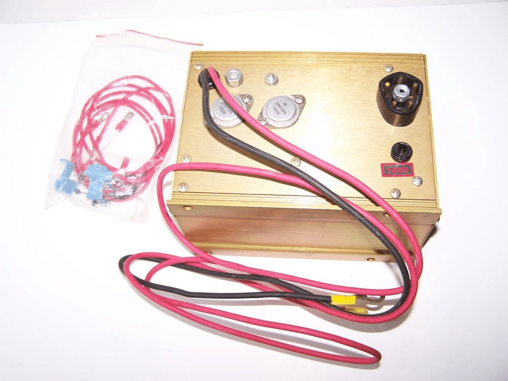

MSD looks VERY appealing, if I can score a good deal on one. I see on the older stuff dual BJ power transistors, which is what I would expect of 50 yr old electronics. The crap shoot on such would be the capacitors. Are all the modern units MOSFET powered?
