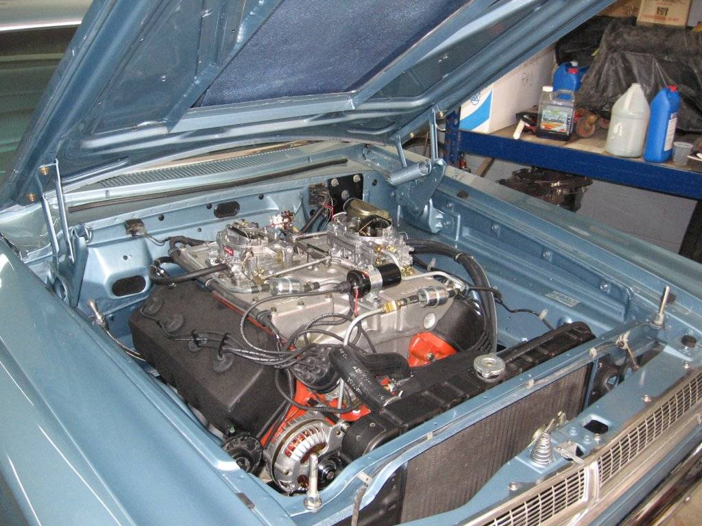

Pertronix I is the simplest and easy to install.Been using them for over 20 years now.
Even used them on this 472 Hemi. Never skipped a beat even at 7,000 rpm.
