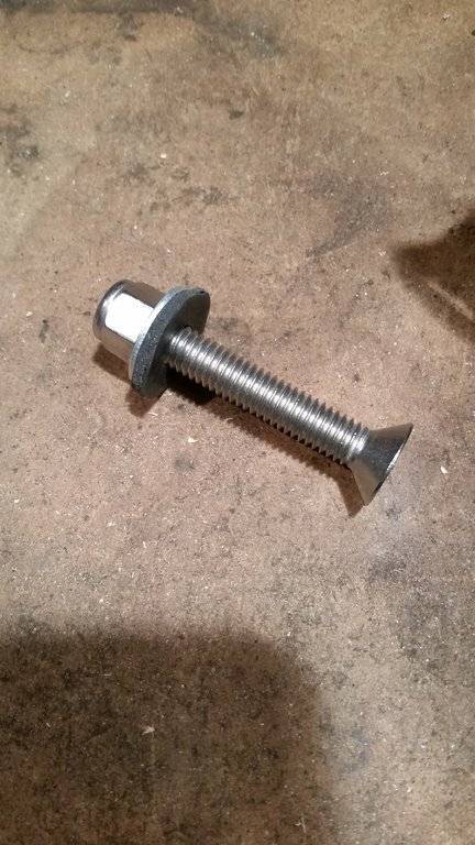

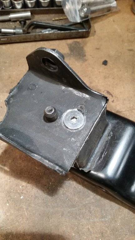

I have modified my mounts to not pull apart, by drilling through and installing a 3/8ths bolt with a nylock nut. I used a 3/4" drill to countersink the head. Under the nylock head I made a rubber washer for cushioning.
Works like a charm, does not transfer vibration and the only difference is the tiniest of vibration when in reverse as the bolt head touches the frame as the mount is under compression in reverse.
Tip - don't drill the hole oversize at all. One wants the rubber of the mount to grip the bolt and not rattle around. The rubber does swell a bit and acts as a threaded shaft.
Tip 2 - Don't tighten the bolt down hard. This will make the mount solid, which you don't want. Tighten the bolt down only to engage the nylock and just (and only just) contacting the rubber washer.
Ross, I'm not quite understanding this. If you run a nut and bolt through the mount, aren't you effectively making it a solid mount?
OOPS! I left out a critical piece of info!! Thank you for reminding me. I have edited my above post.
If I had tightened the nut down hard yes, but in this case I only just tighten the nut to just touch the rubber washer. This permits proper flex of the mount without making it solid.
