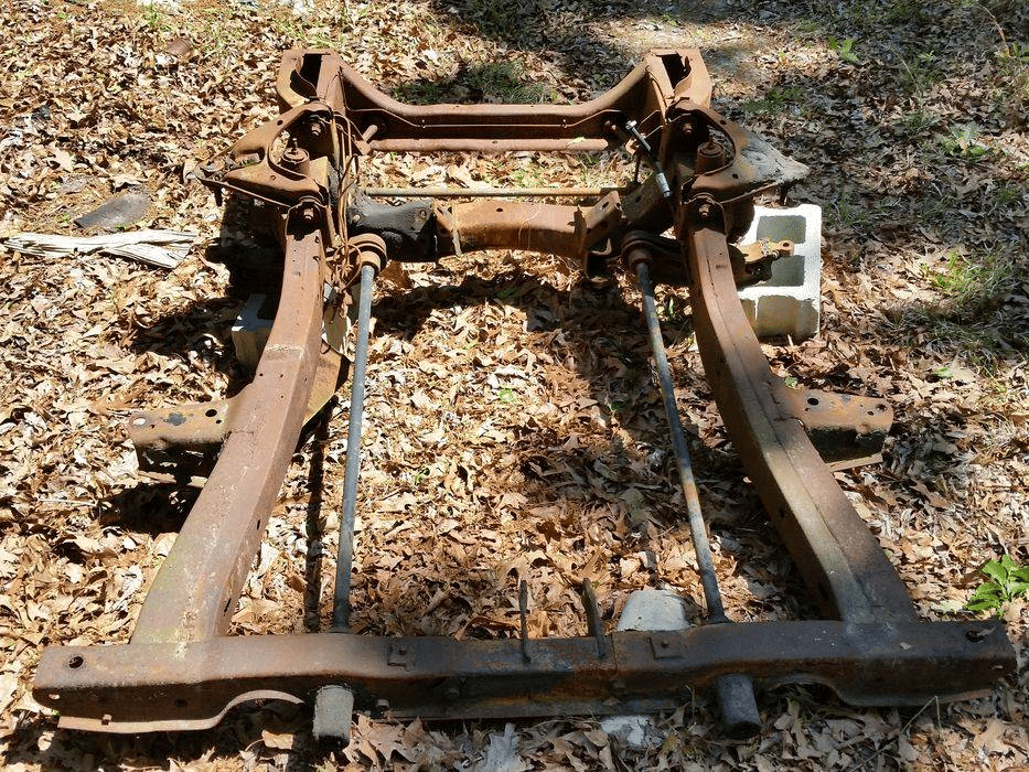

Really, the best way is to remove the engine, k-frame, and transmission assembled together from underneath the car by jacking up the body! That's how the factory assembled it! Much easier than you'd think!
There is no K frame on a C body, it's the front subframe. Much more work than a K frame.
Great for A, B, and E bodies.
C-bodies don't have a K frame. They have a stub frame
You're right, remove the entire sub frame! Makes it even easier!
Much harder. All the front-end sheet metal comes off, bumper, grille, radiator support etc. Except for releasing the tension on the torsion bars, the suspension doesn't need to come apart like a K-frame on like a B-body, but that's the only advantage. Basically, everything from the firewall forward comes off.
Then there's reassembling the front sheet metal and that will mean alignment of fenders, bumper, grille etc.
The stub frame (not sub) goes from the front bumper all the way back to the rear transmission mount.
If the engine needs rebuilt, doesn't all the suspension parts need to be addressed as well? Besides, my first post wasn't much different than what others posted. But if the engine has issues, surely the suspension does too. Just saying!
And the subframe has the parking brake cable and brake lines to remove also. You can remove front suspension from the subframe or K member just fine when it's in the car.

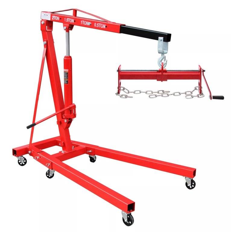

I'll make a suggestion that you purchase a load leveler like this Harbor Fright one. https://www.harborfreight.com/autom...velers/2-ton-capacity-load-leveler-60659.html While you can do it without like I did for years, it does make things easier, especially when you put the engine back in.
That's good! The more stuff off the motor, the lighter it is. The lighter it is, the easier to lift and move. Simple physics.

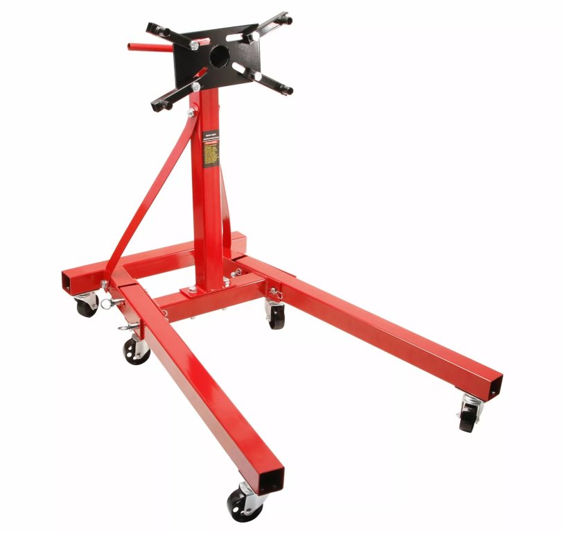

Hello John,
I got a low budget Engine Stand and Hoist, made in china for incredible low price...
It looks very solid and will make the once in a lifetime job.
I will sell it once the engine and transmission is back in.
Hello John,
If you have the room keep them.
I've used my engine hoist for lifting heavy objects other than automotive related. I even made a longer boom for it for lifting things not as heavy as engines but where the legs interfered with getting close enough with the standard boom.
