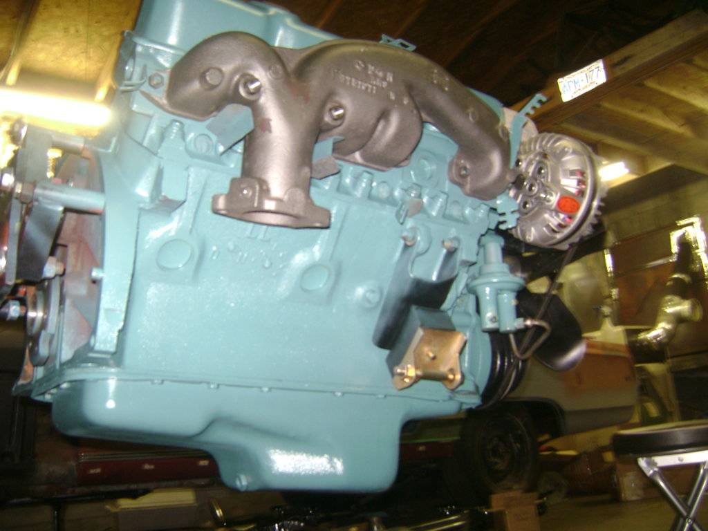

Ok, have a plan now. Ordered reman engine. 2 weeks out for build. I am keeping my core just in case they send me a lemon. Core goes to machine shop for cylinder and head work. I am comfortable changing bearings and seals. FSM in paper form on the way. That should help.
Called a friend who does paint and body. He has experience in engine replacement, has a lift with leveler and other things. He says I can bring the Fury there and we can do the swap. I offered him $1K but he says no money. I have done gratis electrical work for him before, so that is nice of him to help out. He has asked me to hit the exhaust manifold fasteners with PB Blaster every evening until I take the car to his shop. I'm going to order exhaust stud kit and new motor mounts.

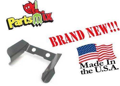

Speaking of manifolds a ND hardware, I am trying to find some spark plug wire shields for my ‘68 383. Anyone have any pictures of how many pieces there should be and how many? Searches seem to only turn up a piece at a time.
Thanks
Thanks

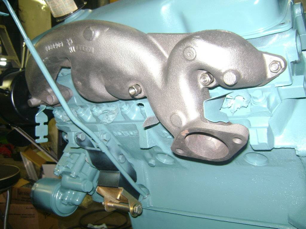

One per side-total of two.
each one shields the last two plugs each side ) #5 and 7, left #6 and 8 right side.
They are bolted down with the cylinder head bolts before the manifolds go on..
Mopar 1967-69 HP Big Block Plug Wire Shield
I was just looking at the parts book and I see there is a right and left.
1821394 & 2843891.

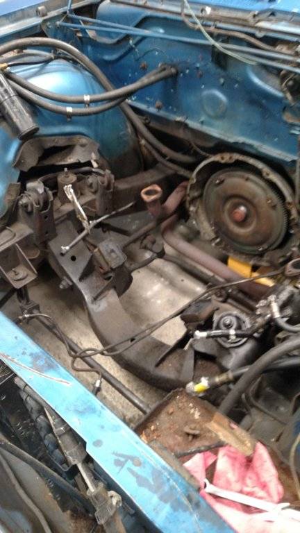

I must be a odd duck as I take it this all involves a 68 Sport Fury right? I've done all this by myself, but I have never been of short stature YMMV. Hood removal can be done single handily, just make sure you have the reach to grab both sides, AND WEAR GLOVES!
And not these wimpy hitech gloves but good ole cheap cowhide construction gloves the kind you would use with a sledge hammer as the rolled joined edge of the hood can pinch cut your fingers. And it that happens you may drop the hood but that's where the steel toed boots come in get it? LOL And don't bother scribing the hinge location on the hood as every scratch you make through the paint is a invitation for rust to start, use a magic marker or some pinchweld primer.
I R&R my 1st 68PK21 hood all by myself when I was 17 to install the Cold Air system off a SuperBee. It's not that hard.
As far as pulling the engine and tranny together, how much do you value that vintage paint on your firewall & radiator support? I've done it that way once, never again, I've helped stubborn friends (GM) do it too with a big "I told you so" at the end. Small block 4 speeds, yea OK but a Big Block with a auto transmission, more hassle than it's worth, separate them. Every time things would get banged & bumped.
