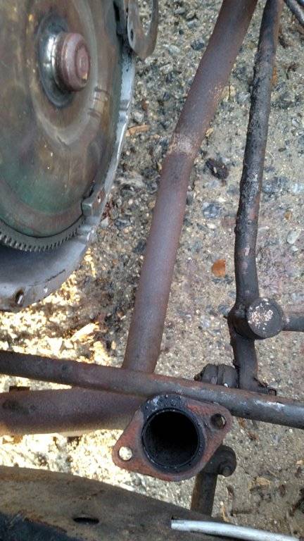

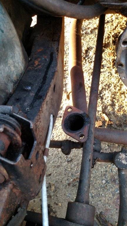

Could I get you to take a picture of the exhaust y-pipe from the perspective of the right front of the car? And also where the left side bends around and ties into the Y? I am having an exhaust shop build me a new one and would like to have these shots to help with accuracy. I cut mine in high school to make duals and want to undo it. Thanks

Yes, I will take some pictures. I won't be back at friend's shop until Monday or Tuesday. We have snow coming tomorrow and his place is on a mountain in the boonies. Roads may be bad until Tuesday.

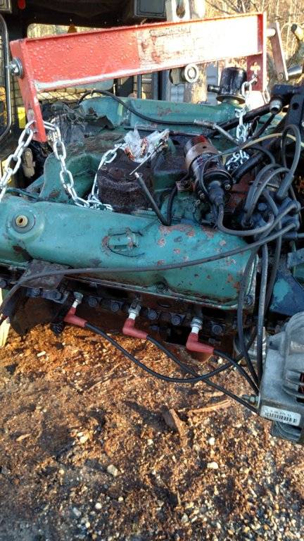

Engine and engine bay degreased with diesel fuel followed by purple power.
Found a block heater on the engine. Northern car originally?

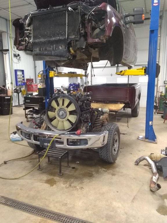

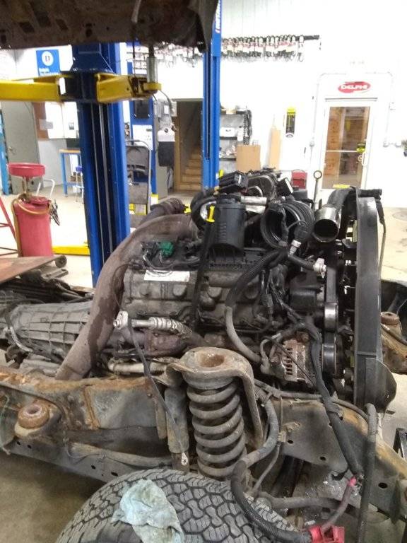

I am not trying to steal your thread, but check out what I had to do to get the engine out of this 09 Ford F250 with a 6.4 Diesel.

WOW! That’s sure is allot to do just to change Glow plugs.. :rofl:
I’m sorry!! Just break’en balls. Lol
That is how you'd change them... guy's doing it everyday have the cab off in under an hour.
Working on EVERYTHING, as you do, how was the learning curve on the cab removal? I'm picturing myself spending about 3-4 hours the first time, just making sure I didn't miss anything... Nothing worse than pulling something apart because you missed unbolting/disconnecting it. Actually, it is worse when you get to PAY for the mistake...:rolleyes:

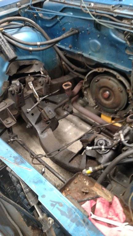

Since you've never done this before, be sure that torque converter is slid all the way back into the trans so it engages the pump when you put the engine back in. It's going to be a PITA as the pic shows it's slid out of the pump. Failure to do this will cause all sorts of headaches and maybe some damage.
Once you get it pushed back, clip a pair of vise grips to the bottom of the bellhousing so it doesn't walk forward again while dropping the engine in. This is why I recommended doing that before pulling the engine.

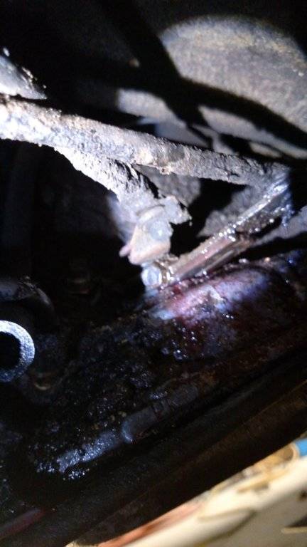

Transmission selector seal replaced. Also did the front pump seal.Selector seal leak was really bad. You can see fluid loss in the photo.

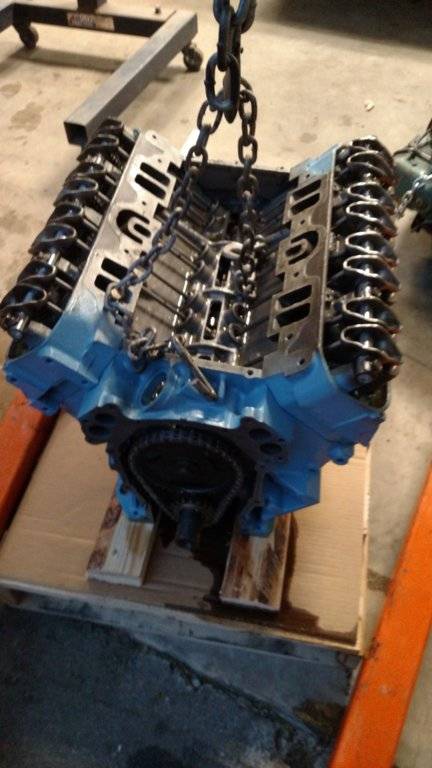

Here is the new long block. Casting date is 1967. Notes show forged steel crank, which is correct. They painted Chrysler Blue at no charge.
Tomorrow, we start repainting valve covers, etc. Oil pan has a crushed spot we are going to try to fix.
