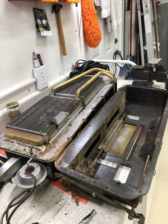

removed my heater box, dismantled and took the cores to a local radiator shop. cost $200 to clean, pressure test and close a few pinholes. Very much worth the cost.

Nicely done!
I think it's rare that a core is completely rotted away and is unrepairable, because at the first pinhole the owner short-circuits the heater hoses and goes on without heat, the accidentally preventing further damage from crappy, corrosive coolant.

If it had a "few pin holes to close", then it will likely have more in the future. I believe it is better to have the radiator shop put in new proper thickness cores that they may have to cut down to the correct dimensions. At least that is what I had to have done to one of my older cars once and it worked fine. For about $200. I can say for sure on my fuselage C bodies with a/c, I do not want to do that job more than once in my lifetime.

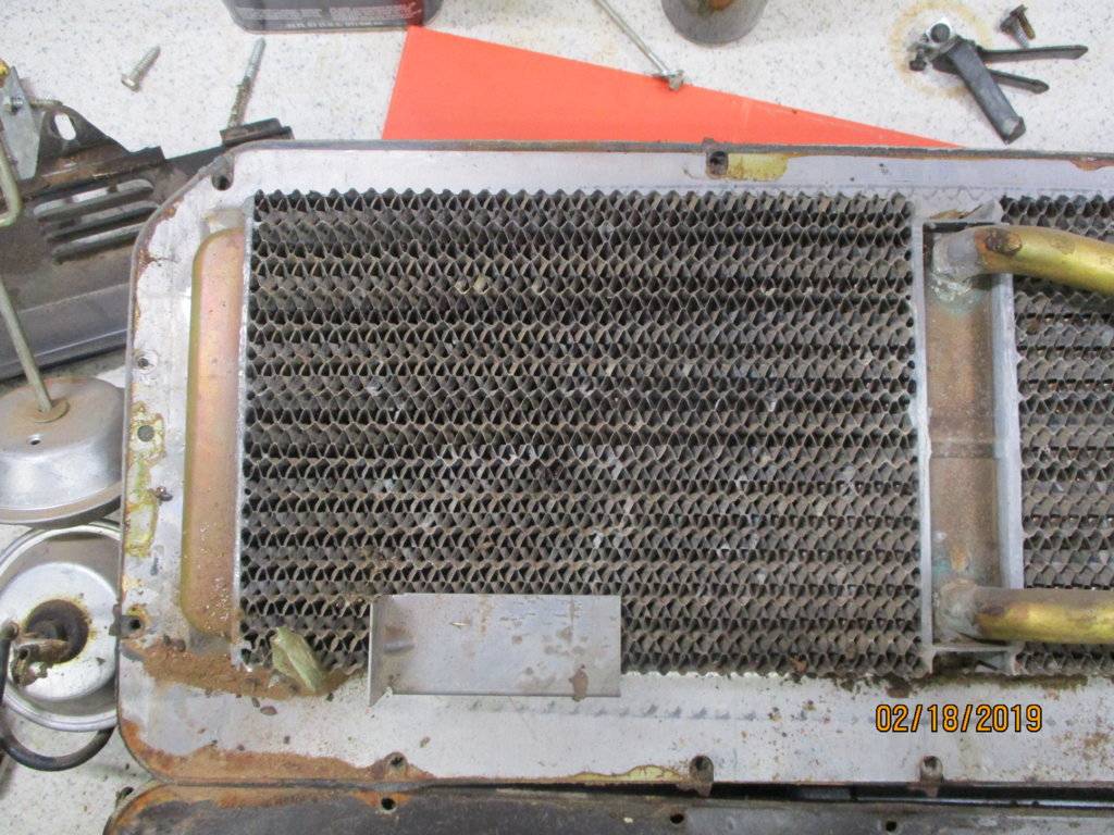

My Hurst core was very nice (I think!) when I had it all apart a year ago to rebuild the whole AC system. Perhaps the mouse poop protected it. :(
EDIT: When I had this unit apart, I had no source for a core and didn't want a used item. So I was fully prepared to do a bit of soldering if I found a weak spot. The heater had been bypassed long ago, so I had no idea if it had a leak. But because it had no heat control valve on the fender and it was a New Mexico/Texas car (warm weather) I was hopeful that was the reason for the bypass vs. a leak. Turns out, the core was quite solid. Had some worrisome greenish "dots", but a "gentle dental" showed no dangers.
