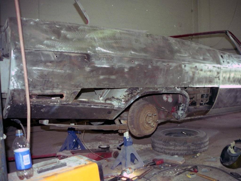

I think that there is a bunch of rust in the quarters unfortunately.
They lower part of the quarters would be an easy fix but the wheellips are rusted, too. Difficult to repair if you don't have a clean wheellip out of another car as there is no excellent repair sheetmetal available.

Im sure it will be an expensiver fix. I'd like to do a majority of the work and prep myself when it gets to that point. Is the wheellip section able to be cut from other fuselage c-bodies? Or are the dimensions strictly to the Fury?

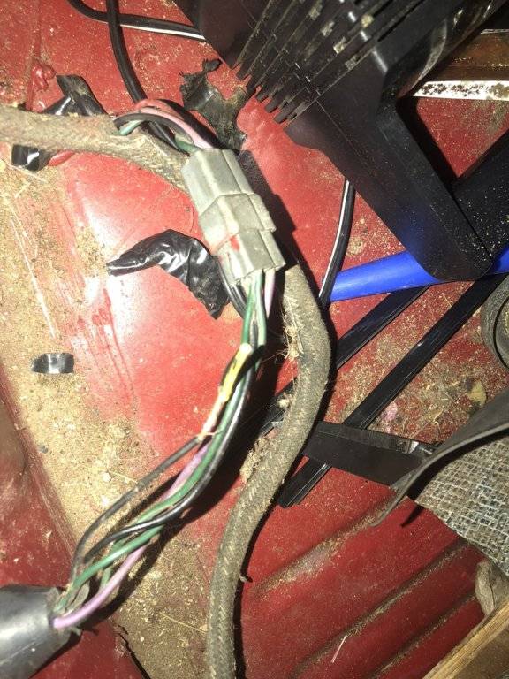

I decide to park, and put the convertible top down since it was a sunny bright day out. I then start driving. Immediately within 30 seconds, the cabin starts filling with the strong sense of the paint smell. I immediately think “is this air coming from my engine bay?” I close the vents and I could still smell it. Immediately after the smell becomes unbearable, burning to the lungs and smoke engulfed around me. I quickly pullover to the side of the road into an empty parking lot and try to locate the source of the smoke. It’s coming from under the rear seat. I immediately think it’s the convertible top motor burning up or the wiring leading to the rear tail light cluster. As I had just put the top down.

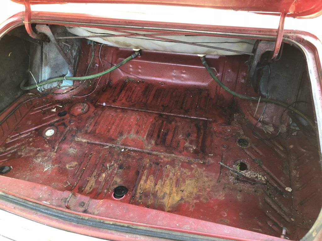

I run to the front, pop the hood and cut the negative battery cable. I then pop the trunk to see if it’s the rear cluster. It’s not and the trunk is seemingly empty with smoke. I wait for a second to see if it dissipates but instead it intensifies. I immediately call 911 and luckily - I was literally within 500 yards of a fire station precinct.
Mind you - normally I keep an extinguisher in my New Yorker but I had not had enough time to buy one for this car as I just got it 3 days ago. Thankfully I had just added the fury to my insurance policy, effective last night so had it been unfortunately worse, they are some peace of mind.

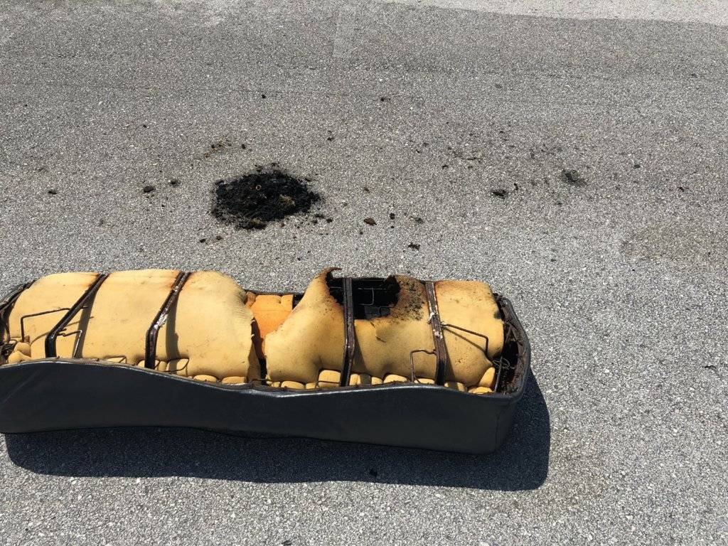

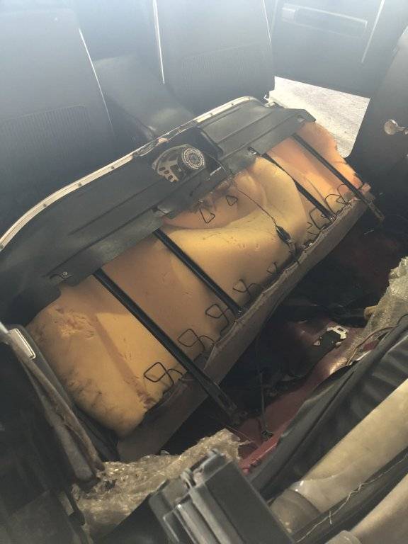

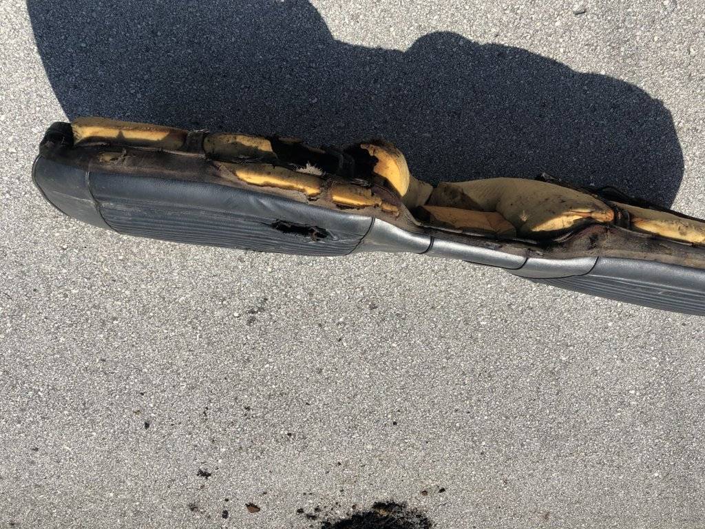

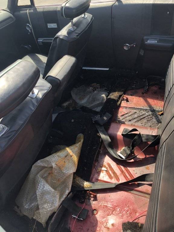

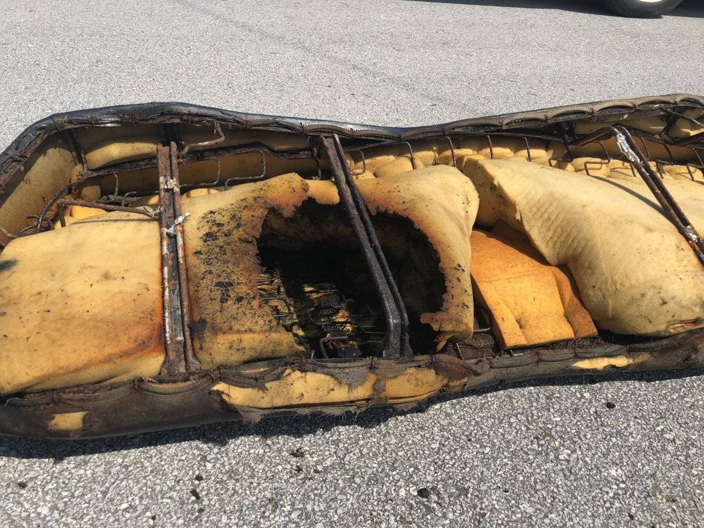

The fire department and units come and are forced to pry the seat out of the mounts. As soon as the seat hits the open air it sets ablaze. Thankfully they put it out but not without alittle damage to the seat.

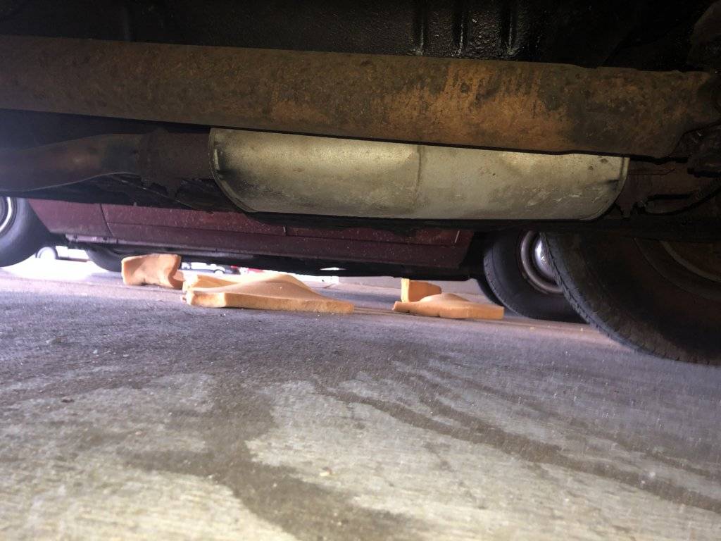

The cool the car down and upon our inspection - it was no wires or electrical. Seeing that the muffler is directly under the seat, Their idea is that the muffler gave off enough heat to transfer through the floorboard, then melt the bubble wrap padding, burn the carpeting and starting burning away at the seat fibers.

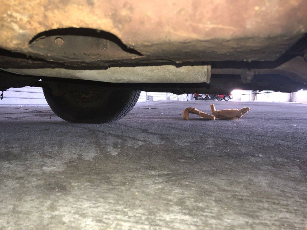

I checked under the exhaust and there are no obvious or glaring cracks, holes, dents or bulges in the muffler or exhaust system. I inspected the welds around the pipping and they look professional.

I checked both rear floor boards and the left is very thick. The passenger side rear is noticeably weaker and thinner, and has some give but no holes. That obviously will need to be patched.

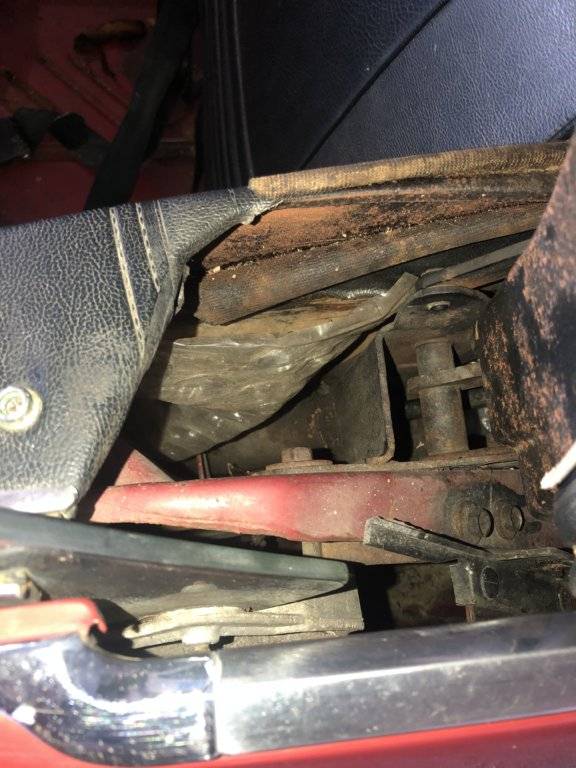

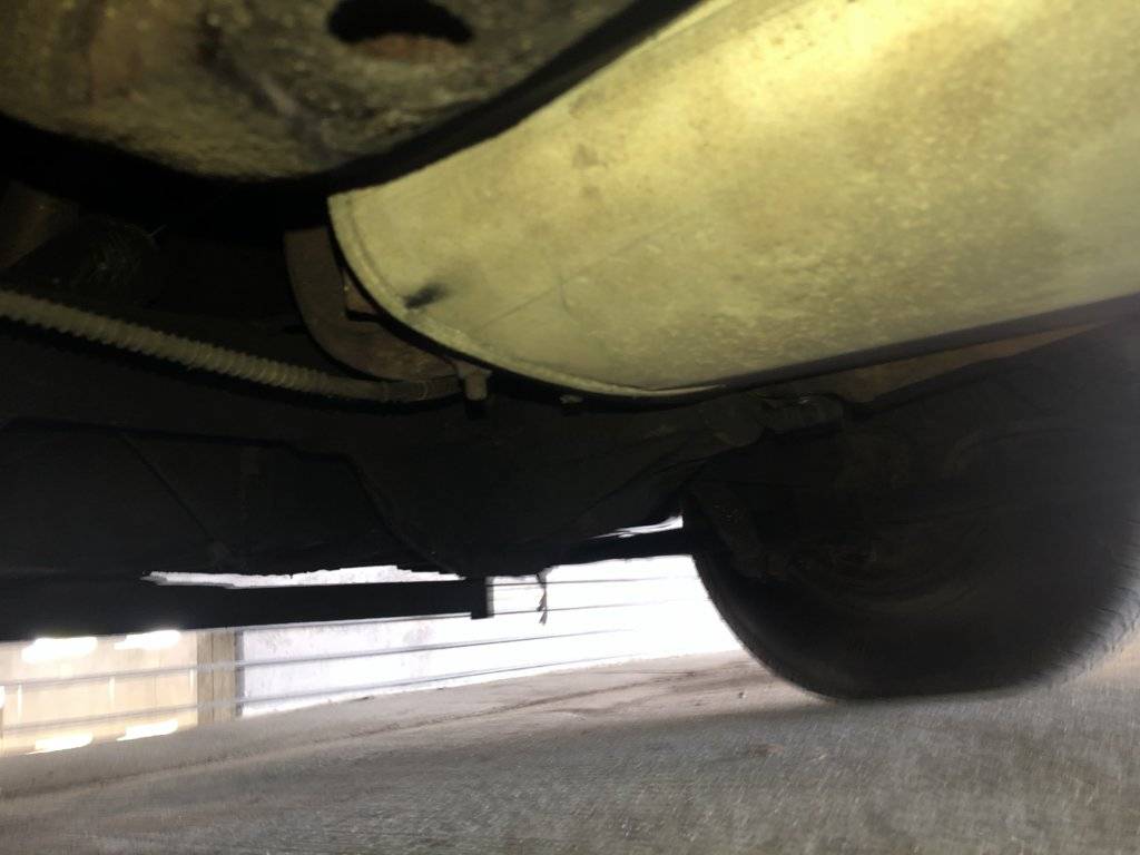

Wait, just looked at the muffler pic again, has it been hit and pushed up against the floor?

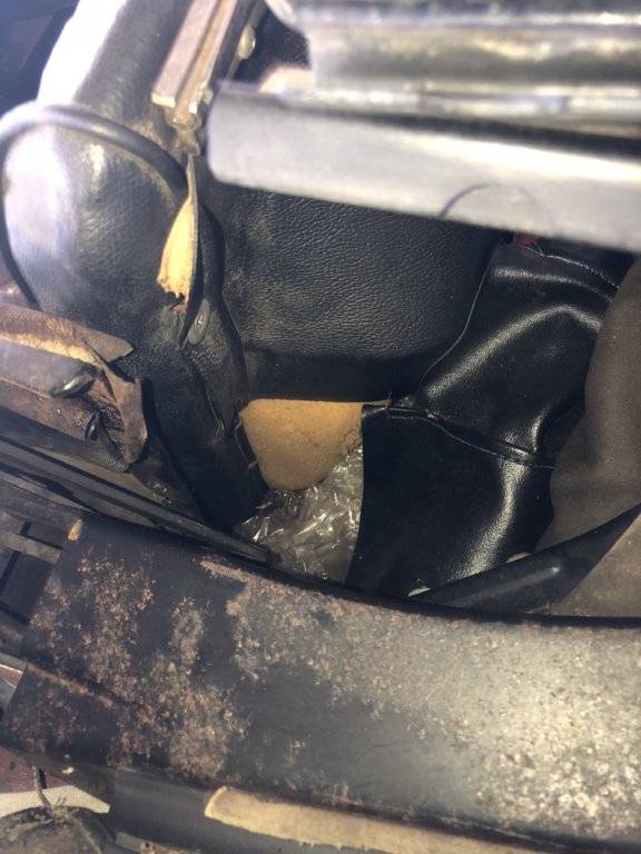

Yeah there should be at about a minimum of 3/4in gap between muffler and floor.Inspecting more around the rear of the car - even the seatback has more bubble wrap an extreme amount of padding. Even the right side panels are filled with bubble wrap. Poor mans sound deadener? There wasn’t any on the passenger side - I wonder why.

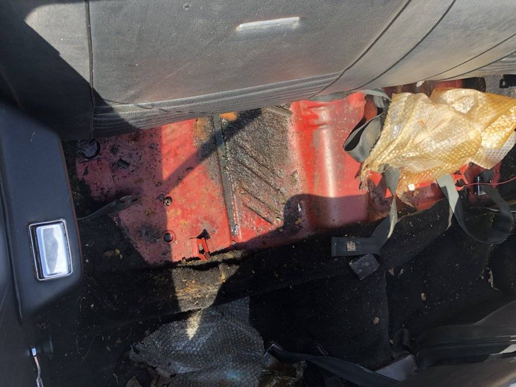

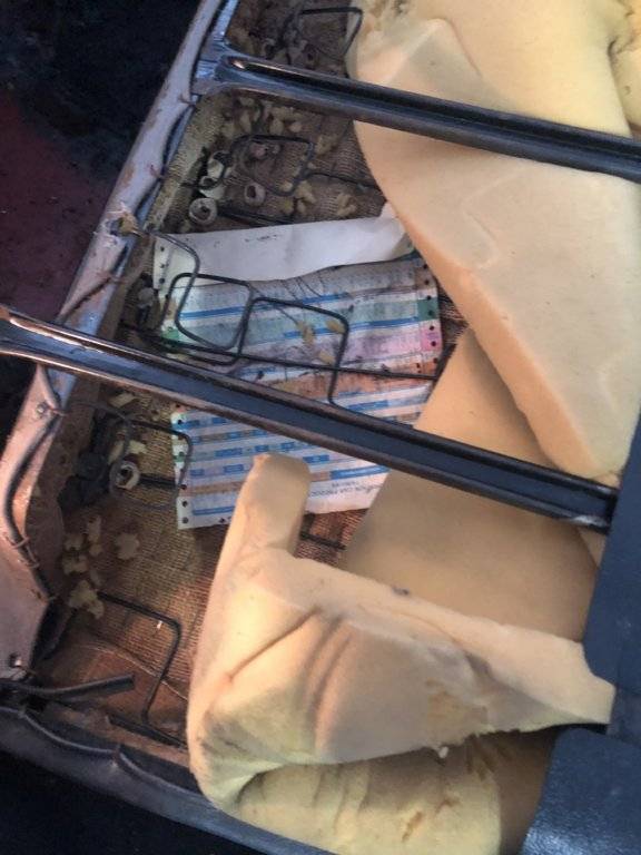

Pulling out the seat back I suprisgingly found the build sheet. I was confident whoever did the half assed back insulation would have trashed the sheet.
And Ta-daaa.

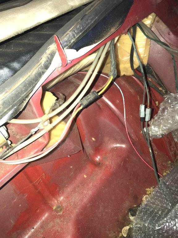

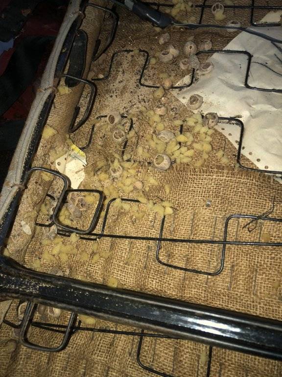

Lots and lots of acorns. Somehow none of the wires are chewed through and the seat isn’t eaten through. I suppose whoever made this their house had enough respect not to trash the place...
The muffler has an awkward cant and tilt. Not normal. I can’t feel any holes. It feels like the muffler is physically making contact with the floor. Enough that I can’t even slide my phone in between the gap.
I think you’ve got these the smoking gun.
