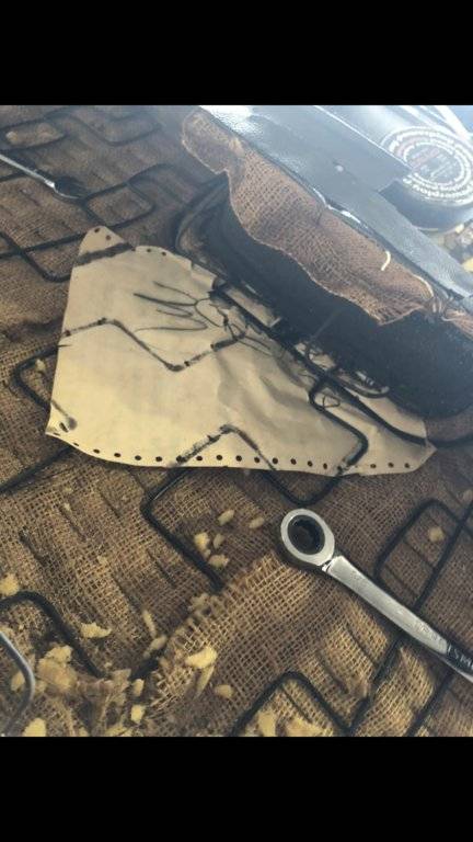

Sounds like you need to carefully go through everything on the car. Considering the upholstery job, maybe replacing the wiring harnesses is a safer option than a repair, you would have lost the car had it been out in an isolated country location and who can say whether the harnesses are in safe condition???
All the best with it once it's all sorted. A quality upholstery shop should be able to save the seat frame, may not be that bad once stripped down and assessed.

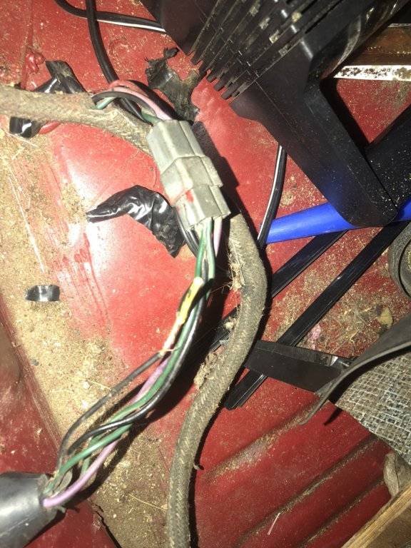

Replaced all the fuses today and trying to work on some of the lighting. The left side park lights didn’t work but the turn signals did. Looks like there was some kind of attempted splice that didn’t hold up. Will try and solder it up and make it better. Rear left marker light is the same way. There are a lot of home made and backyard fixes throughout this car it seems through the years to keep it on the road.

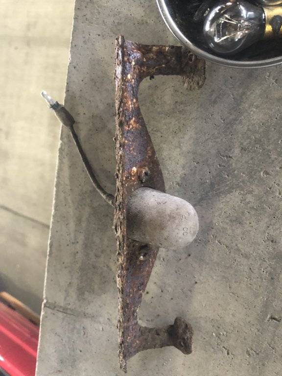

The license lamp is pretty heavily corroded but still has voltage coming through the wires. Will be cleaning up the mounting bracket but will probably just junk it and buy a new repop. This and a lot of small things under the car look like they have been rusting from years. The underside of the car is coated - as I assume the owners in Ohio did but everything else is suspect to rust. It’s obvious this thing was driven hard, through the rain, snow, and put away wet.

I probably have one of those light bulb brackets for the number plate.
You’re probably right. I may pull off the dash and it’s a horror show. In the meantime I may at least bypass the ammeter and do a MAD conversion, at least so so much voltage isn’t flowing through there.

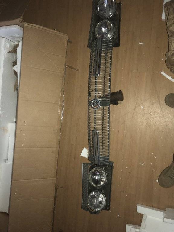

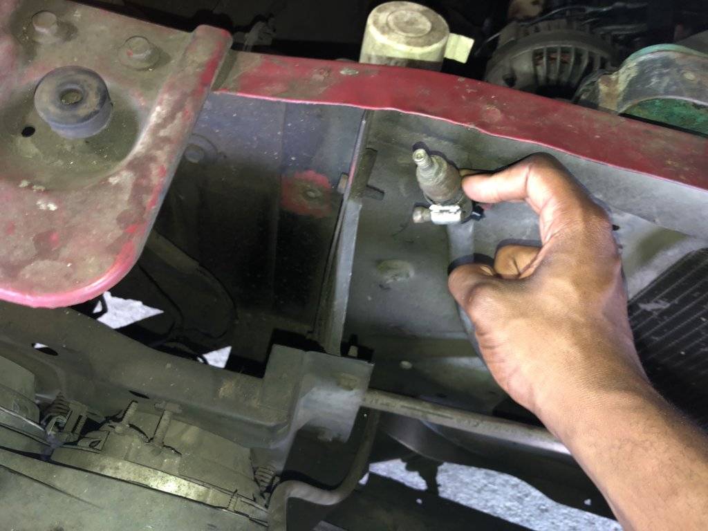

On a side note. I have this 70’ 300 Grille that I will probably end up looking to sell and would like it to go to someone on here. Picked it up from a car the owner yanked the motor but didn’t have the heart to scrap it.

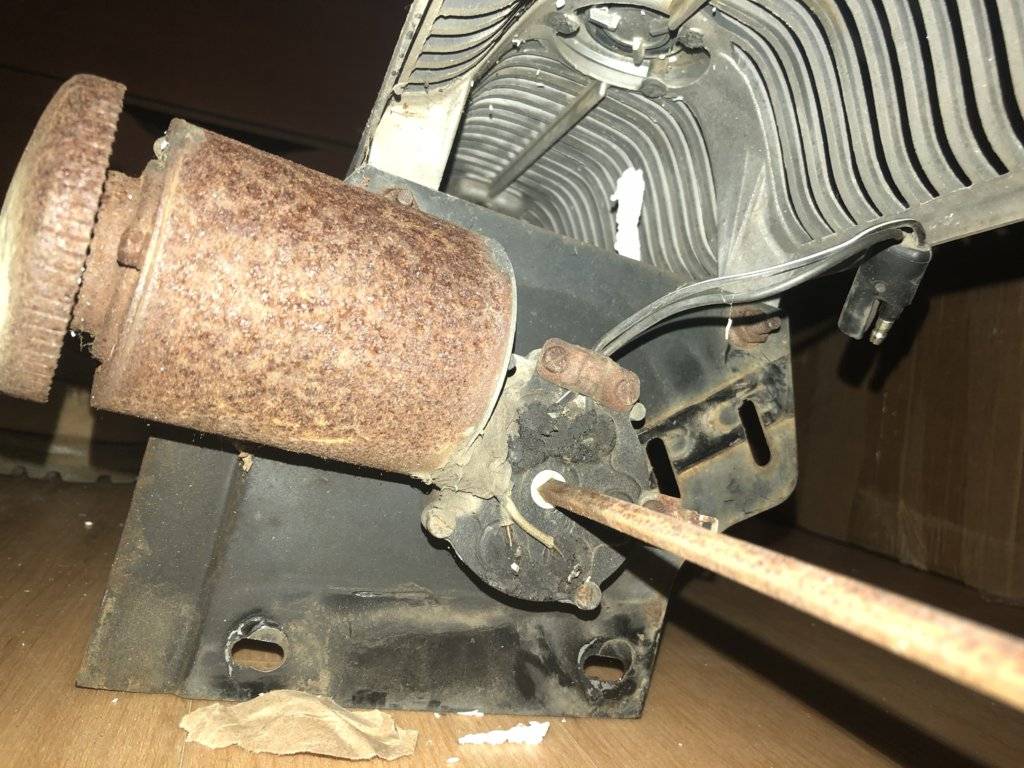

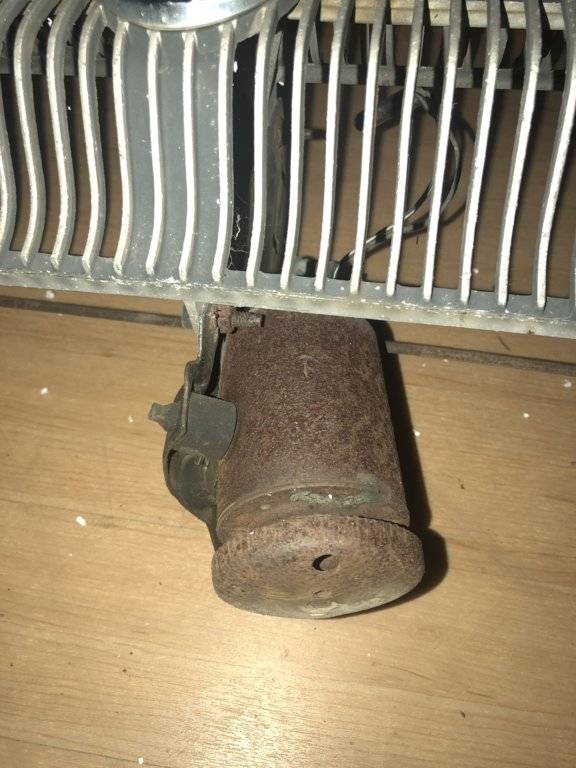

Does anyone know how do I test the motor to see if it will work? Barring actually running voltage through it.
@Wollfen I might have to take you up on that offer. Broke a driver trying to take these screws out after letting it soak all night.
DONT put voltage through it, if you do and make the motor turn either way there are tangs inside that get bent and cannot be fixed, only replaced. I am actually interested in what you have. PM me a price?

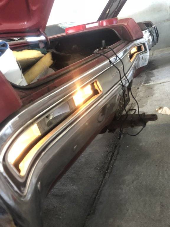

Have started replacing all the exterior lights and some of the interior lights excluding gauges. Using various incandescent bulbs with slightly less wattage and more candle power. Rear end was easy enough. Fought to get the drivers side turn signal open and opening it up I wasn’t too surprised. Looks like someone tried to paint a 1157 bulb amber? Also looks like they tried painting the housing? Whatever the case didn’t hold up well and will be try to clean this up - couldn’t get the bulb out so had to pinch it. Don’t have much faith in this socket working.

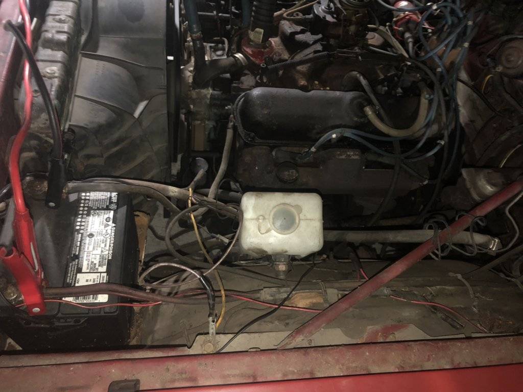

There’s a lot to be done under the hood. There’s lots of uninsulated wires, stray wires, and lots of dirt. Looks like spaghetti. It is however all straight forward and easy to clean up. Not as packed as an Imperial or NYers engine bay.
Finally put the rear seat back in as I have been monitoring the rear exhaust area and floorboard and there is no reason for me to think it would get hot enough to burn anything. Especially since before there was no articulation or room between the floor and the them bubble wrap. Seat isn’t too bad but it’ll need to be redone. It’ll be fine as driver condition. In time.

Nice car glad you got it and enjoy, ditto on the bubble wrap and extra foam, get rid of it.
If your seat isn't comfy enough have it re-springed and re-foamed to what the factory setup is.

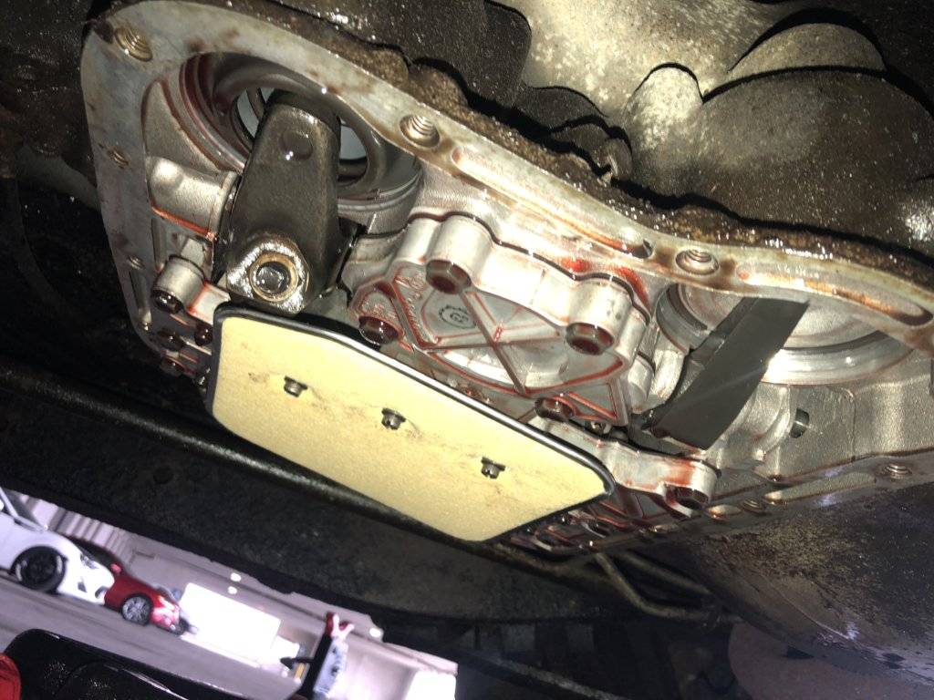

Finally got around to dropping the trans pan. Pretty happy with what I saw. No sludge or discoloration of the fluid. It looked pretty new and still had a pungent smell. Replacing the filter there were very small flakes of metal - and some at the bottom of the pan but there was none circulating through the fluid. Doesn’t look like it was enough to warrant immediate action and the transmission still shifts strong with all gears working. It always surprises me how something so little as changing old fluid can “wake up” a car in its throttle response. It does seem like the Pan has a tiny leak at one of the front bolts. Not excited about dropping it again to fix it but we will see.

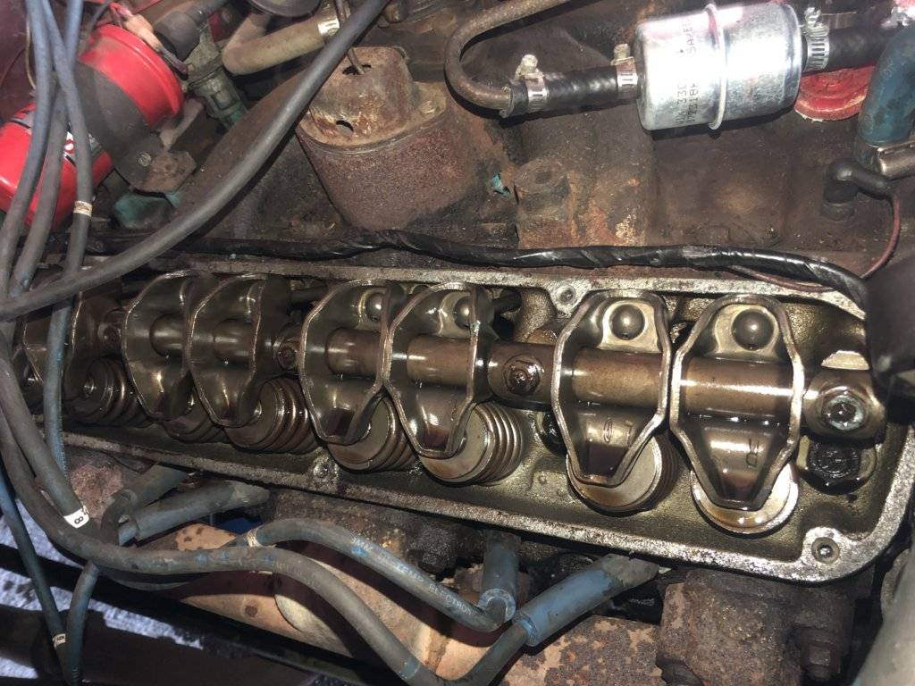

Drained all the oil out of the block and popped the valve covers. Nothing alarming and no gump or metal flakes but the oil was pretty discolored so I’m sure it was passed due on it oil change. Don’t know what was run before so just changed to Rotella 15W-40 non-synthetic. There was a leak coming from the oil filter before so we will see if this one holds up. Replacing the valve covers with a nice rubber set from Edelbrock. The first set valve covers cracked and leaked like hell so I’m on my second set.
The trans are also notorious for leaking at the dipstick tube and at the seal that connects the throttle linkage to the valve body on the left side. The fluid runs down the front and around the pan rail, driving everyone nuts trying to get the pan to seal. Clean it all up first and check the leak before you tear the pan off again.
