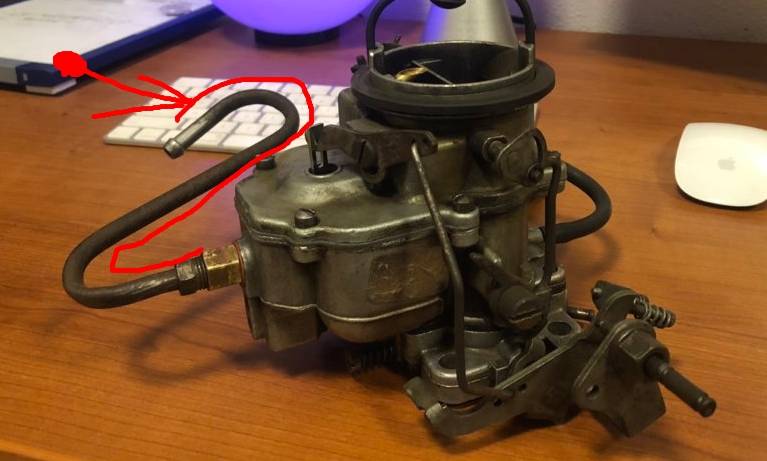

I remember this and is the correct fuel line S-bend.

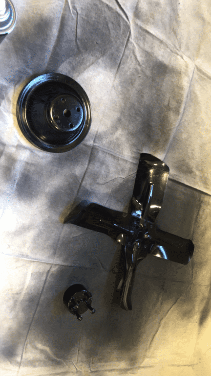

Might as well start painting things if I’ll be trapped inside

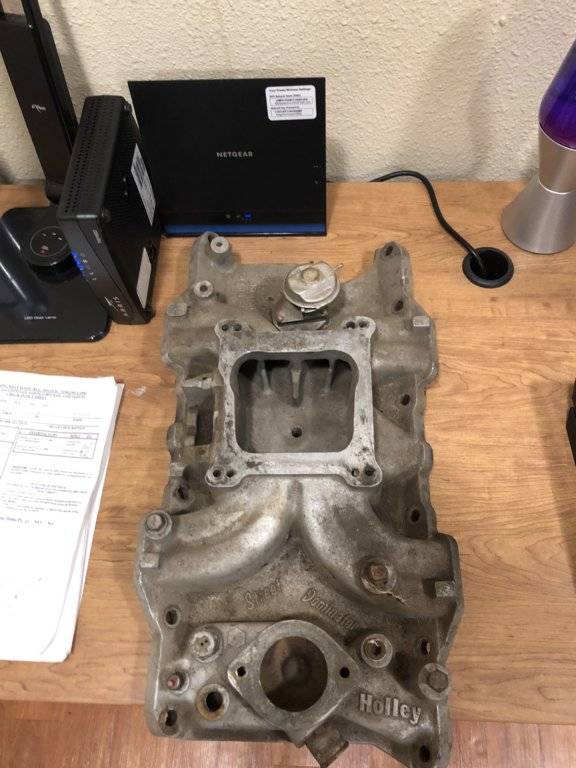

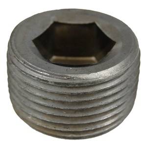

Tap it for a pipe plug of the correct size.
So the EGR passage way feeds exhaust gas back into the system correct? What effect would it have if it wasn’t blocked off. Wasted or lost power?
I might be wrong, but doesn´t any engine run better when it burns fuel mixed with air without already burned gas?

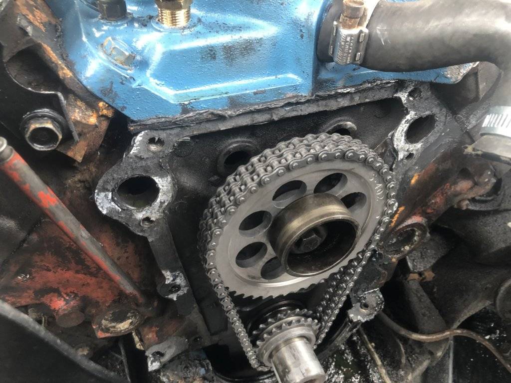

The chain had some slack in it. About 9° degrees of play in it with camshaft engaged. FSM limit is about 8..5°. Decided to replace it while I was in there with a Cloyes Double roller set. Motor has good compression in cylinders. Cam wear is suspected for the mileage. Worked on getting the oil seal in without a press but made it work and sealed it with Neoprene. I’ll have to do an oil change for any material that dropped down into the oil pan.

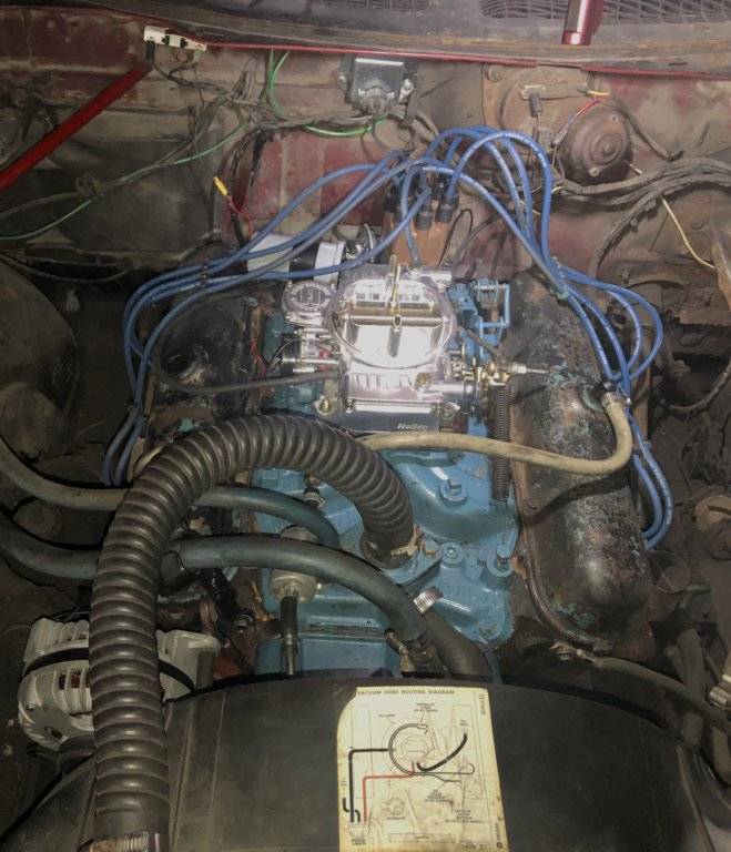

Starting to look like an engine again. Ignition rewired, choke hooked up, Engine on TDC, Dizzy lined up. Block full of coolant.

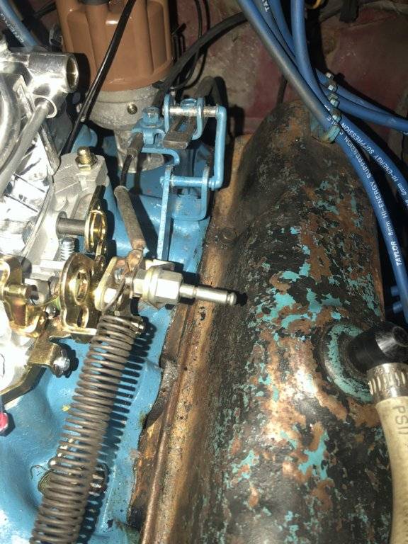

Last thing should be the linkage. I’m able to set up the kickdown, but I can’t get the throttle set up properly. Sitting a bit too far forward.
Possibly need a different or 4V bracket? It’s the original 2V off the old intake. Anything I can fabricate?
In all honesty, your kickdown linkage looks weird. Mine consists of metal rods.
The throttle cable is at too much of a compound angle, needs to be almost perfectly straight. The metal outer casing is getting bound up on the lower section that is why you are not getting any throttle travel.
I’ve been able to mess with it and I’m able to get a pretty good amount of travel with the gas pedal, not quite WOT but pretty close. Do you think I could bend the transmission linkage to get the proper kickdown?
I was able to finally start the car up last night. First time I’ve heard it run since before Thanksgiving. It’s running at an extremely high RPM. Hooked up the tach and it was reading about 2300+. Adjusting the curb idle to the lowest setting is only able to bring it down to about 1900RPM. Disabling electric choke and mixture screws helps a bit more but not enough. What else am I missing? Its got a standard street cam on the accelerator pump and it’s got free travel, not tight. Unfortuentlty I wasn’t able to bench it before I put it on the car but these are usually good for most street applications out the box. Maybe vacuum leak since intake was off?
Disconnect your linkage temporarily and start it again, it has to be a partially open throttle to do that. check the butterflies are closing before start up.
