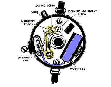

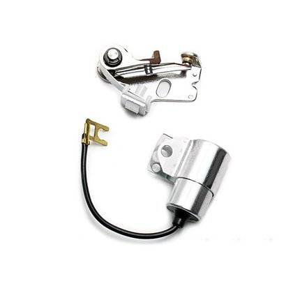

The points and condensor can cause the car to flat out not run/start or run very rough. Here is a pic of the points & condensor looking down into your distributor (assuming no one has upgraded it to an electronic type) and a pic of the actual points & condensor. These have a specific gap/dwell setting. Sometimes the required gap will close up and can effect running, so this can be easily checked or set with a feeler gauge. They do wear out, can get corroded, or develop pitting.

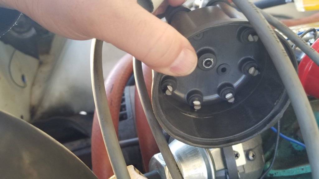

The goo under the rotor might just be some corrosion or grease - nothing I would worry about.
It is still possible you have an ignition problem, but the fact that it idles and then dies does not indicate a spark problem - yet. I would focus on the carb before looking at replacing any more ignition items.

The picture looking into the dist. looks like the points are to far off of the dist cam, leading me to believe your points do not have enough gap, not collapsing the field completely making a good spark. Can you get a picture with point wiper on the high spot, I'm thinking your points slipped or something. Get them up on the high spot and regap them at .017.
I was thinking that last night, looks like someone just put the points in and did not gap them as well. As of now she won't even turn over so charging the battery and going to go buy a feeler so I can set the points like you said
