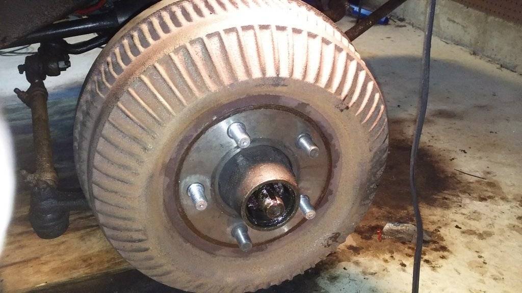

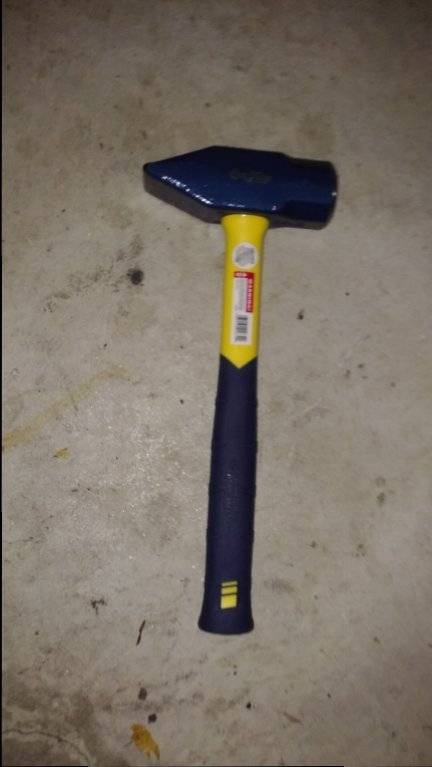

So Murphy shows up today.....
The damn brake drum will not come off. I've tried to pull it, rotate it while pulling it, wacked it, even prayed to it, then cursed it..several times, harshly. It's not budging. Thoughts?
May I assume you backed off the adjusters and removed the bleeder?
On stubborn drums, I beat the **** out of it striking the sides all around to release any contact the shoes have with the inside if a drum.
