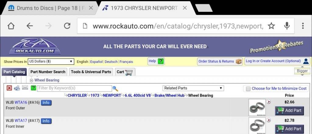

Sorry for confusion. Outer bearing for a '73 Spindle is "A16" NOT "A6", but if you ordered the SET-A16 which comes with the bearing & race, you're OK.
You can also tell which is the inner vs outer bearing by simply matching them t to the rotors hub. Here's a significant difference in size and you can't get it wrong. 5121 is the inner seal.
I'll correct the doc later when I get home.. Thanks to Stan for the Rockauto pic so Gary could be on his way to completing his installation.

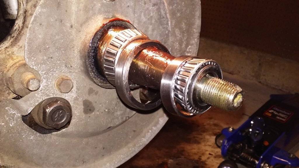

Just checking...bearings shown in right location? (rotor installs in between the two bearings)..the red stuff is lube...or grease rather.

I think so to Tallhair. I just feel somewhat blind while going thru this cause I've never done this before (convert drums to discs) and I don't want to get out on the road and discover I fudged this up.

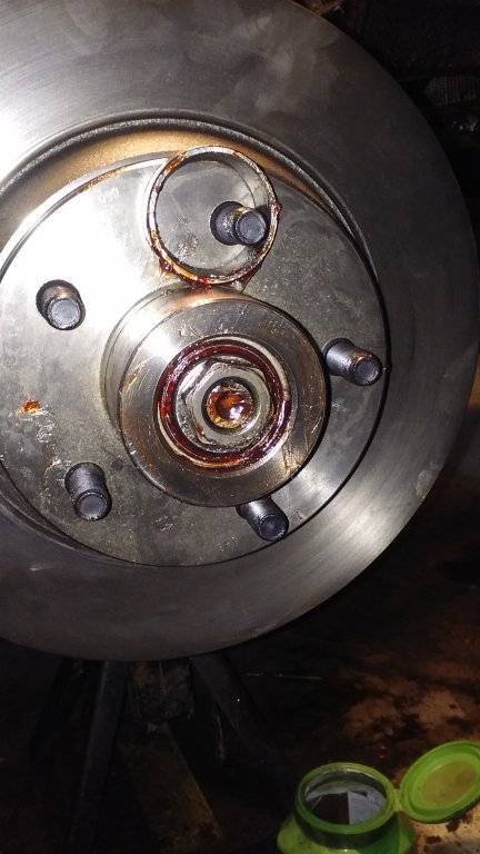

As to "fudging" this up...the "race" of the outer bearing would not fit into the hole inside the rotor...JUST the bearings themselves will. It appear as if there is an "inner" surface already machined inside the rotor hole...for the bearings fit in without the race piece..the rotor seems to spin perfectly...is this not correct? The race just wont fit in there..
