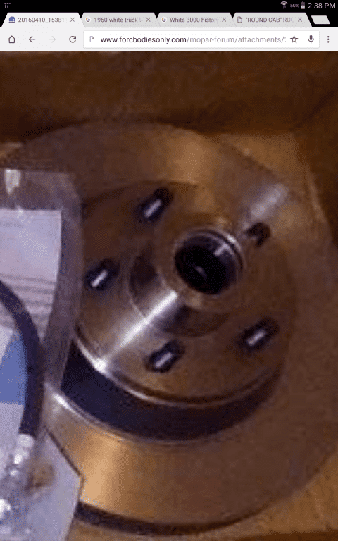

Looks to me like the rotors came with the race installed.
Where did you get them again? You can go back and check the description.
Come on man, take apart the old ones to compare = the stuff in there is the same, only different...(sizes).
Similar bearings, races, seals, etc....

  1. Regarding the rotors and bearing races - I have confirmed that New Rotors DO COME with the races/cups already installed. I changed the instructions to reflect ONLY to ordering the necessary bearings.

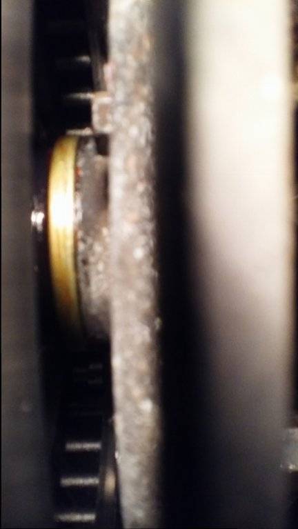

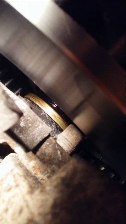

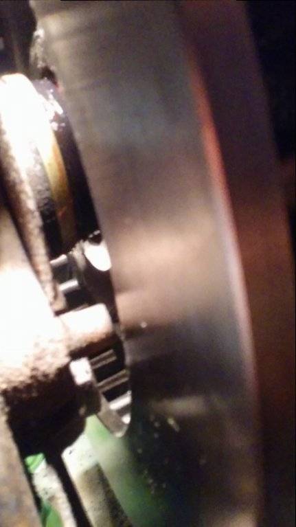

Ok..back at it. I'm sweating details cause I don't want to get out on the HWY and realize I fudged something up.....bad visual. The rear seal is on as are inner and outer bearings, and the rotor itself. Does that seal look as if it is seated properly in there? Next are the calipers......

From your photo it looks like you've got the seal installed backwards.
Did you pay attention to the photo provided in #368?
  1. The seal is installed INTO the back side of the rotors hub.
  2. Place the rotor face down with the back side facing up.
  3. Lay the bearing into the race
  4. Install the hard metal ring portion of the seal into the rotor itself
  5. The rubber part of the seal should be facing UP as you're looking down at the backside of the rotor.
  6. When done before installing the rotor on the spindle, post another pic with the seal installed so we can see what you've done
