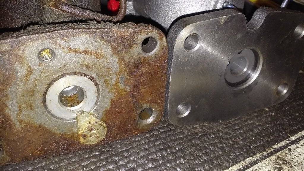

spoke too soon....there is a difference in depth between the two.....View attachment 77137
  1. Can't tell exactly, but is that a retaining clip @ the plunger on the new mc?
  2. Bench bleed the master
  3. Use a tooth-pik or something to measure the depth of both mc's plunger from the FLAT of the base for comparison
  4. Your boosters rod is adjusted for the old mc and you don't want it to be adjusted too short (insufficient braking) OR too long (will hang up your brakes)
Theres no retaining clip on the back of the new MC.

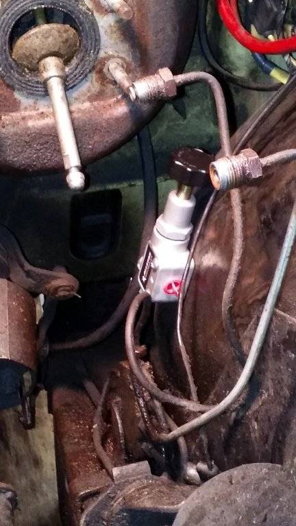

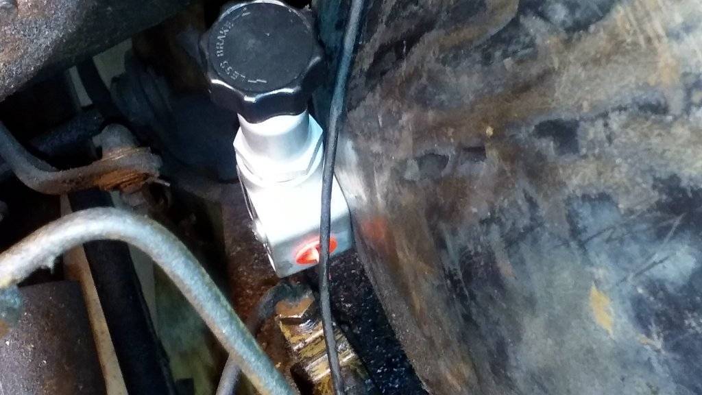

Mount the prop valve in a position where you can easily connect the Rear Brake line to it. You also need to pay attention to where the line from the MC connects to the DB & also the INLET side of the prop valve. You want to choose a position where you'll have to make the least amount of bends.
