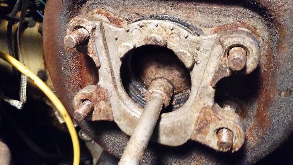

With the way the inlet of your booster looks hopefully none of the fluid leaked into the diaphragm
Looks fairly dry in there....didn't find any brake fluid "puddles". If there were I'd definitely pull the thing out and swap it "JUST" for safety sake alone. Is it supposed to be bone Sahara desert dry in there?

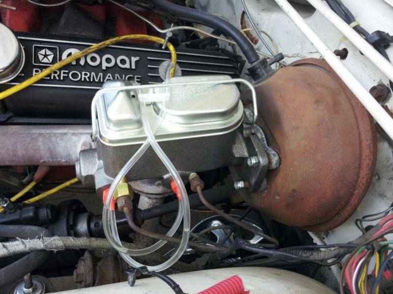

Is this some sort of adapter? It between the old MC and brake booster. The new MC will fit onto the booster w/ or w/out it.

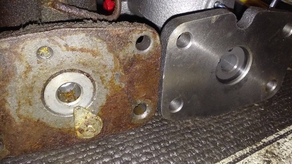

Keeping it or removing it will affect the length of the rod from the booster to the m/c.
Check to see if there is a difference in the depth shown below between the new and old one.
Probably not so I would put it back on if that's the case.
10-4 on both, thx. It's gonna stay. I want everything to continue working the way it was.
spoke too soon....there is a difference in depth between the two.....

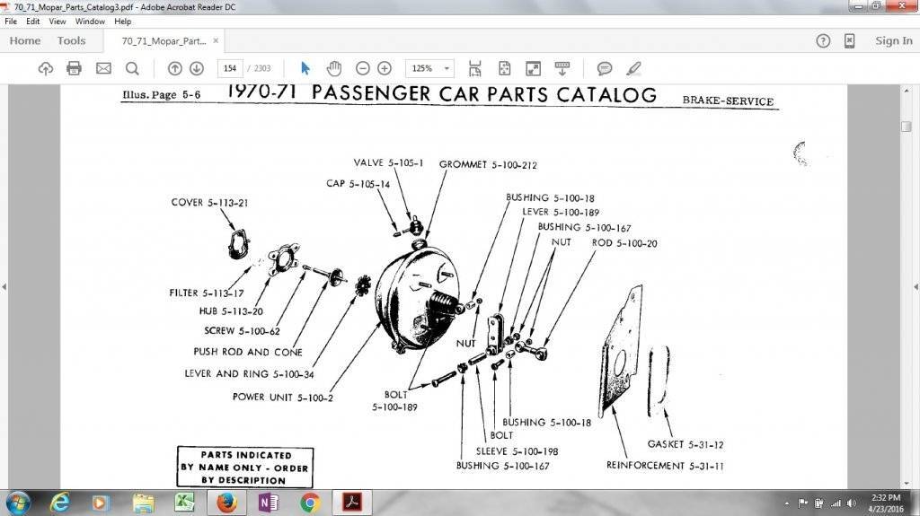

nice. ok I dunno where you are at with the MC, but if it was like what I was workin with, that's a filter and filter holder. put the holder back in, filter is optional. you may find one at the parts house, dude told me to go get a lawn mower filter and cut it to fit. I have no filter there at present.
This is a filter holder?
bro I dunno - if that is a little plastic piece ya i think that is it. ill try to find a pic of what I had goin on.

ok....looks like the same piece I have in there
Not enough difference to matter.
Lookat the depth of the inner hole to the flange surface.
Keep it.
20160423_123703-jpg.77137

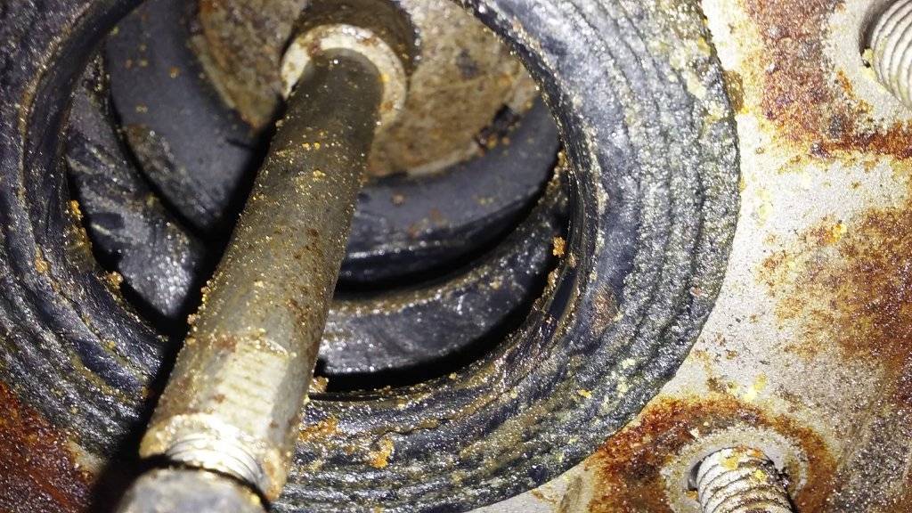

Filter???
What filter?
There's nothing to filter.
That piece is there to allow air to enter the front of the booster when the bellows inside has a vacuum applied to it. The filter keeps the crud out.
