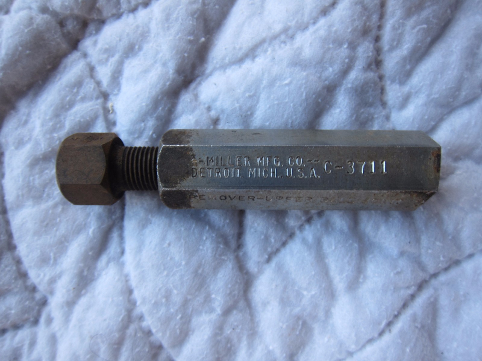

I stand by my Miller ball breaker as the only way to go.

Cool, They work great.Yep. In fact, mine is the the actual Miller tool spec'd out in the FSM. Found it on ebay.

On ebay as we speak...
Remover Upper Control Arm B/Joint 70's C3711 Special Antique Part

I am a believer now! used it lastnight on the driverside and it popped it right off! easier than whacking the knuckle with a hammer.

You need one of these Ball-Joint Separator Tools:
Works great. In fact, the FSM calls for using this Miller tool.
Thank you, John.The 70 FSM calls for C-3964. It's a puller rather than the tool shown.
I'm going from memory here, but I think the way the spindle is formed you won't have enough room to use the C3711.
