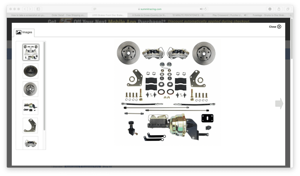

Needing some help with drum to disc conversion. I purchased a conversion kit,
LEB-FC2003-8405 and LEB-RC2001. The problem is the brake booster that came with the kit does not fit. I am on my second or third effort and LEED Brakes says the only solution is to drill holes in the firewall. View attachment 335014
Call a company in Orange California called ABS power Brake inc 714 771 6549 they do custom system parts and should be veey helpfulNeeding some help with drum to disc conversion. I purchased a conversion kit,
