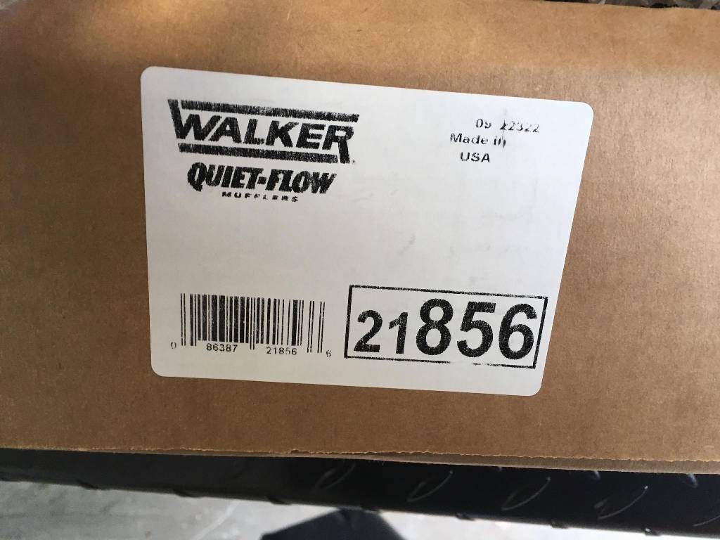

Big John, you have posted my shinking brain is not seeing it. What were your muffler part numbers?

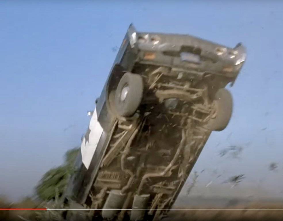

There is a short scene in "Sugarland Express" of a C-body cop car idling, I have been trying to find a clip of that scene. The scene is when the cops are waiting in a small town for the kids to order chicken, evening.
Just came to mind that it was a great shot of original duals and sound.
Walker 21856
I think I searched for 1968 caddy or something like that.
There is a short scene in "Sugarland Express" ...
Coincidentally, I watched Sugarland Express in just the last few weeks. Make sure to get the copcar sound and not the mid-50s Buick sound!

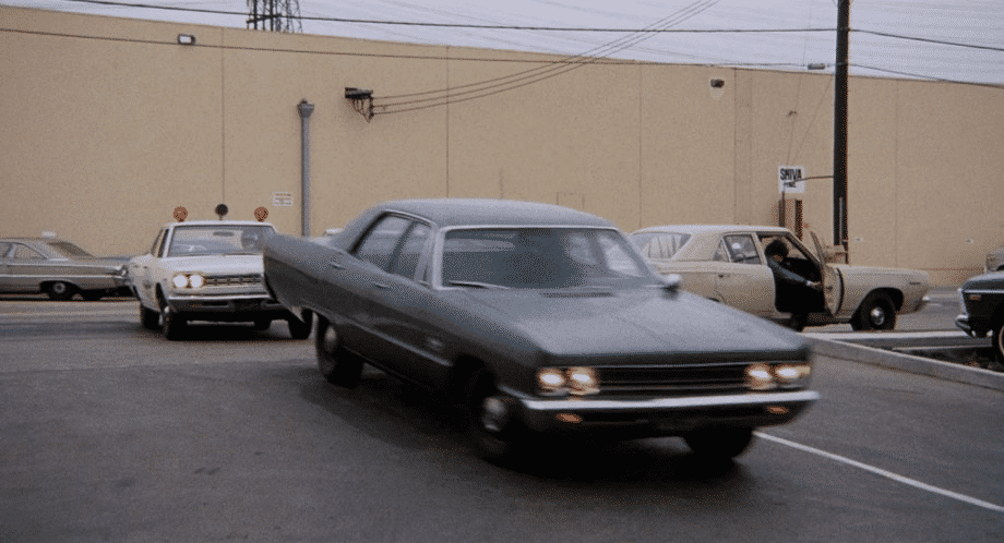

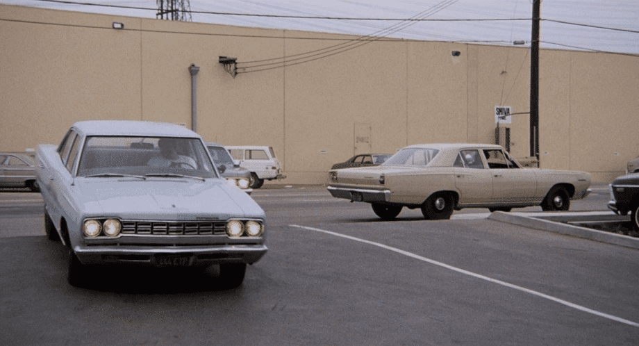

There's also a good note in Gone in 60 Secs (the original) when they are setting up the policecars at the Mazda car dealership.
And also nice soundclip nearing the end of the The Shawshank Redemption as the copcars float by.
The Fury is either a 3 or a VIP, neither of which are likely to be a marked copcar.
But more importantly, there's a flaw in said Fury - who can spot it???

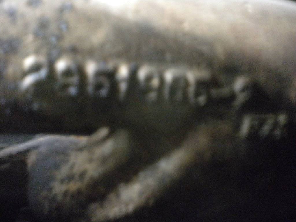

It's 'known' that the driverside B-body manifold (rear dump) fits on Slabs (some if not all) but I haven't heard of the fitment into a Fusey.
What do you have?
The B-body manifold is the same as C-body for at least 1 of the casting #s.

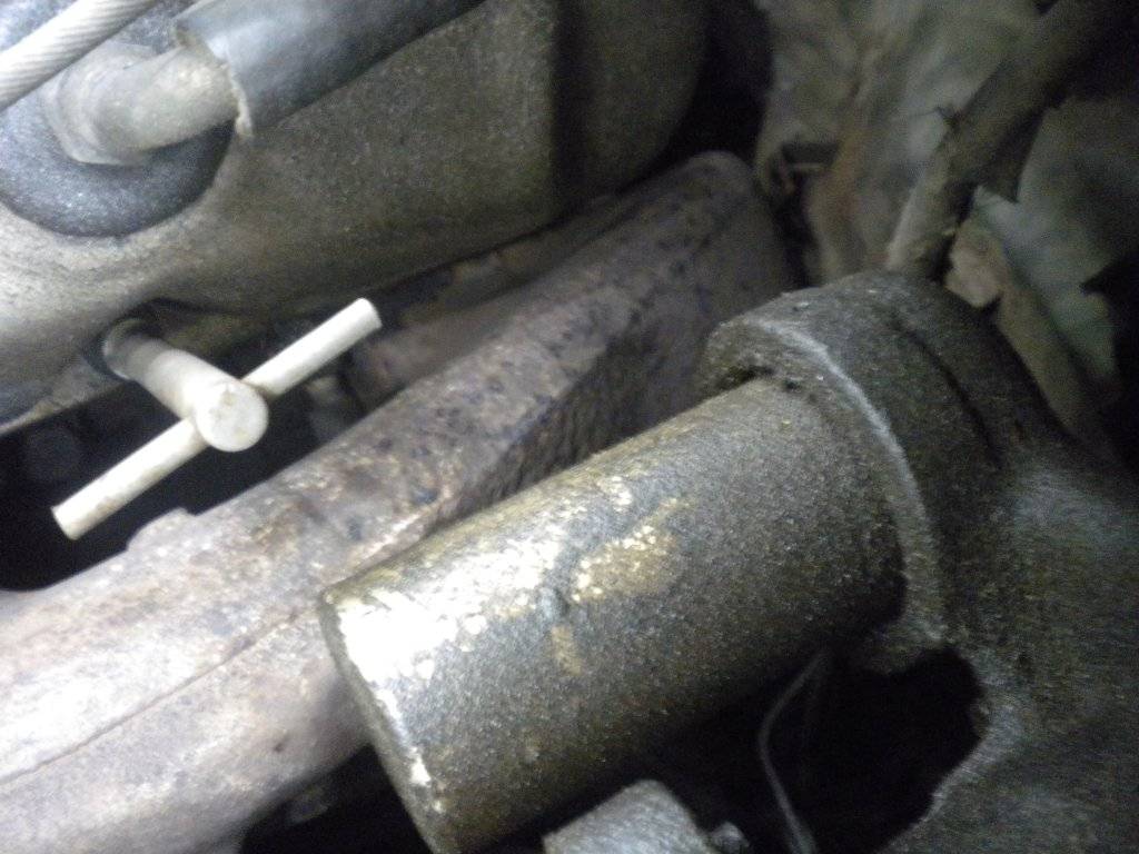

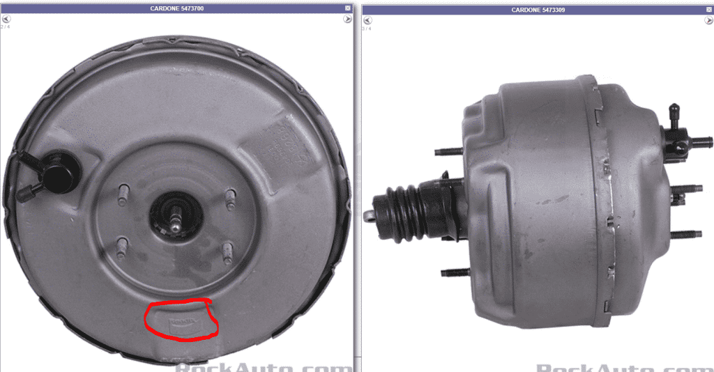

I installed a left side 73/74 B body HP exhaust manifold on my 72 Polara with a 440, it hit the Bendix booster so I swapped in a Midland Ross unit from a 73 C body wagon to gain the clearance I needed.
that is what i have. vehicle is '69 newport with 440. thirty years ago.
Ah, a Fusey with RB and B-body HP.
Does your steering column have the thick rubber coupler?
Did you install teh manifold when it had a brake booster? (or only with hydroboost?)
The booster on teh left is the one that interfered, and is the one on the right the one you switched to?
the manifolds were installed with the o.e drum brake booster in place. disc brake system from '69 new yorker was installed some years later. hydroboost and rear discs were the last modification to the car. done in '00 with parts from my lincoln, wrecked 12/'99. steering box and column are original to the car, '69 newport.
