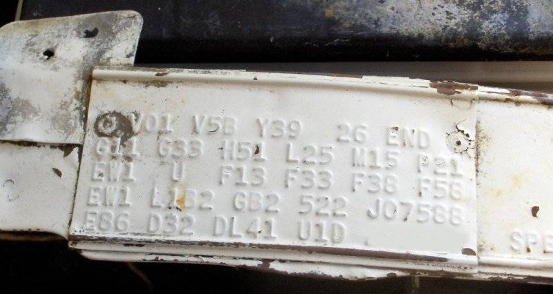

You are correct, in your Polara example the ** would indicate the body type, the "T" would be the standard 440 engine it came equipped with in either year, (it would be a "U" code for either year if equipped with the HP 440 with dual exhausts) and the 0 or the 3 would indicate the model year of the car. My assumption was that someone would know the year and body style of their car. In the interest of being more specific, the first code on the lower line of the data plate on the '69- '73 cars or the 5th digit on the '70- '73 cars will tell you if the car was equipped an HP engine with factory dual exhaust or not.

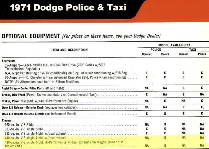

Here's something of interest. It's from the 71 Fleet book.
I know there are mistakes in the book but there is a '71 Polara/Monaco 440 dual exhaust application listed in the 70/71 parts book. Were dual exhausts limited to only police cars? Research continues.
This topics shows why is why it is SO important that any documentation be saved from cars that are parted. Fender tags, window stickers and broadcast sheets help answer questions just like this. Once the documentation is gone...it's gone forever.
