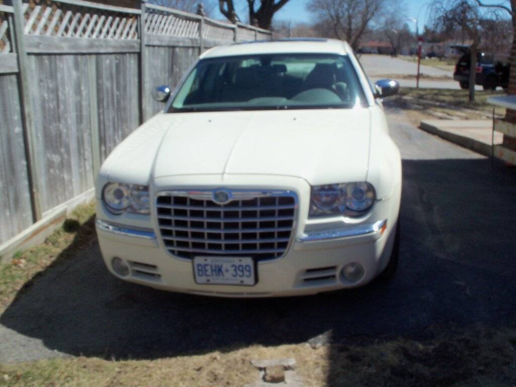

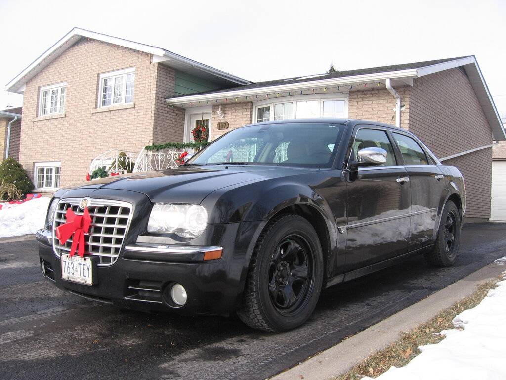

I am on my second 300C with the 5.7Hemi.
Love these cars! Excellent daily drivers and long haul cars with all the creature comforts
Never had any issues with the engines.
