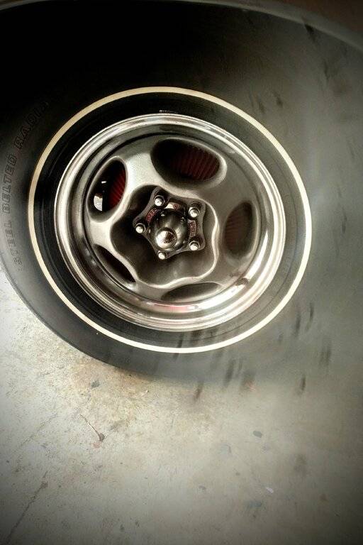

You can roll-your-own narrow whites like I did. Paid about $125 a tire 3 months ago for these Coopers.
How did you "roll your own"? I was thinking that an alternative may be permanent whitewall stickers from somewhere like tirestickers.com (Canadian site tirestickers.ca ).
Veering a bit off-topic, what car are those Spyders going on?

Choose your favorite method to spin the tire. Take a piece of 80 grit sandpaper and hold it against the inner diameter of the whitewall, choosing how much of the whitewall you would like to remain. In my case, I cut the whitewall down to about 1/2 it's original size. Sand until the raised portion of the whitewall becomes flush with the rest of the inner sidewall. (Probably about 1/8" ). Move on to a finer sandpaper, such as 120 grit. You'll find the rubber actually sands like wood.
While it's spinning, use a brush to clear the rubber crumbs. You may want to stop spinning and check your work. Get it spinning again and use a spray can of black FlexSeal™ to paint the area you just sanded. Likely it will also get on the area you want to show, but no worries. Allow to dry.
Once dry, spin again and gently touch the remaining raised rubber area with the 120 grit. The black will sand off, leaving a nice sharp line.
Fini
About $7 worth of materials.

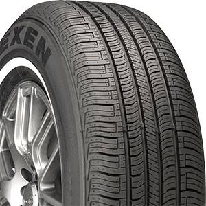

I just realized that America's Tire Company now offers a Nexen 235-75-15 in a whitewall and an XL load rating of 109S XL, which is even a higher load rating than the former Hankook Optimos which I recall were a 108S XL load rating. So I will likely order a set of these to try them out. I even like the sidewall much better than the Hankook name that was too large and suggested foreign made at the outset - not cool for an American made old full size car even though they were made in Korea like the Nexens, not China which is a plus:
NEXEN TIREN PRIZ AH5235 /75 R15 109S XL WW
Item #3328550,000 mile warranty$96.00/ea

I have noticed that Korean parts are usually significantly better than Chinese parts. When I bought Dorman replacement power window motors made in Korea they held up well and now the Dorman power window motors are made in China and I have noticed reports of installation problems and some instances of failed motors now. Ugh!

Interesting. They also offer them in 225/75R15 but the load rating is only 102S.

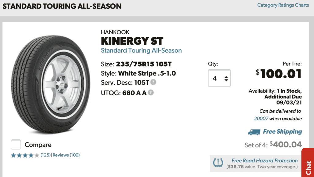

I just bought another set of Kinergy ST in anticipation of a possible car deal.
They were the last set of 4 in stock at the Tire Rack. Granted, they are expected to be back in stock on Sept. 3, but these days it seems supply chain issues are everywhere, so I decided to play it safe and get them already.
PS: they are $10 more expensive than back in April, when I bought a set for my 1970 TNT 'vert.
