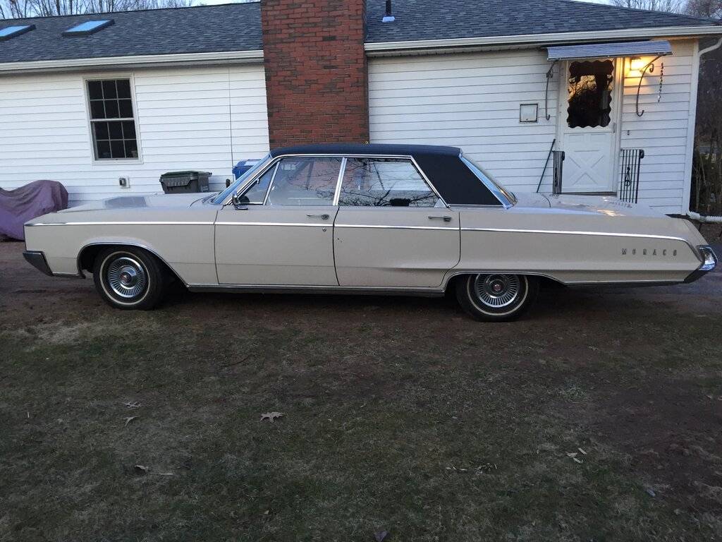

Yes absolutely. Got her on the parkway and found the speedo was now almost perfectly calibrated. With the old 205/70R -14” tires, speedo would read 65 mph and car was actually only going about 59 mph. Now at 65 the car is going almost 66 mph. I use the “Waze” app to check it...not perfect science but close enough.
The old tires also had flat spots from sitting so long and the ride was not enjoyable. I purchased some new 7” wide “Pacer” brand rally rims from CWO which I’m happy with. Unfortunately not original equipment of course but worked out terrific. The hubcaps hide the rims. I do the two hour commute from Connecticut to New Hampshire once a week and feel much happier!

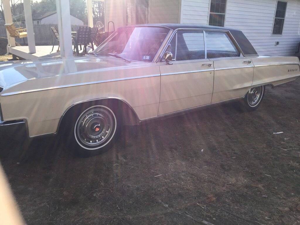

I just purchased 5 new 15” rims and 5 new Hankook st 235/75R-15 tires for the ‘67 Monaco.
World of difference!
(attached before and after photos)
Also found some decent driver quality 15” hubcaps on eBay.

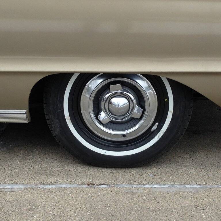

Toyo Extensa A/S 225/70x15, $92 each purchased at Belle Tire. Also available at Walmart.
I put them on 7” wide rims, which is the trick. A wider tire pinched in a narrower rim will not look as wide as these in the wheelwells. And the car corners much better.

I really like the hubcap- what is it from?
1965 Dodge Monaco. I believe these were Monaco only and used just one year only. I dig them too. Enough I resisted the usual Magnum 500 wheel upgrade.
1965 Dodge Monaco. I believe these were Monaco only and used just one year only. I dig them too. Enough to resisted the usual Magnum 500 wheel upgrade.

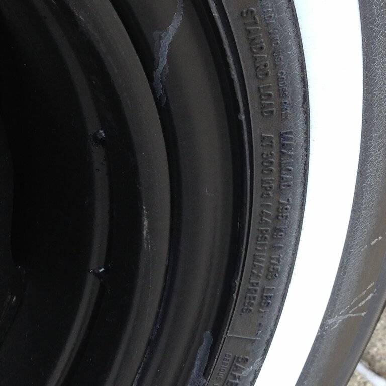

Good call! You’re right.
I had new 15” rims made 7” wide modified to accept 14” wheelcovers.
See that 1/2” wide bar tacked in the rim.
The guy I used took brand new steel rims and welded in 15” mopar center sections to the backspacing I specified. Cost was near the same as a new set of 15”x7” Magnums with all the caps and lugs, but I prefer the stock look.

The mutts at Belle tire aren’t used to mounting whitewall tires. They actually asked me if I want the white facing inside or outside!
