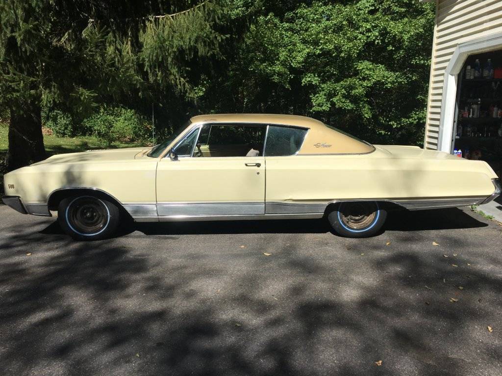

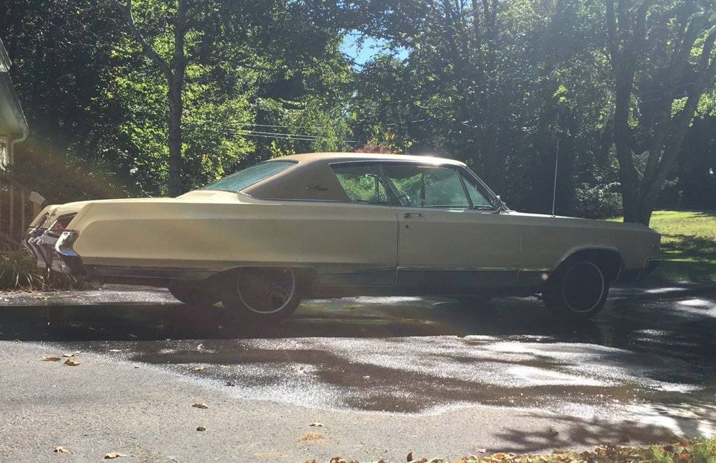

Welp, richened up the carb and threw a lil more advance at her. Still feels a tad hesitant to me but I'm not sure. I have to bear in mind that I'm dealing with a 4500 lb car with 100,000 on the clock that was in no way intended to be a performance car. All that said, cruises along at 45 quite happily.
Steering ain't that bad either. Bumped the ride height up a bit (could use more) and a lot of the right favoring tracking went away... more so when under power which makes me think it just needs more.

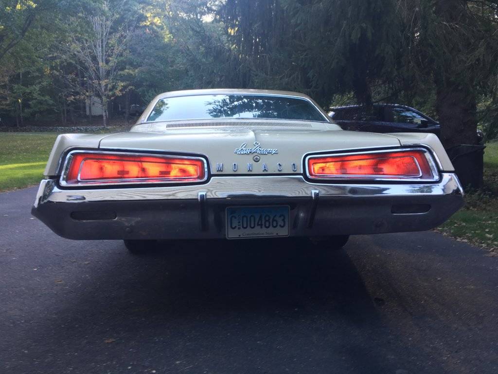

Nice weekend of tuning and driving. Found out that my heat and AC work .. only issue being the thermostat as she doesn't make much heat.Was just going around the neighborhood, not really breaking 55 then got ballzy, dropped the ride height just a smidgen and took it on the highway. 75 was no big issue, floated along and tracked nicely. Something is definitely off about the kickdown linkage, I've not matted it but it doesn't seem to kick down when I think it should. After the highway run I got her up on a jack and my passenger side wheel bearing was loose. Going to have to replace the fronts next weekend and replace a bunch of bulbs in the tail lights .. I think I have one on each side which just don't look right .. and, er, is pretty unsafe .. and against the law.
Atta girl! Rid her of a poorly wired third light and replaced them bulbs. Now to deal on them pesky wheel bearings.

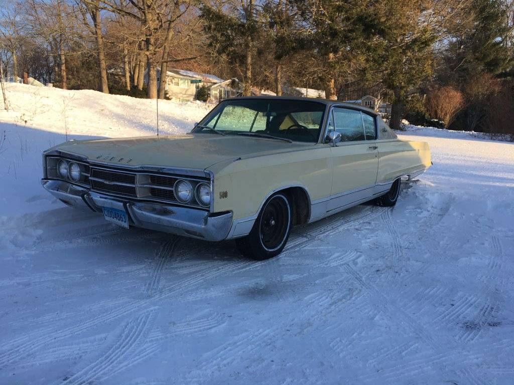

Welp, probably the first snow she's ever seen. Gonna have to sit out all night and day tomorrow as we are finally getting new garage doors. Haven't started her in a month but tho its about 15 below with windchill, she fired right up.
We're both very excited for spring!
