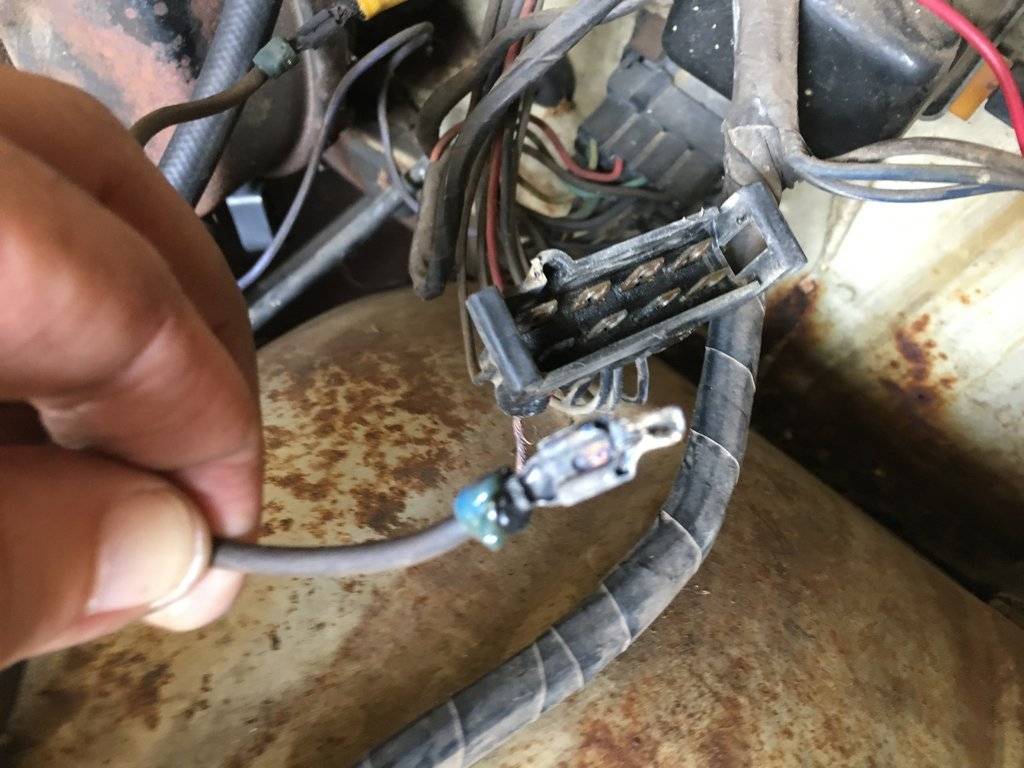

Well guys, oil pressure I gots. But I also toasted the **** out of my bulkhead ahead of my fusible link. Not sure where to go with this one. It appears to be a crappy connection with tired old wires but the connector itself ... don't know where to go for that... any ideas?
Wow, just read the whole thread. You've really been going to town. Great job. When you put your bulkhead connector back together I'd put some De-Oxit in it.
Yep, they all need a really good cleaning. I kind of fudged a male connector into the boot out to the fusible link just to get power. It'll do until she's running anyway.

Seems my intermediate bulkhead corrections are holding, everything stayed nice and cold during cranking... save for the + battery cable which was a little warm.
