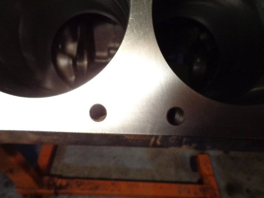

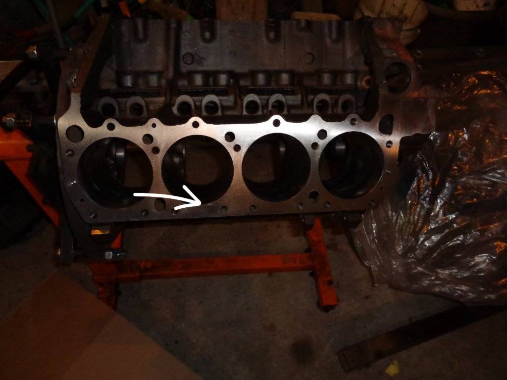

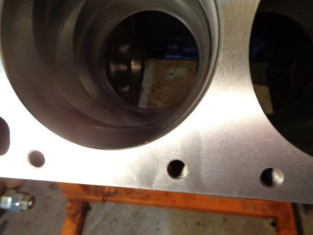

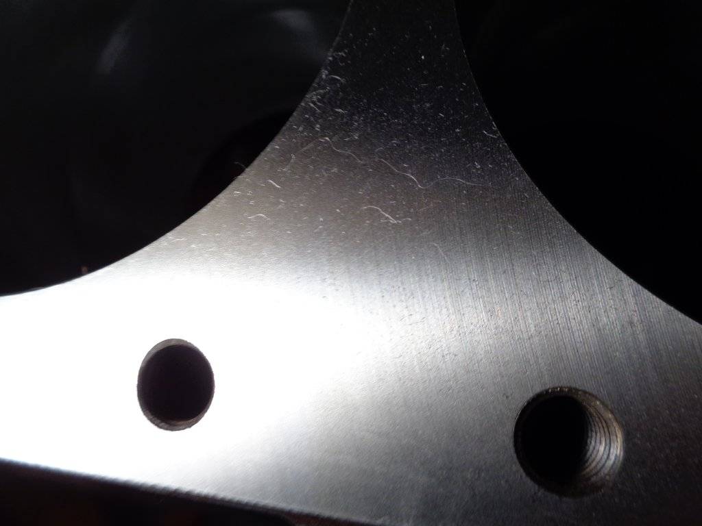

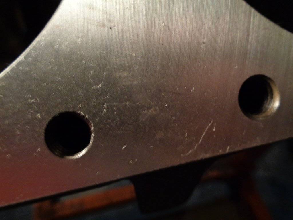

I was surprised that you said they cut the decks .010". The reason I mentioned the deck was what appears to be a gouge indicated in this pic.
Kevin
if the pistons don't have valve reliefs your going be about 9.65 compression about right for iron heads. for alum heads that is going to be on the low side.
I didn't read your post right. i thought it said .010 deck height not that you cut .010 off the block. so where are the pistons in the hole or what is your pin height ? you need to know what your compression is going to be.

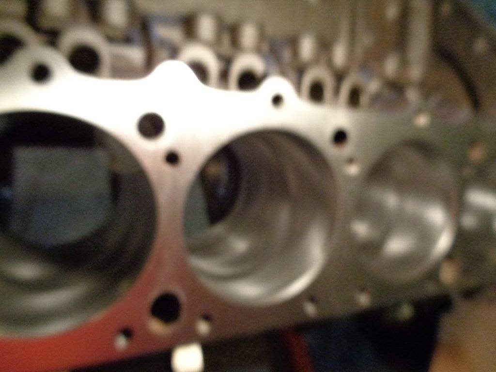

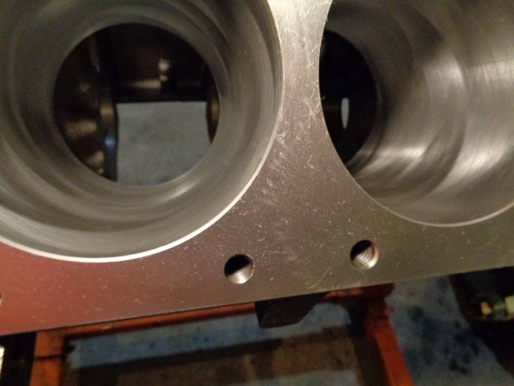

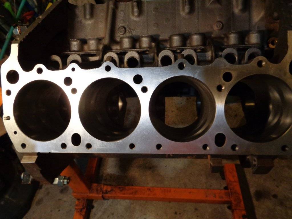

yes he true'd the deck and it was about 10. the light was playing games I'll post some pics in a bit, just in the middle of painting
This camera doesnt seem to like to play with this light or something.

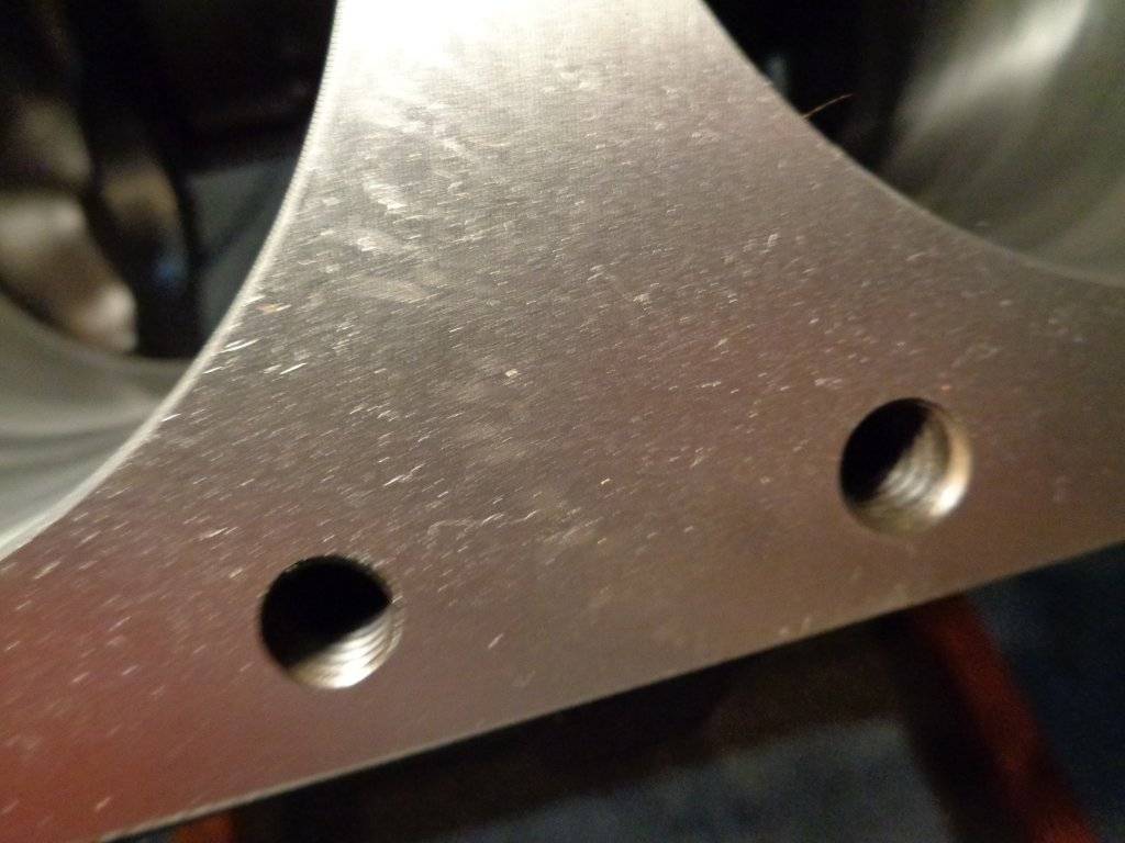

I see some lint and I think the shop coated the surface a bit. I will wipe it down with acetone I guess on build day.
does it look ok? hopefully its a good enough surface for steel shims like the factory gaskets?

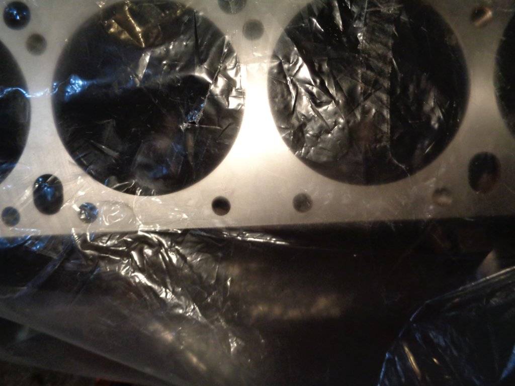

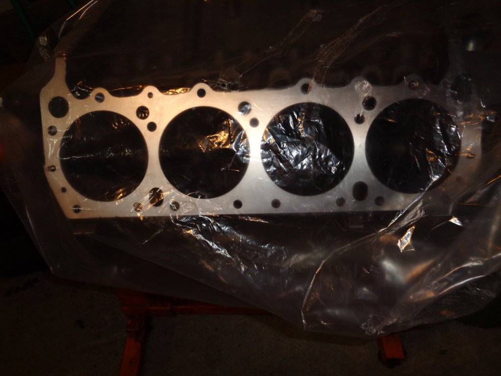

I would not run the factory steel shim head gaskets with the alum heads on an iron block.
well thats the issue. I have stock 516 heads that need to be rebuilt or buy stealth heads. Its gonna be a small fortune either way
I'm running rebuilt 516 heads on my '66 300 440. Also running a dual pattern Comp cam that somewhat accommodates the 516's smaller exhaust valve. Throttle response is fantastic and the engine has really good power.
to run the alum heads you should have about 10.25 compression. if you have lower compression with that good size 230-236 cam and bigger port heads you will have no low end torque
