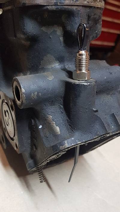

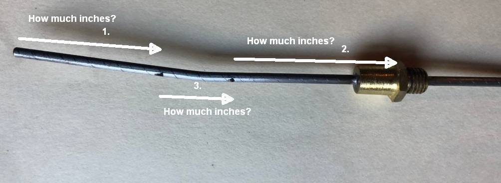

I measured the oil when filling my empty system, but after my seal leak and a leak at the sensor well , I made the dipstick to
Yes Trace, the tiny ball was on top of the spring.

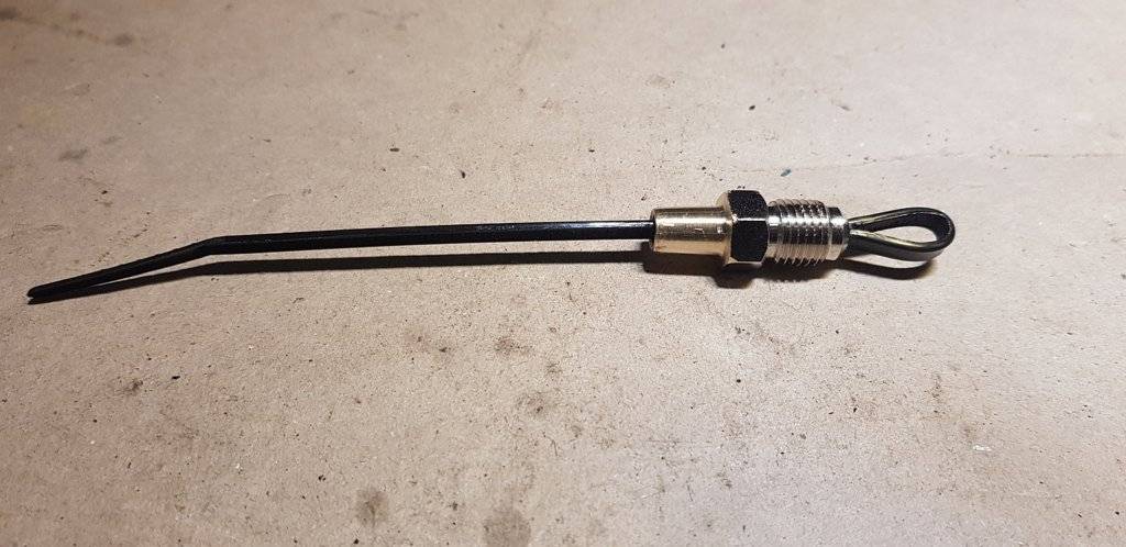

below a picture with the dipstick I build with your help. Thanks.
The stem is a cable tie I glued in with epoxy resin.
The overall legth of the inserted dipstick is 4 3/16" as described in the 1970 Chrysler Manual, right?
The oil level is where the the gasket is, right?
Yes, the total length is 4 3/16....mine is 1/16th shorter....for no reason other than that end of the stick doesn't matter for our measurements. It could be 1/2 inch shorter and not matter for the measurement of the oil level.
As for the oil level being at the gasket, I have no idea and I doubt that that's significant. If your sump is still apart, pour 10 oz of water in it and educate us all.
All we're concerned about is the range marks that I showed on my pic above, as that's the acceptable range just like on your engine's dipstick.
As for the dimensions you requested, 1) is 1 5/8ths, 2) is 1 3/4s, and 3) is 3/4ths, giving a total length of my stick of 4 1/8ths....1/16 shorter than the FSM. On my pic, the lower mark indicates 6 oz of oil, the upper mark shows 8 oz.
The oil is so very clear it's hard to read on the dipstick. Maybe the tiny notches in your zip tie might be helpful to see where that oil lever is, like we often see on an engine dipstick.
As Dave said, your best bet is to load the compressor with 10 oz of oil, and a half oz of dye. If there are no leaks once you're charged with 406, you never have to think about that oil again. I made the dipstick because I had some leaks and needed to double check that the sump had 6-8 oz of oil in it when I had the system discharged.
