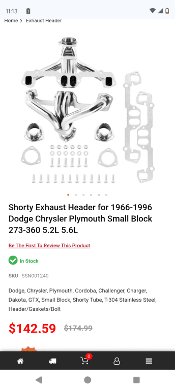

So I'm going to be swapping a 360la into my 66 furyIII and as far as I can find Schumacher is the only place that has headers that are supposed to fit cbodys but they are kind of pricey. I was thinking of getting block hugger short headers I'm sure they'd fit and they are quite a bit cheaper. I was wondering if any of you guys had gone that route Im sure you get what you pay for just wanted to see if any of you guys had any input.
The block-huggers might hug the block and bolt-up to the cyl head, BUT will they clear the steering box and linkage? THAT is probably the reason the Schumachers are expensive?
Look in the website catalog for the block huggers and look at THEIR application list, for good measure. Checking price, too.

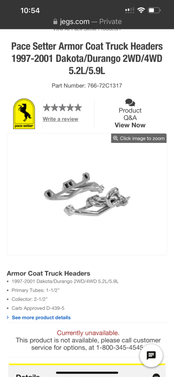

Dakota headers fit.. you might cut the dropped area on the #1 cylinder and flip it over to clear steering box…

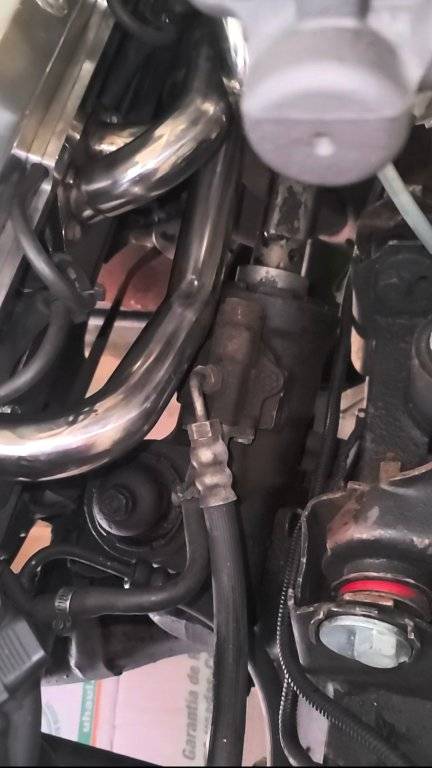

Yeah between the Power steering valve and the #1 pipe... i have about 2 credit cards worth of a gap. Sometimes I can hear it hit slightly but so far no real issue.
I also tried wrapping them and it looked like crap so I removed it. Wrapped my downpipes and then instantly scraped through haha. I do have a hard time getting the flange to stay sealed I have to say.

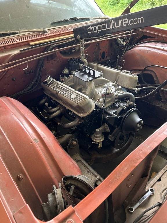

I tried a set of those inexpensive block huggers on my '61 Newport, 361, standard trans. They did fit after a few "modifications". The pipes did need to be dimpled. I found it necessary to use the short sparkplugs to increase clearances between the plug, wires, and header. I also had to shave a small amount off of the control arm where it comes closest to the engine, in order to slip the header past it. It amounted to rounding off the extra stamping metal, but still,...a pain. I am waiting to see how they stand up over time. Perhaps the narrower 360 will ease some of that challenge. Best of luck.
