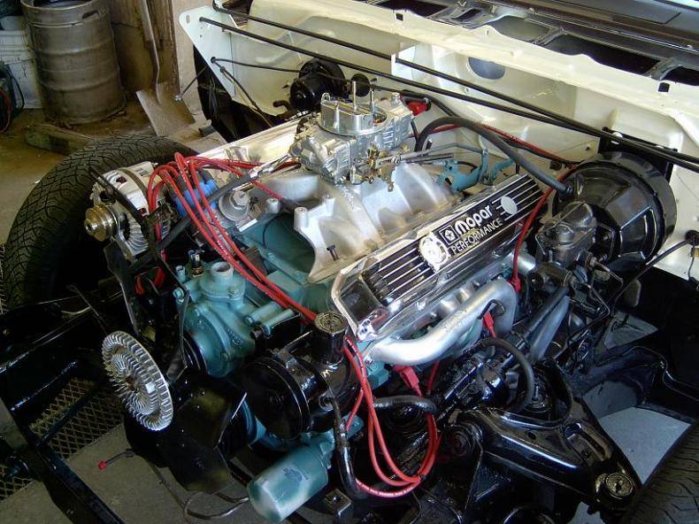

This is a moderate 440... Low to mid 220's @ .050" with 906s that I ported. It has full 3" exhaust and sounds really good.

A 383 may not have the need as much, but a moderate to strong running 440 will definitely utilize the ability to breath properly.
