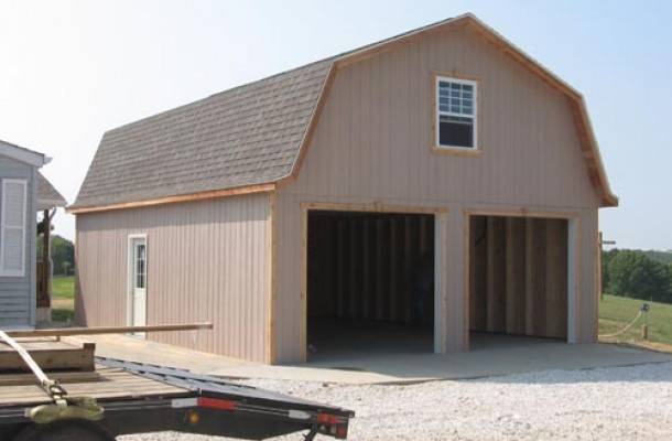

Well Rip, I have plenty of time to consider it. My current thoughts are to build a structure along this line. Except that I want two doors in the long side and one in the short.
We've got a lot of mills around here that you can buy hemlock direct from. It would have a nice high ceiling. There would be both inside and outside access to the loft. I also have connections at the local rebar shop, I worked there for 6-1/2 years.

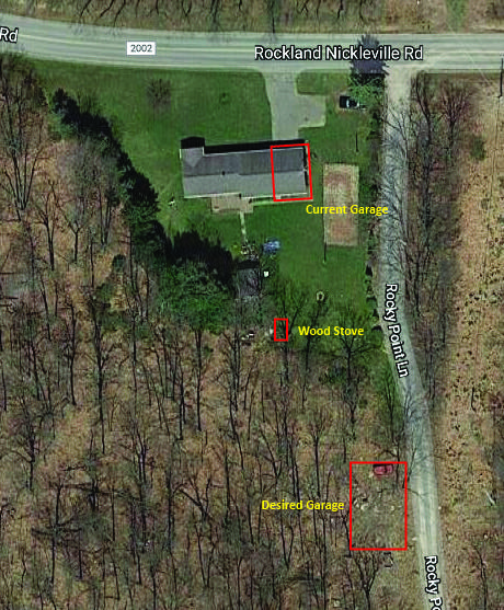

Here's a layout of the land.
It looks pretty spread out, but really it's less than 100' from either the house or the proposed garage site to the wood boiler. When I had the property timbered a few years ago I had the landing strategically placed just so that I would be able to use it for a build site later.
I need to replace the deck on the back of the house this summer so I'll be making provisions to bring in the water lines from the boiler. Even though the the lines for the boiler are usually run in 4" pipe I think I'm going to pipe a 6" pipe in place so that when the time comes I'll be able to run the water lines with easy. This may also be how I get power out to the other garage - I'll see when I get there. I don't necessarily want another meter.

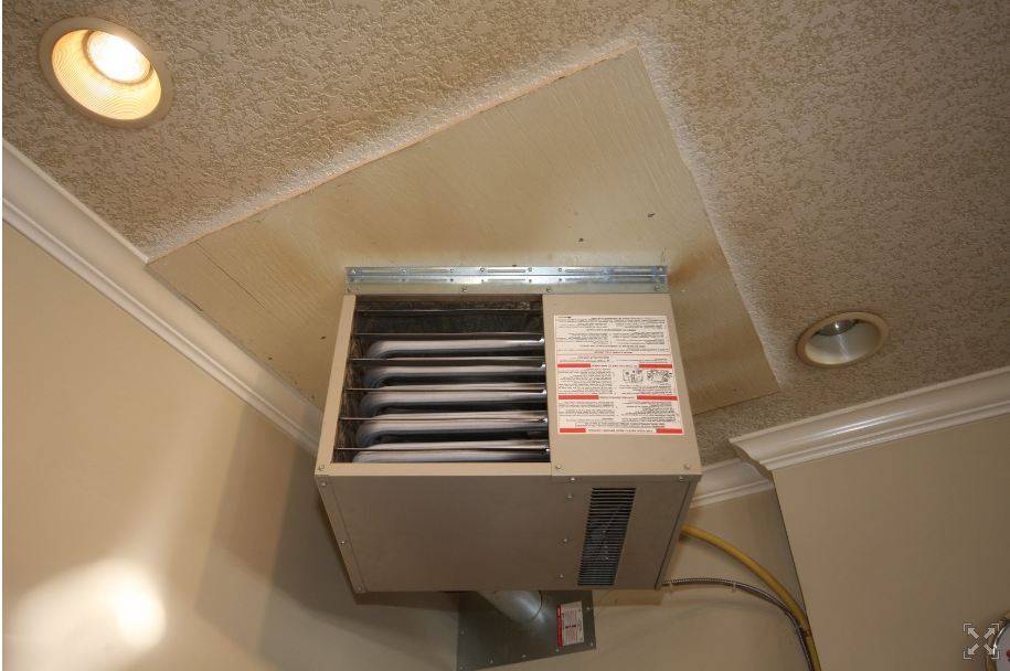

Three car attached to the house. Insulated walls with weather strip around the two overhead doors. The doors are not insulated. The furnace is mounted high in one corner. I keep the thermostat at 50F unless I have big job for which I'll crank it up to 70F. Today it's sitting at 50F while the outside temp is -25C (-13F) and the furnace isn't working very hard to keep it steady.
The furnace is natural gas, about 45,000 BTU
