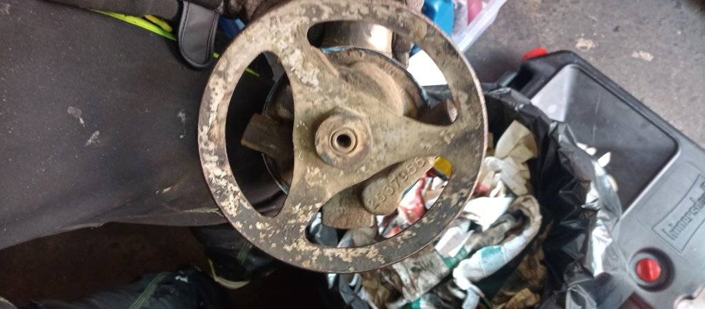

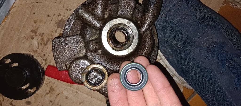

Fighting my power steering pump (Federal). Rebuild it with a 5,8 $ Kit...today in the evening i'll test if it works. Leaked quiet a bit before. But I have the impression that the shaft wheel is "floating". Maybe i need a new one...
SOMEBODY KNOW were to buy the just the wheel?

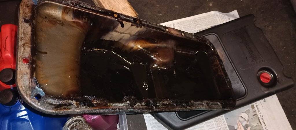

Did some more work...steering linkage (?) down, Y Pipe exhaust out, so that I could get the oil pan out to put a new seal in it. Was way more work to clean it than I thought -.- . So I ran out of time and didn't finish putting it back. But! At least there is some Chrysler blue left :)
Sorry for the bad pics...I have a cheap phone.

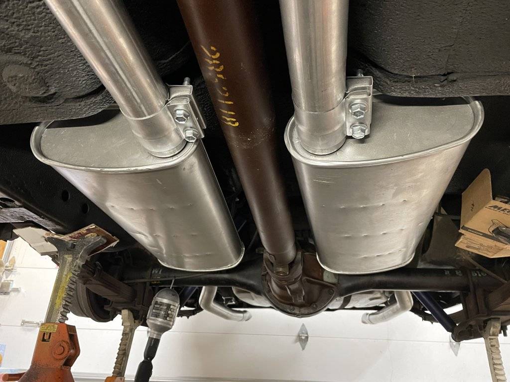

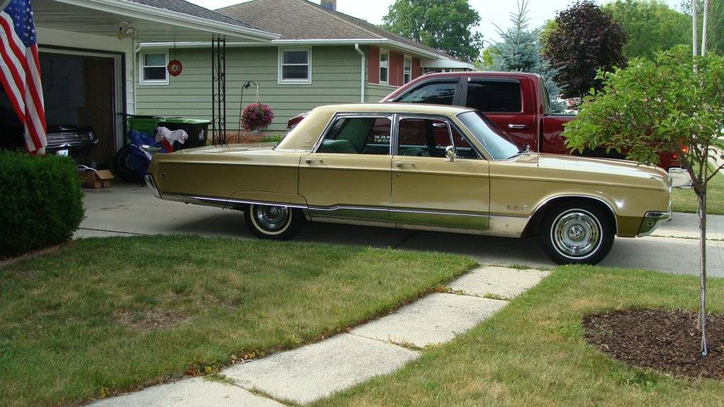

Ditch the mufflers the TTI come with. They are too loud for a NYer. Replace with Walker 18230 (OEM) or 21856 (’60’s Cadillac muffler). You won’t be sorry.
With 2.5" exhaust the tti mufflers are fine. I think they are quiet on my Polara.
@sixpkrt's New Yorker sounds great with a throaty exhaust.
