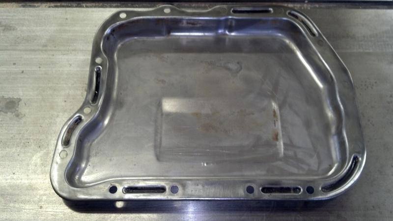

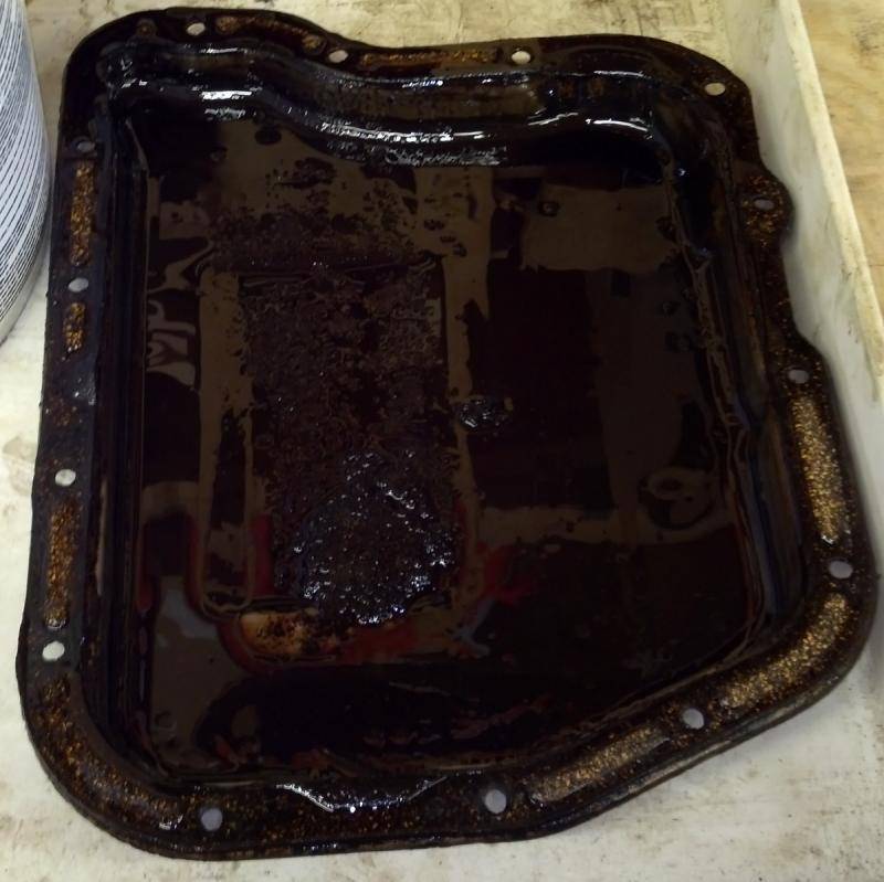

Today I finished all the greasy, under the car, and engine bay work on the 300. It doesn’t mean that other things won’t pop up, but everything on the current list is done.
My last item was changing the transmission fluid. It was a dirt job but was happy with all the old dirty fluid I was able to drain out. The old gasket was shot and I have been leaking major amounts of oil. The pan cleaned up nicely and no one ever over torqued the pan, so it mounted back perfectly and no more leaks.
I can now move on to a few of the electrical gremlins, interior and the body. I should be able to cut down on the DL and paper shop towels consumption significantly.

I got 7 quarts out of it. I was told by a local Mopar transmission expert not to flush the 727 transmission. He told me to loosen the 7/16th bolts after I took the pan off, and it work release about half of the oil in the torque converter.
He said not to flush so I took his advice. The oil looks amazingly clean after doing laps in the barn yard (roads are covered in salt).
View attachment 7338View attachment 7337
The pan cleaned up pretty nice.
