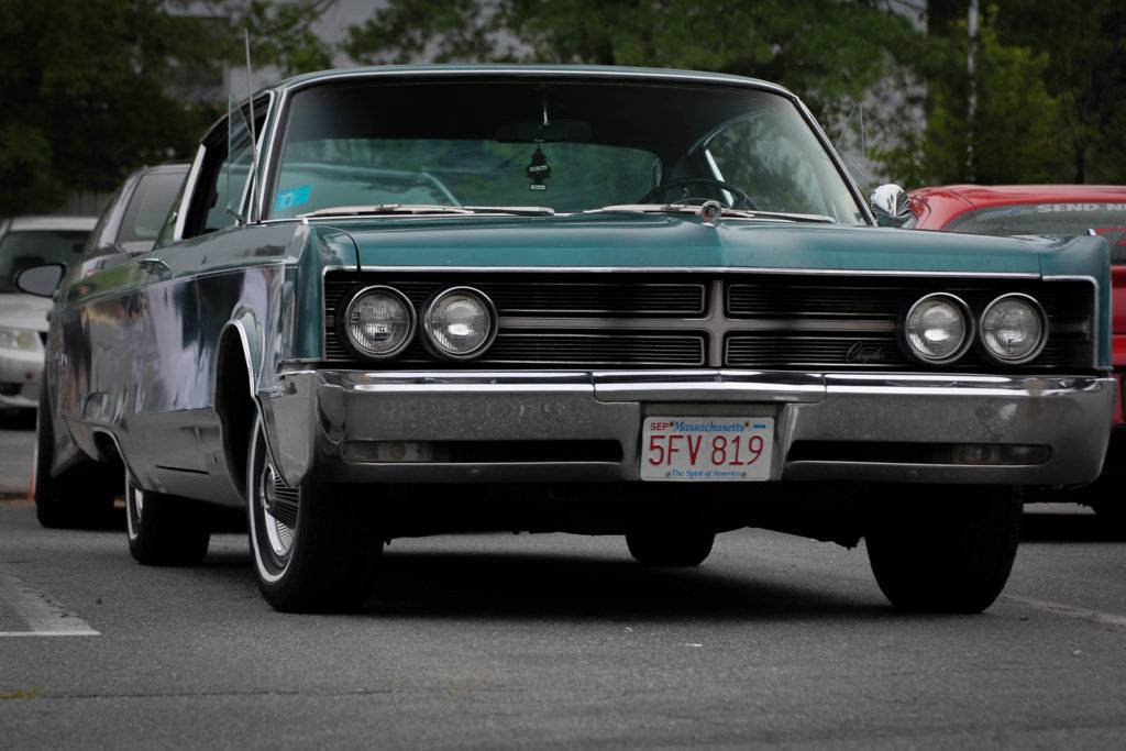

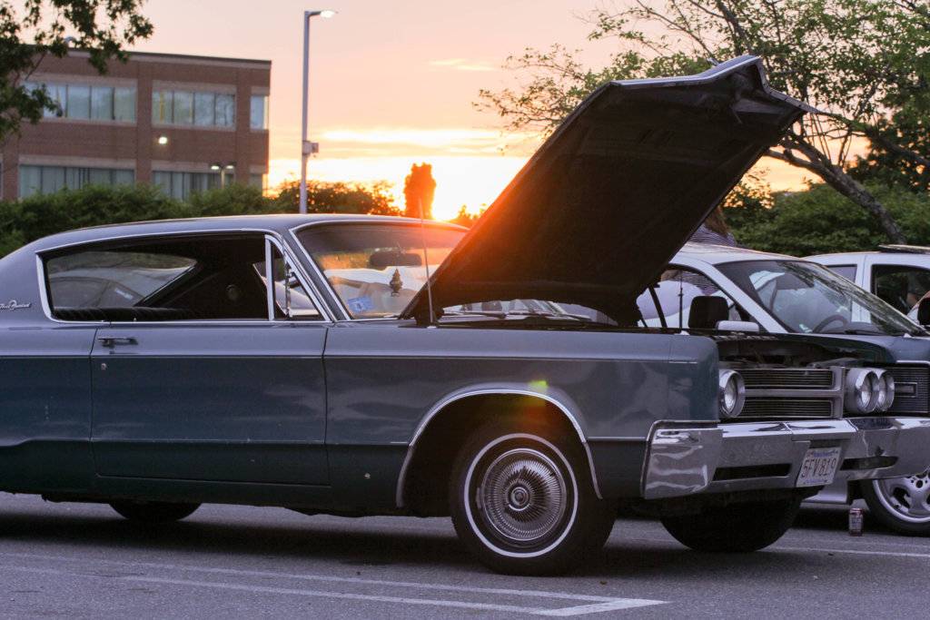

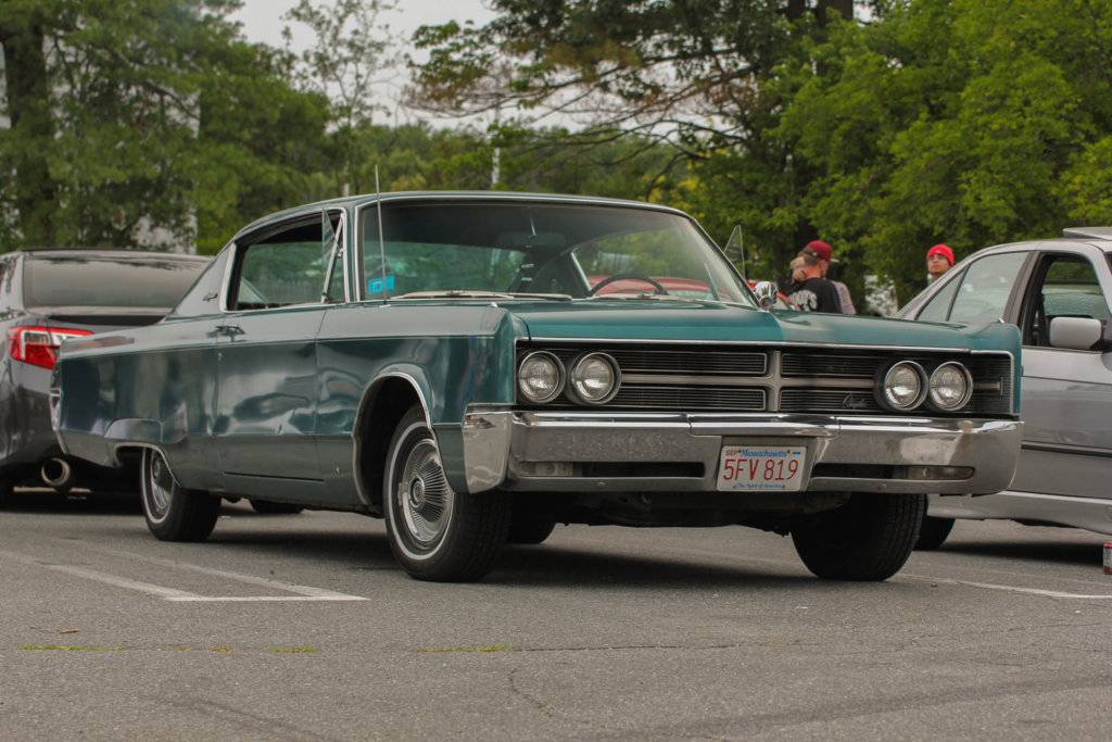

Here are some pictures of the car and how it looks now. My little brother took the pictures. He convinced me to take it to what he called a "car show." Well it was more like a car meet up of kids with imports who smoked weed in a burger king parking lot and had lowered cars on cheap rims.
But he took some decent photos so here she is.

Wow that paint even looks original.
Very nice!
Are the hubcaps correct as well?
As far as i can tell the hub caps are original. One or two of them is dented from when someone tried to pry them off back in the day. Not sure what they are made out of but its definitely metal.
