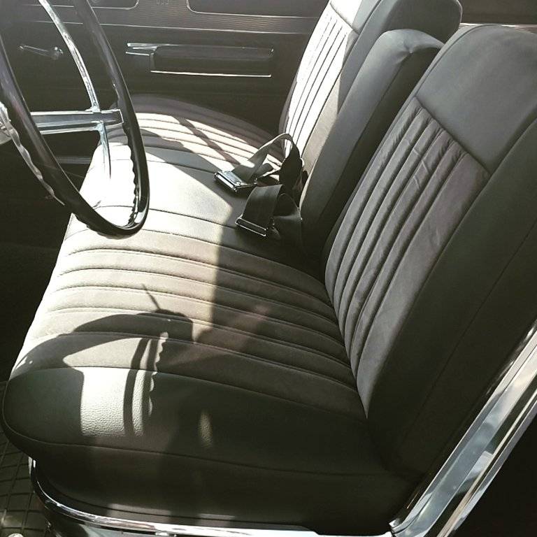

Stopped by the upholstery shop today. The seat was take completely apart, all the stitching was removed, the new vinyl and suede was cut out but not sewn to the new foam. Since there was nothing I could do I told him how i wanted it again and asked him now when it would be done. I know he is running late but me going in there guns blazing wouldn't have made anything better. Hey if it all turns out good then him running late and a simple lack of communication isn't such a big deal.
Good luck. . . And may the odds be ever in your favor. . .

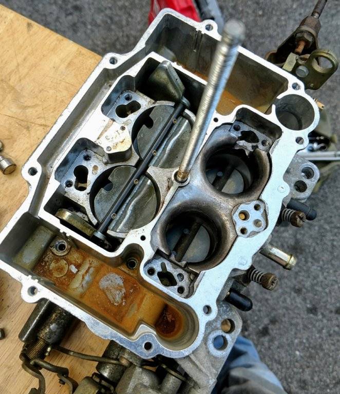

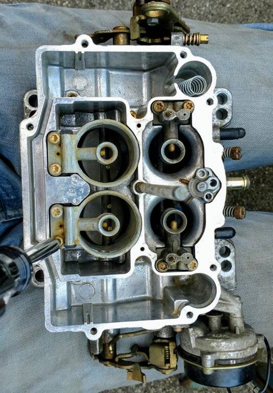

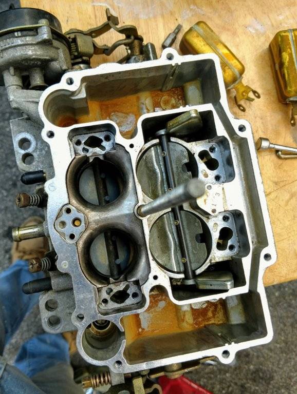

I did some work on the Chrysler today. I've been having some problems cruising over 65 with the car for the past few days on and off. Saturday was the worst and I have to limp the car home after a wedding. It felt like a fuel issue but I really wasn't to sure what it was. It drove fine below 40 but when I got on it, it just sputtered and went and sputtered and went. It felt like it wasn't getting enough fuel, like the fuel was coming out of the Jets then just stopping then pumping again. It was really weird. I wasn't sure if the fuel was boiling because the carb was hot but this is what I found when I pulled for carb apart today.
I wouldn't say I rebuilt it as much as I just gave the entire thing a good thorough cleaning and replaced the old gaskets. I also replaced the spark plugs. Everything else in the carb looked fine so I left it all alone. Oh ya and I also put a new fuel filter on. I think there may be some rust in the tank..
Then after hooking all the linkage back up and not losing any of the small clips. Double checking the spark plug boots after it didn't fire... Because two of them weren't on all the way, she fired right up. I didn't get a chance to drive her around because I had to get other stuff done but I'll report back and see if I fixed my cruising problem.
I replaced the fuel filter. The old one was filled with rust it was insane. I knew there was rust in the tank when I replaced the seal on the base of the filler neck. I looked inside then looked away. It was rusty but i didn't want to deal with it. Looks like I'll have to replace the tank unfortunately. I've done the chemical thing to remove rust before and it's such a pain in the *** I'd rather not deal with that again.

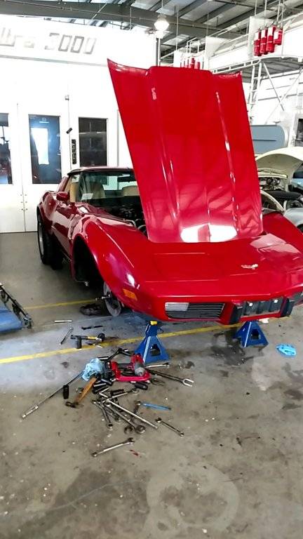

But in other news I started my job in the new shop today. Took the entire front suspension off a 79 Vette and my boss was happy which makes me happy. I showed up, unpacked my tools and got right to work. I can only work there part time because I have obligations to the military. But it's nice because everyone gets off work before 1600 and he is going to let me work later which I love because I can get more hours. I don't ***** at work but truth be told it sucked working on a car that hasn't been on the road in 20 years. Although I did enjoy it.
